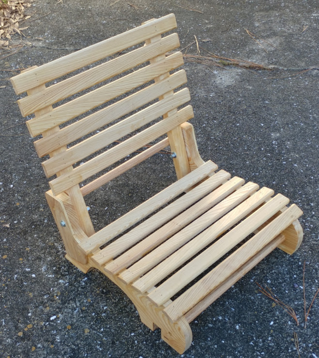

So far I built frames, stems, and seat since I had the materials for those. The seat and frames are cypress and the stems are hard maple. I had some leftover pieces that were jus the right sizes.

Nice looking seat.

Nice looking seat.
Thanks.
