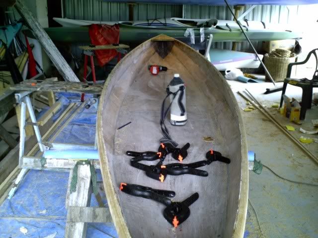

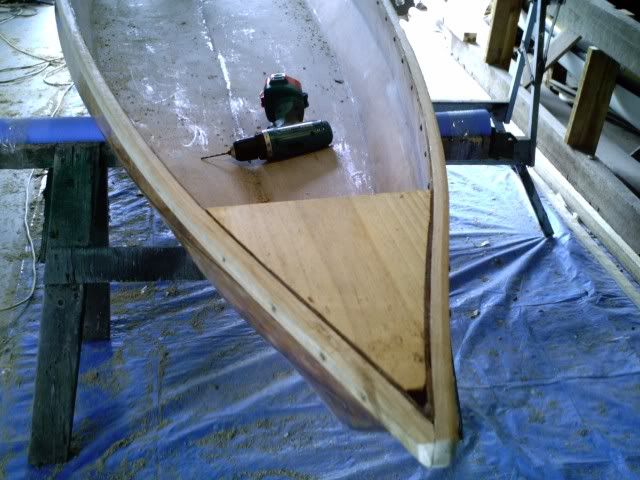

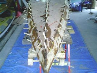

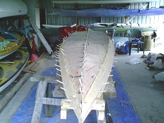

On another note, Got all the main hull panels on today and started with the epoxy and wood flour. I will email Matt some pics and he might post em for me.

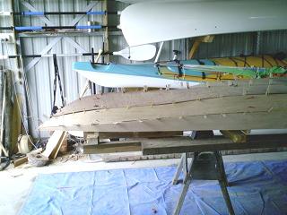

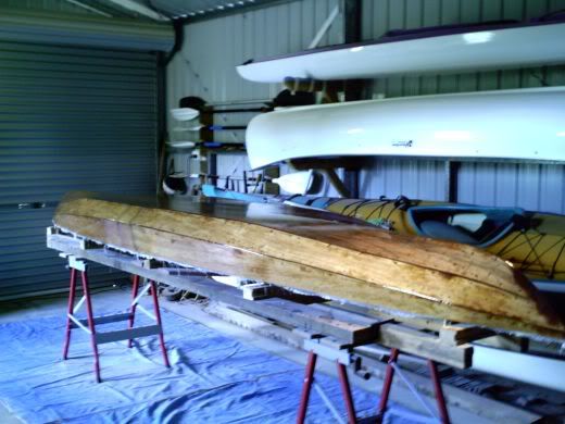

Worked on her all night in the cool. Got the outside seams all filled. A little sanding tomorrow and then hopefully, off the strong back and start on the inside. I have sent Matt a couple more piccies and he might post em here for me.
My cheap ply has turned out very well. there were no voids and the curves are all pretty consistent. My "practice boat' could well become the boat I keep.
Building this has become an all consuming passion for me and I am having a ball. I can't wait to get started on the next one.

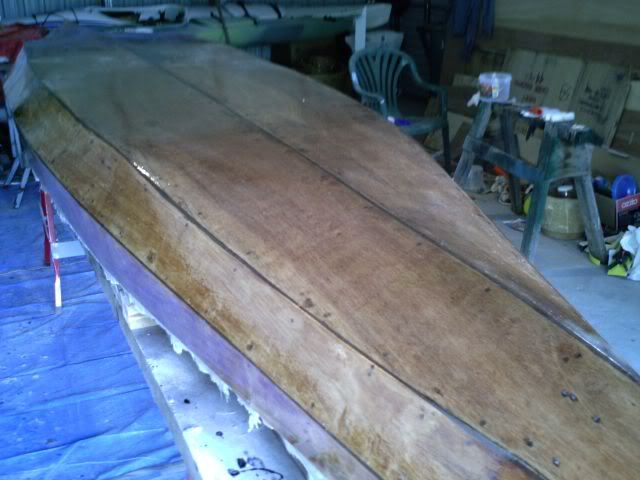

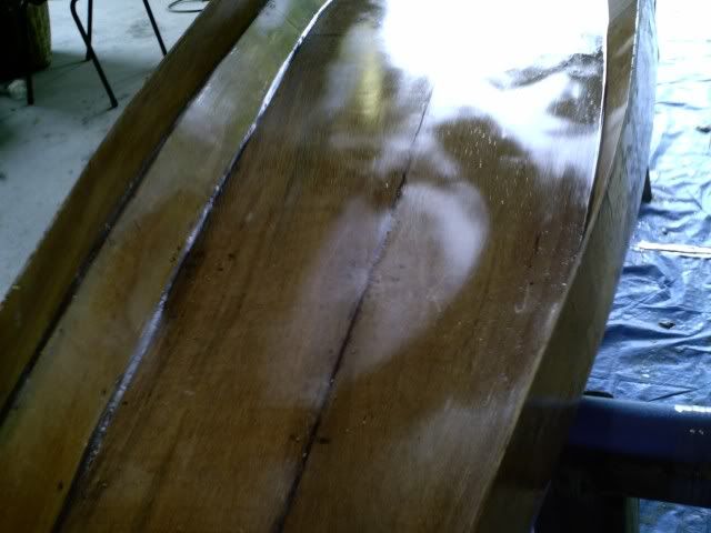

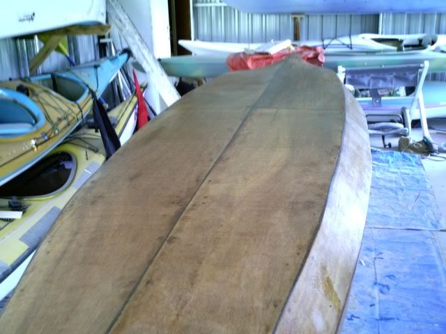

Had a bit of a set-back today. Seems I have a lot more to learn about laying up epoxy. I tried to do way too much at one time in 36 degree C heat and it went off before I could get it done.
There be a lot of sanding ahead of me now.
Nevermind, whats a few more days?
You betcha, bubbles, air pockets, mounds of resin, the whole nine yards.
Bloody heat is nothing I can do about it. except maybe move to a cooler climate. We are supposed to be in the middle of Autumn but there has been no sign of the weather cooling off.

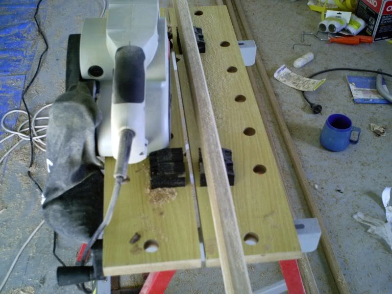

Like you, I have a Black & Decker Work Mate. I extended it some with a piece of 3/8" plywood; 1/2" would work well too. Mine is about 4' wide and 2' deep.
First, I clamped a piece of about 15" 2X4 into the bench (has to be short enough to fit in between the two jack screws) so a flat surface was flush with the top of the Work Mate. Then, I lined up one edge of the plywood with the front edge of the bench. Then I drilled holes and sunk big wood screws through the plywood into the 2X4.
The plywood extends out beyond the bench on both sides and back. You could make it asymmetrical to one side too, if needed to fit a corner of a workshop.
It clamps in or releases pretty easily so the original Work Mate is available for all uses.
