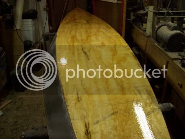

I have the last epoxy coat on the inside and outside bottom drying. Glassing the stems and attaching the breast hooks is next. A little smear of caulking to seal up the aluminum/wood joints and she should be ready. I'm guessing 22 lbs for a final weight................Crazy!
The back side of the ply is not quite as pretty as the finished side.
