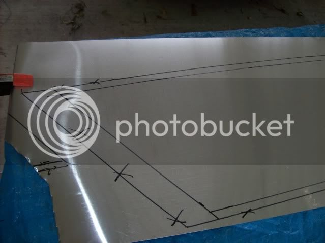

Executive decision has been made. I'll cut out and tack aluminum on the other side, bring the sides together and attach them at the stems and set the rocker. The bottom goes on next and then I'll rough up the aluminum and seal the wood/alum. joint with PL Premium Adhesive. PL seems to be proven product for small boat building on some other sites.
Started the other side. Easy ... trace around rail, mark parallel line 3/8" in from top and bottom and 1 and 1/2" in from the stems. Cut with regular scissors.......which is kinda strange.
Lotsa nailing now.
