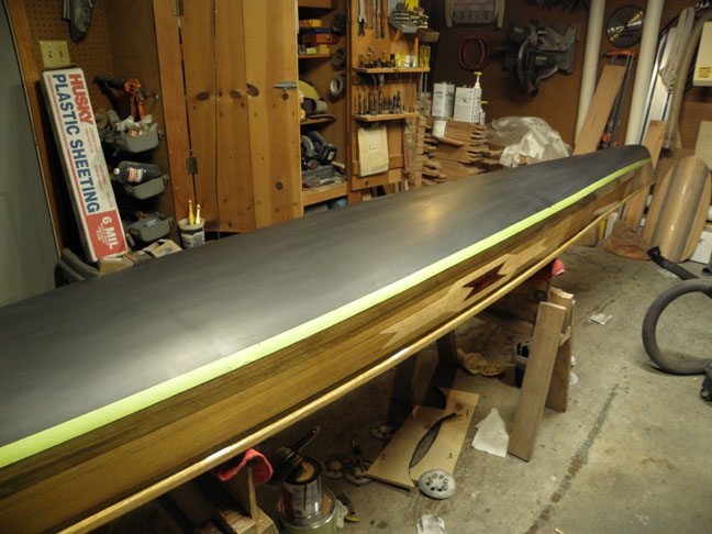

I'd avoid anything, traces of which may remain, that would interfere with a good grip by the next coat to be applied. even if it is a few years downstream before the next application. And - DO NOT use any silicone spray on the hull. These could seriously interfere with another coat adhering to your boat.
Apply a good spar varnish over it ,it should turn black,try this on a small piece first ,I am not sure all spar varnishes will do it.
Why put any ... FOREIGN SUBSTANCE ... over it that will wreck ( Defeat) what you wanted it to do ..... If anything just put another ( Light) coat of the epoxy and graphite over it to get the shine back.
Your idea of the wax would work but only for a short time since it will wear off and if some stays in spots and you wanted to re-graphite it .... it could become a nightmare for you.
If you want it ( the mix ) nice and light and uniformed then use a roller made for epoxy and move it slowly as you apply the mix... If any bubbles appear and some will then tip them out with a foam brush , dragged it very lightly and gently over the surface before it sets up.
swampwood

Graphite is finished and a 1st coat of varnish is on the bottom.
