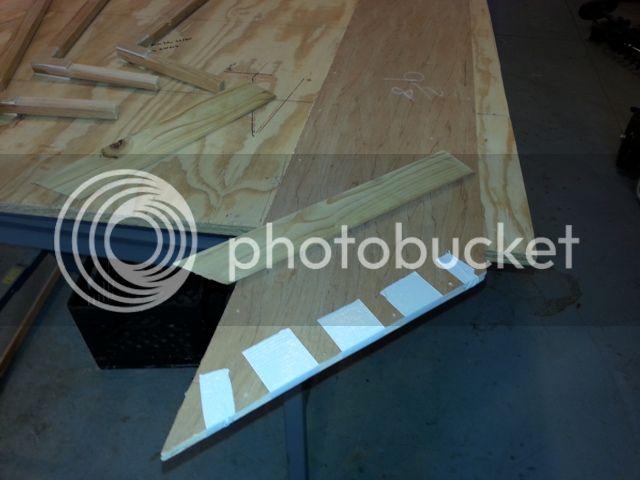

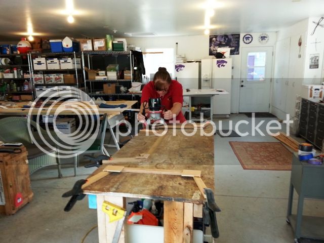

We decided the gussets on the ribs would be easier if she just glued rectangles on the joints and flush routed them.

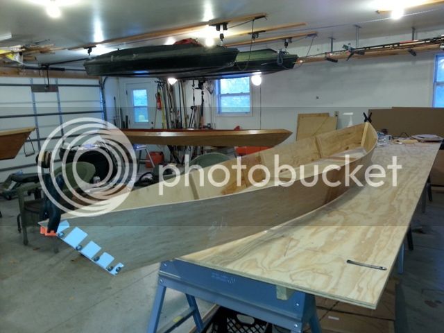

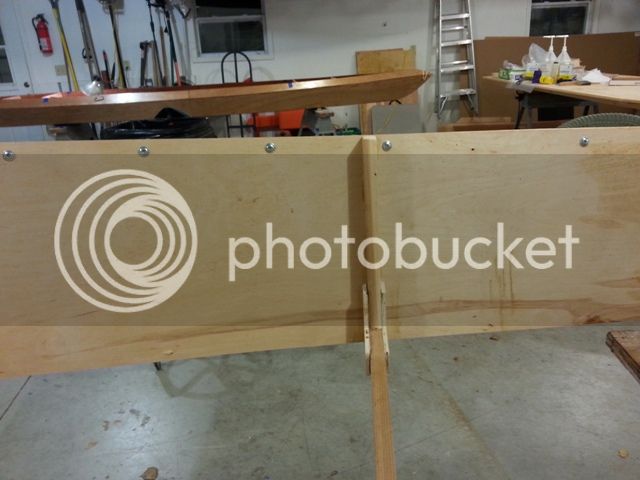

The UJ plan stem is complicated and hard to cut so she simply cut the two main angles on the table saw. Also this was about the time I had posted an end pour question and Ron replied he carved a stem and glued in place. So instead of fighting the bend to screw the sides to the stem, we duct taped the ends, glued in the ribs, then stems, using screws to temporarily hold in them in place. This was much easier than the procedure in the plans.

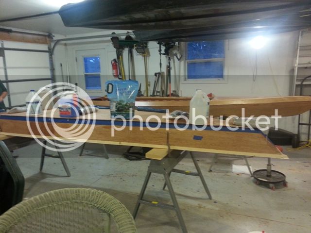

The bottom was marked and rough cut, sides masked, glued on and trimmed with the multipurpose tool.

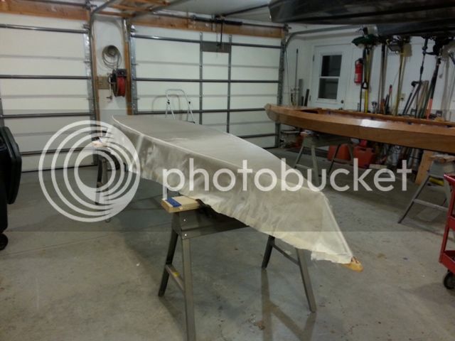

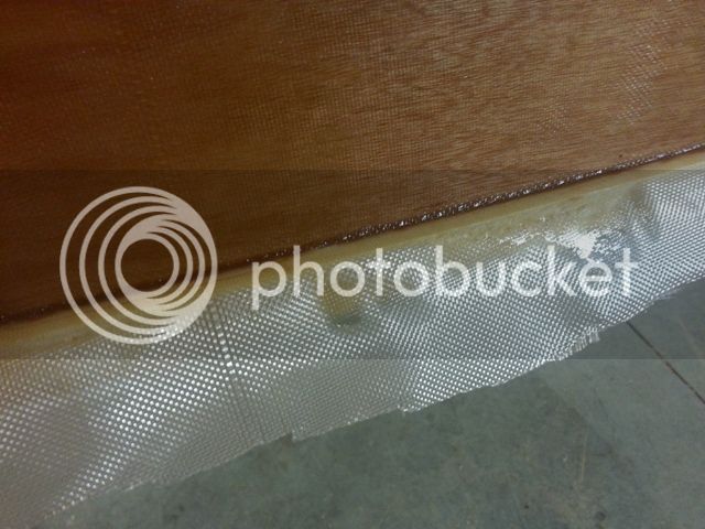

Outside is 6 oz cloth, one piece wet out with a roller and squeegee. We carried the wet glass down to the outside edge of the rub rail.
