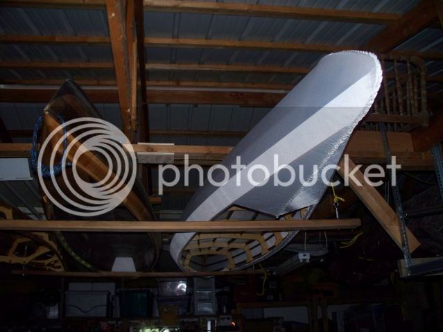

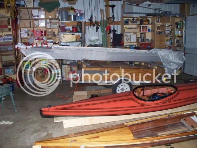

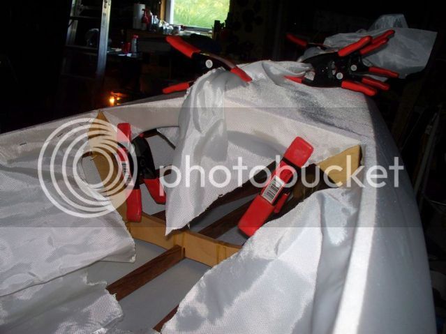

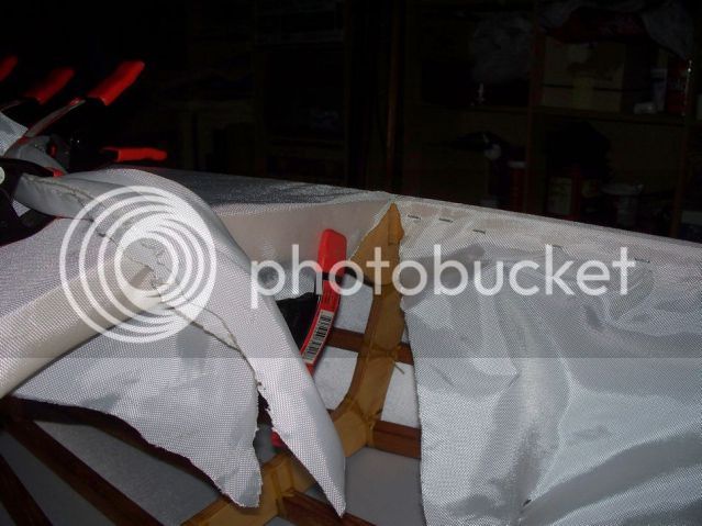

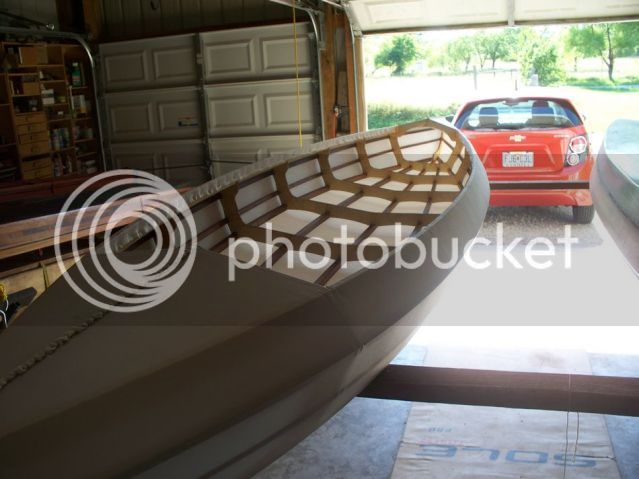

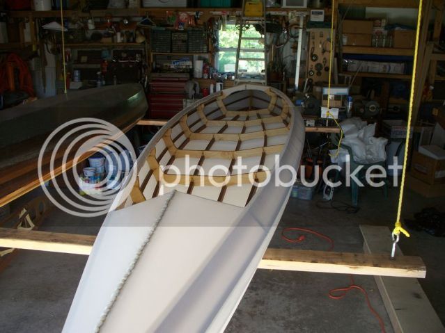

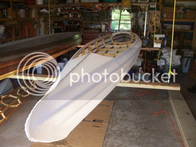

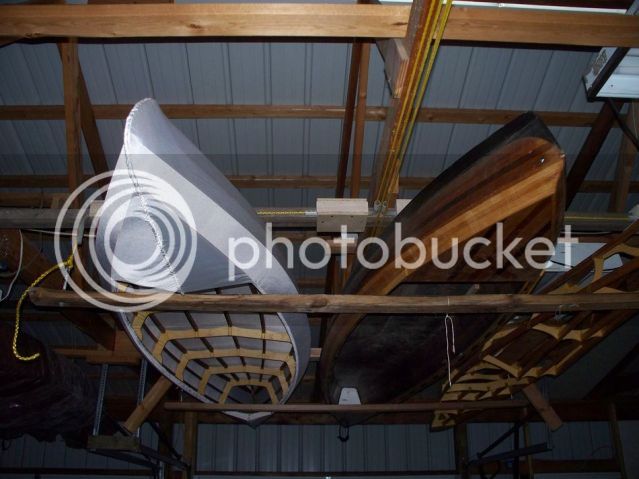

Well....Back on the Pirogue....using 8 oz. pollester to cover it...I clamped the fabric on each end and the gunwalls then fliped it over....
I started at the center stapeling and pulling the fabric toward each end....untill I got to the end where the deck starts..
The fabric need's ironed to take out any wrinkles and then paint...Stuck it back in the rack next to the TV 29

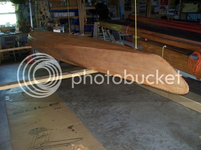

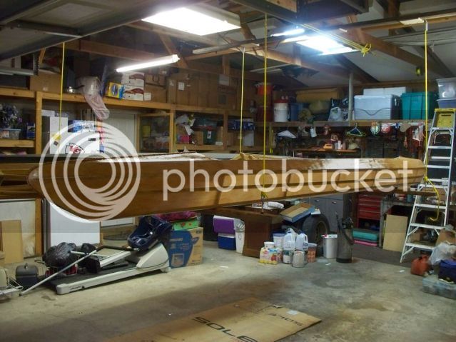

The average Joe cant even tell my latest kayak is covered with skin..I have to point it out to them......So I figured on a more rustic-see-through type finnish,,,,,
I got to get rid of a couple of boats...2 hanging above the trailer (one is the canoe being raffled off in Aug.) that will help.. :D

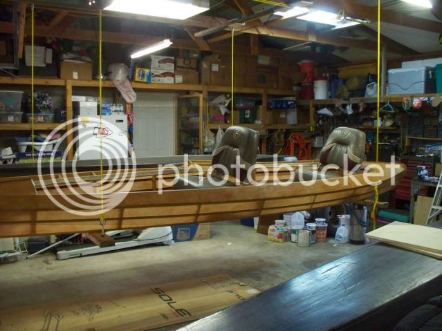

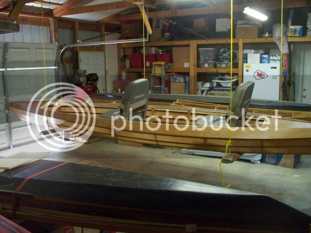

I should have posted pics. with the seats....
It has been on the water... with one person in the back weighing 200 and one up front at 145lbs...and it worked just fine didn't have a camera at the time...
