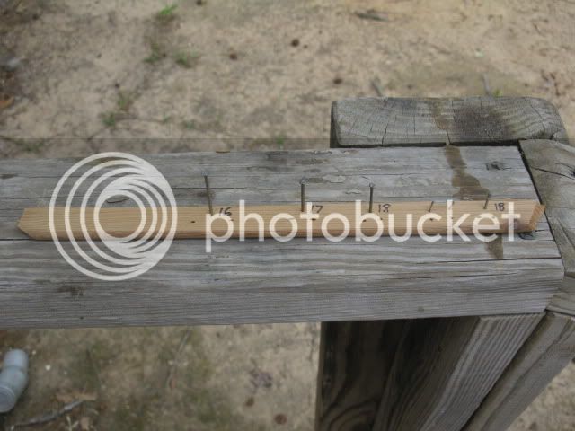

OK ,I did.

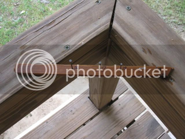

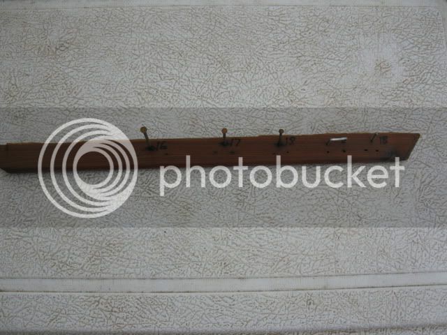

1. A brad, a staple, and 3 size nails

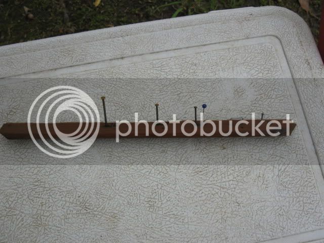

2. Soaked the wood for30 min.
3. After 2hrs.
4.Soaked overnight
5. Dried 24hrs. + and sanded 220 grit

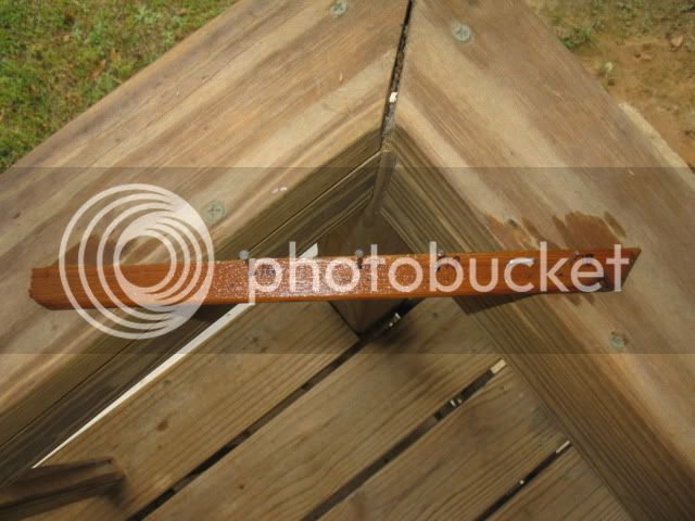

6. Two coats of epoxy.
7. Holes not closed after soaking

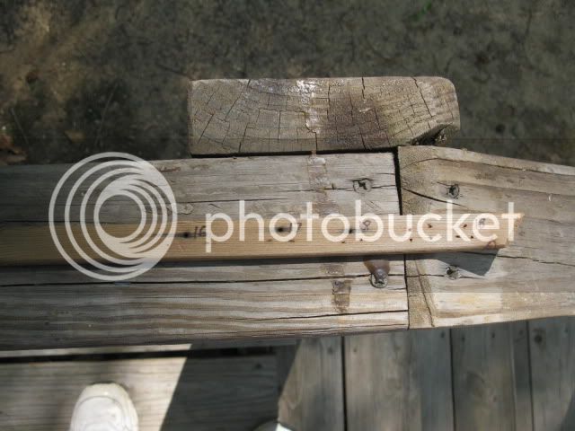

Turning into too much typing. Metered a strip = 5% moisture, soaked overnight = 16%, dried 24hrs. = 5%
Soaking the strips raises the fibers on the surface partially concealing the holes. The holes did not close competly. Some of the raised fibers were sanded away exposing the hole agin. The saturation coat of epoxy applied to nonwetted strips did as good a job disguising the hole as soaking did. Bottom board in picture # 6 is the epoxy only.
It apears the wetting leaves no extra moisture wth proper drying and that while not harmfull wetting may be unnecesary. The epoxy seemed to disguised the holes just as well.

Please look at picture #1. There are two holes below each nail. These were the test holes. I left the nail to show the size of the holes.

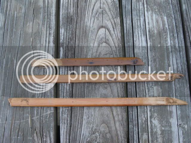

The holes were less visable when the wood was wet, but after drying and a light sanding not so hidden. Picture #5.

1.I was concerned the wood would retain moisture. It did not. The meter indicated it returned to the same level. Without a meter I don't know how you would know how long to dry. I left the strip outside for 2 days in the sunshine but cool weather 72 to 78 degrees.
2.Wetting would raise the grain and fibers. This would hide the holes, and allow for a smother finish after sanding the raised fibers(wiskers). Wetting the wood with water does raise the wiskers so the sanding can remove them. This gives the wood a smooth finish, but it also removed some of the fibers that covered the holes.
3.Soak the wood and the holes will close and not open agin. The holes never closed completly. They were tighter while wet and may have not returned to their original diameter, but they are still there. The broken fibers don't grow back together.
I have not built a strip boat useing nails to hold the strips in place. I used the "stapleless" method. It did not seem like more work to me. I had no nails to remove or try to hide. If the builder is satisfied with the holes and considers the "stapleless" method not worth the effort, that is fine. Every boat is a compromise.
A side note to this was the epoxy applied to a dry strip did a good job of disguising the holes. This could eliminate the step of soaking. The builder would have to decide.
