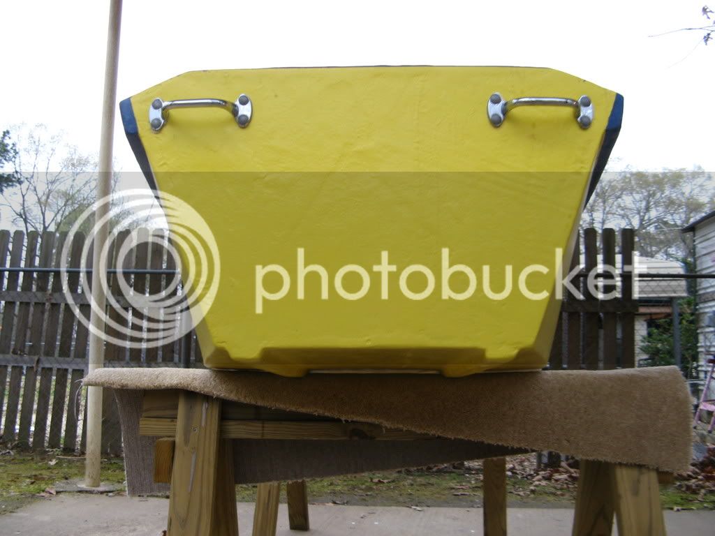

I have trouble keeping my boat in position to fish from. The slightest wind will move it. It has two keel strips 12" apart. I believe they are ineffective because I filleted and glassed over them.
Would adding another strip over these help? I was thinking (usually wrong or dangerous) one 3/4" thick with square sides, not glassed might work. Do keel strips really help with this problem?
How could these be attached temporarily? Could I put screws and just repair the holes with epoxy, if I choose not to leave the strips on? If they help and they are to be permanent, should they be glued?

Having those two strips painted and glassed will do nothing but help to protect them from wear and tear. They will do the job they were intended to do and that is to offer more resistance to the bottom of the boat and help it remain on track when in the water. Plus they also add more strength to the bottom of the boat.
Normally I like to call them a sacrificial strip since they are there to be sacrificed to wear and tear to save the bottom of the boat from that damage. They are normally attached with screws from the inside out so they can be replaced at a later date. They can be epoxied and glassed but it just makes more work when replacing them. It's the builders option on how they do it. I have seen them done all sorts of ways. :wink:
As with anything the bigger they are the more resistance they will have in the water , example..... A sail boat with a large keel will not be blown sideways as easy as a boat without one. Resistance is the key word. On the other hand the more you have sticking off the bottom of the boat the more water it will need to float and maneuver in. That's one reason like like a flat bottom with nothing attached to it.
As far as the wind moving the boat , Yep , that is going to happen anytime it is on the water and a wind is blowing. The trick is using it for your benefit and not against it , drift fishing. One good way to do it is to have the wind to your back and drop a chunk of chain ( attached to a rope ) off the boat to drag behind it to slow down the process of moving or just anchor. The major problem is getting the wind to cooperate since it always seams to be blowing head on with me , no matter which way I am facing. :roll:

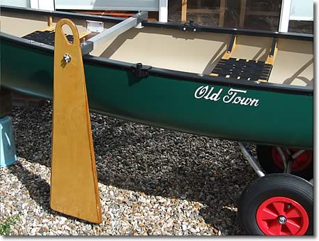

Hello, Jem
1. What size is the cross beam you used for the leeboard & how did you attach the leeboard to the cross beam?
2.How did you clamp it to your gunwales
3.Did it move around after while or did the clamps hold it in place pretty well?
4. I notice you have plastic oar lock sockets on the canoe , did the hold up to rowing?
Thanks
Carl
