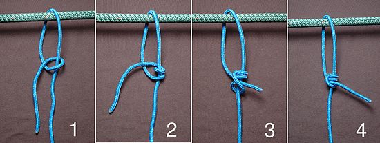

Based on Rolling hitch #1734, this version is the one most often seen named Taut-line hitch, commonly in non-nautical sources. It is the method currently taught by the Boy Scouts of America.
Borrowed this picture from .... wikipedia/
1. Pass the working end around the anchor object. Bring it back alongside of the standing part and make a half-hitch around the standing part.
2. Continue with another wrap inside the loop, effectively making a round turn around the standing part.
3. Complete with a half-hitch outside the loop, made in the same direction as the first two wraps, as for a clove hitch.
4. Dress by snugging the hitch firmly around the standing part. Load slowly and adjust as necessary.

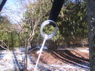

Now to complete the no energy package for the hammock...... Hammocks do make you relaxed , ya know. The tree huggers with a couple of rings on the line from the hammock. Toss the tree hugger around the tree bring it to a set of double rings on the hammocks line , pass the tree hugger under the rings then over the top one , then back under the two of them and above the webbing coming in , now back towards the tree. Just like those old belt buckles that were a hit in the 50's every hippy had to have.
Photo from http://www.tothewoods.net/HomemadeGearR ( Hammock Section )
Need to adjust the hammock , just slide the rings where it is right and cinch them down with a slight pull. In the morning , give the tag end a tug and the whole mess comes loose. 1/12 inch rings with a 1 1/2 inch webbing ... :D
This way the hammock goes up in a flash , stays up , is easily adjusted and comes down in the morning without any problems or time wasting effort.
