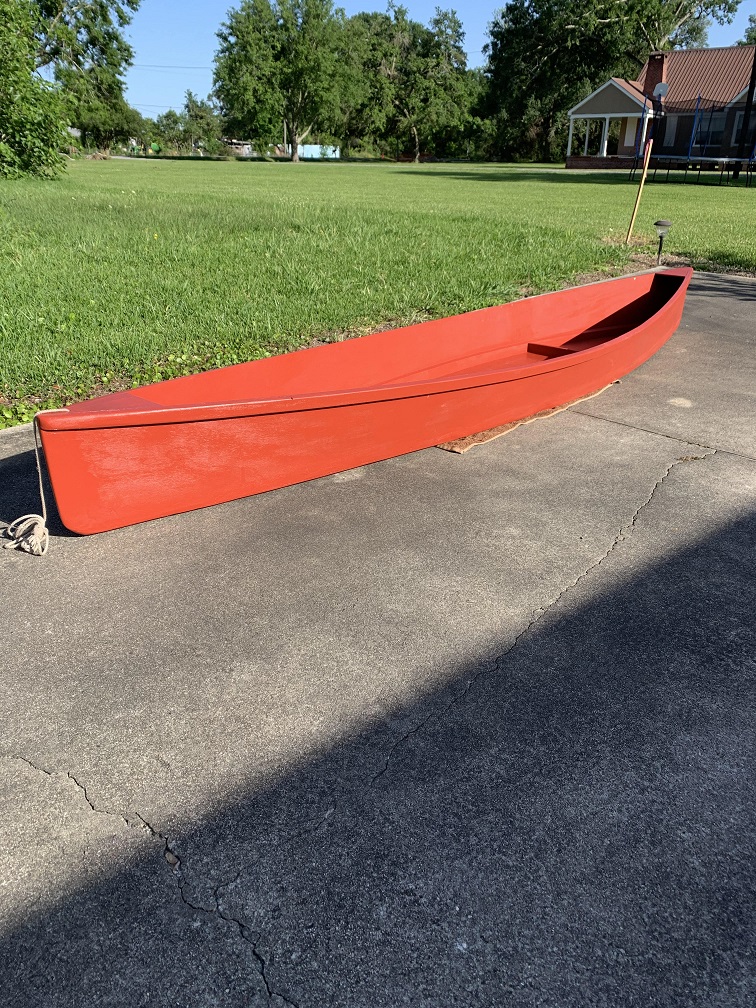

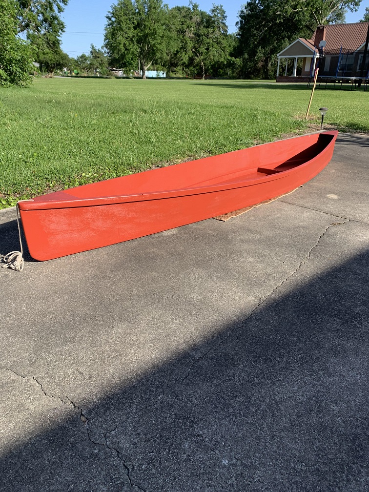

She's officially finished. Two coats inside and out with a semi-gloss latex paint.
Final specs: length- 11'8" ..............................

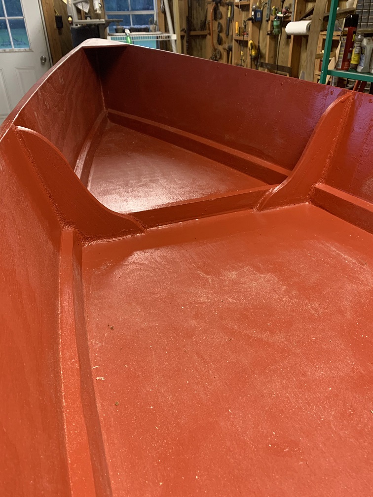

The flair relaxed a bit after taking off the form. No problem. I put one floor rib over the bottom butt joint. That stiffened the floor and, surprisingly the sides too.
Now, two days or so of waiting for the paint to cure. View attachment 1633
Is the floor "rib"/brace 8' from the bow? Where did you sit in relation to it?
2,290
38
Yes, the rib is 8 feet from the bow. I should have put a couple of side ribs there too. I sat about a foot forward of the rib and a foot behind center. I'll glue the floor rib and the side ribs in maybe tomorrow. One step forward and two steps back. Fun stuff!!
2,290
38
The bottom rib is reattached and the side ribs are in....... 2 feet behind center. I'm thinking that should be strong enough. We'll see. No big thing to add another rib if needed. Probably needed more sanding but just didn't want to spend an extra hour. As I age, the need for impeccable fit and finish escapes me. The juice is just not worth the squeeze.
