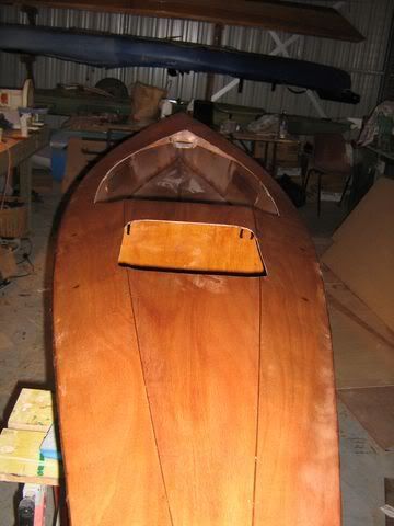

I like your glove box there, Mick. I had the impression you were going to install two of them side by side. Are the circles on the under side of the decks anchor points for bungee/straps to hold on hatch covers? Keep'em tight; losing hatches is part of what happened tot he Edmund Fitzgerald.
G'day Jack, Thanks mate.
I did make two of them, but the other one is for my boat. :p
The circles are 2 inch discs of 4mm ply that I cut with a hole saw. They are the mounting points for the foredeck bungees. The ones near the hatch of just in case I ever decide to make a hatch lid. Our lakes are all small and the rivers & creeks here, are even smaller.
They were much easier to install with the deck off - is all.
99 percent of Robin's paddling will be done in calm, flat water. They hatch is a very neat fit for a small plastic tub that is readily available here. I will be putting a 3/4" coaming round the lip and the tub will fit very neatly into the hole. The little tub, is just another place for Robin to put her sunscreen, water bottle, snacks etc. while paddling and she will be able to access it while still in the cockpit. :D

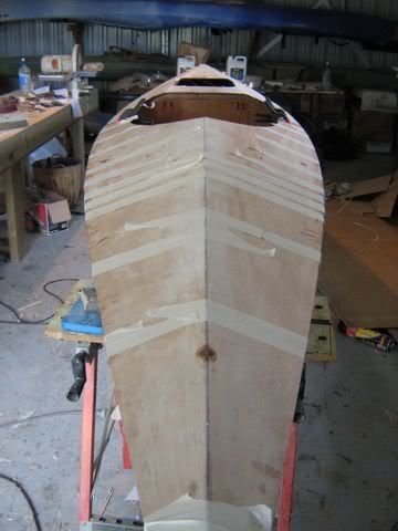

I got the decks on this morning :D

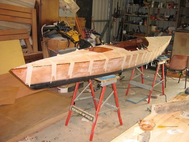

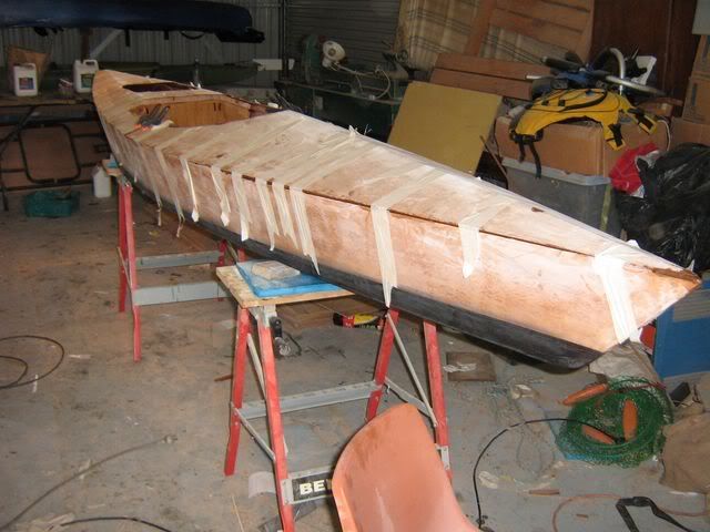

External deck to side fillets are done.
I stand the boat on it side and do one side at a time. Allows for easier working.

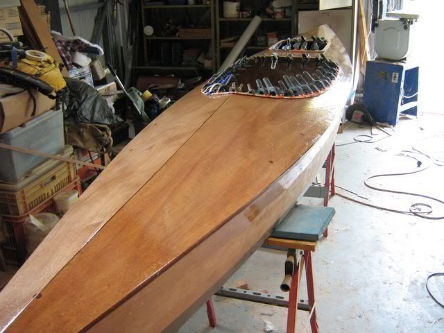

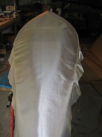

Deck saturation coats are on. Today, we fibreglass.
Looking good, Mick. As one of my friends says "That thing is slicker than snot on a doorknob!". Very streamlined.

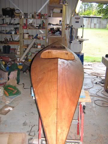

Mick, you think that front deck would be strong enough to be able to get out over the bow?
Later Joey
G'day Joey,
Thanks mate. :D this is my best build to date., as far as workmanship goes. I am real pleased with the way it is coming together.
Mate, I am not sure what exactly you mean. Is it strong enough to stand on the front deck? probably not.
Is it strong enough to climb all over it while in the water? certainly.
Would the deck support 2oo pounds on land ? I don't know and hope to never find out.
The deck is a solid as any kayak I have seen. It is re-inforced from underneath with a solid fillet down the seam, further re-inforced with fibreglass cloth and epoxy on both sides. and the whole lot is supported with a cross brace on edge and generous sheer clamps and wood flour fillets.We tie out kayaks on to the roofracks - upside down so the boat is sitting on the apex of the deck. They are tied down TIGHT and there is no flex in the deck that I can see.

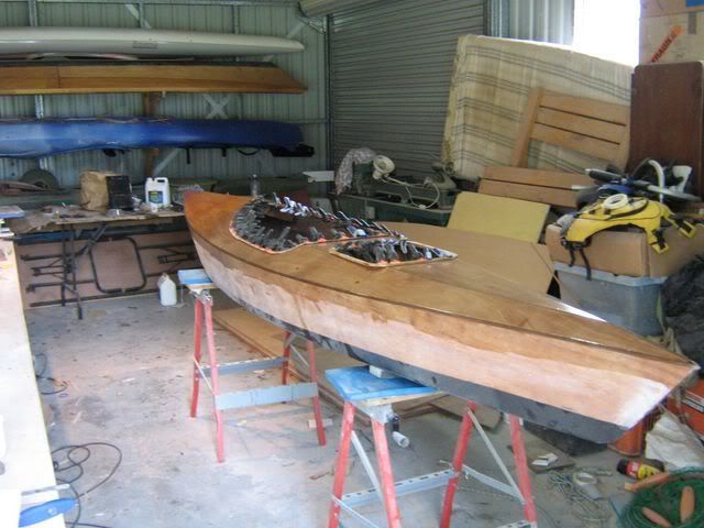

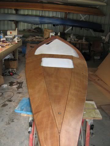

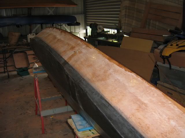

Bit more done today,
first wet out coat.
2nd or fill coat and first layer of coamings on.
