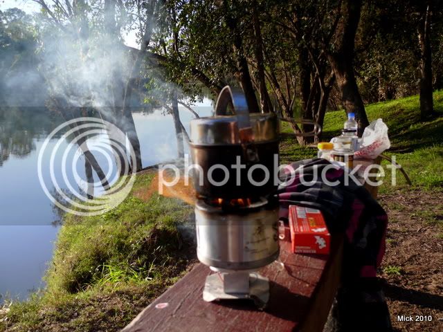

I made a similar stove to the Nimblewillnomad but used titanium sheet and it weighs less than 4 ozs
and hopefully seen here -
http://my.opera.com/Manjimike/albums/sh ... re=5704919
I also use propane after getting rid of my Coleman dual fuel - I could never get it to simmer, now my Kovea Ti (click on Previous in the above link) will last me 11days on a 220 gm cylinder

ManjiMike, I've always liked the basic design of a NimbleWill stove, but thought it needed to be taller, and maybe a bit shorter? Height will give a chimney effect for updraft (draught for you?), and thus a hotter fire. What are your thoughts on that?

What you say makes sense, but as I only boil water, which might take 5 mins instead of 3-4 mins on the propane it doesn't worry me. I have put plenty of holes in for the fire to draw.
It is normally only my backup stove, but as you can see from the photos I can invert it and use hexamine tablets or leave the floor out and use it as a back-up windsheild for the propane stove
