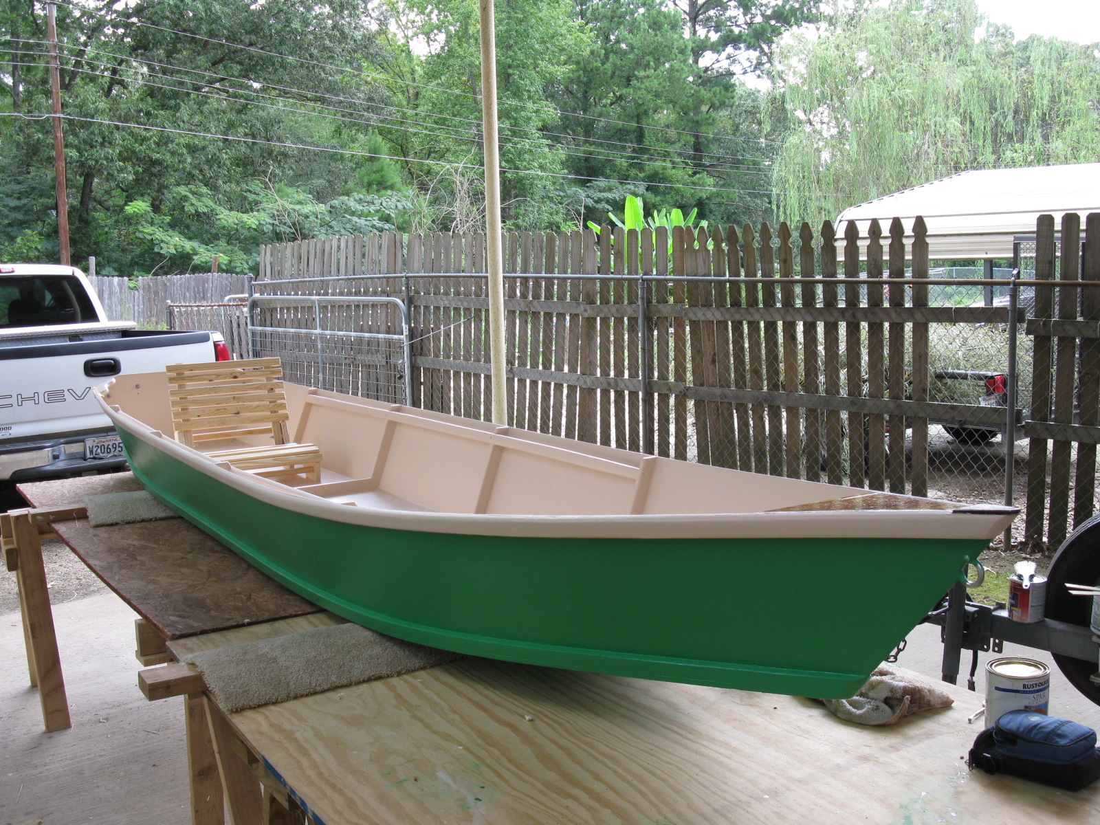

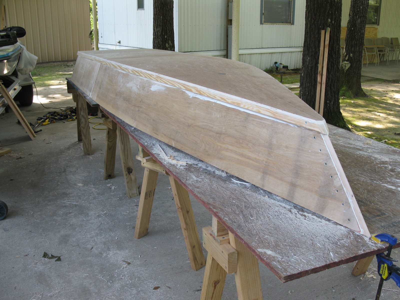

The "Firewood" skiff I built had outside chines. Not sure if they had the plow point Joey mentioned. The boat paddled well enough for what it was. I never thought the chine logs caused any significant issues for a fishing boat.
Since you are planning on using a troll motor they won't be an issue.
View attachment 1524View attachment 1526
Man, that is a beautiful boat! Is that latex paint that you used? I still have a ways to go before I have to make a decision, but I leaning towards acrylic latex currently.

It has been some time since I painted that boat but I usually use latex exterior or porch paint.
