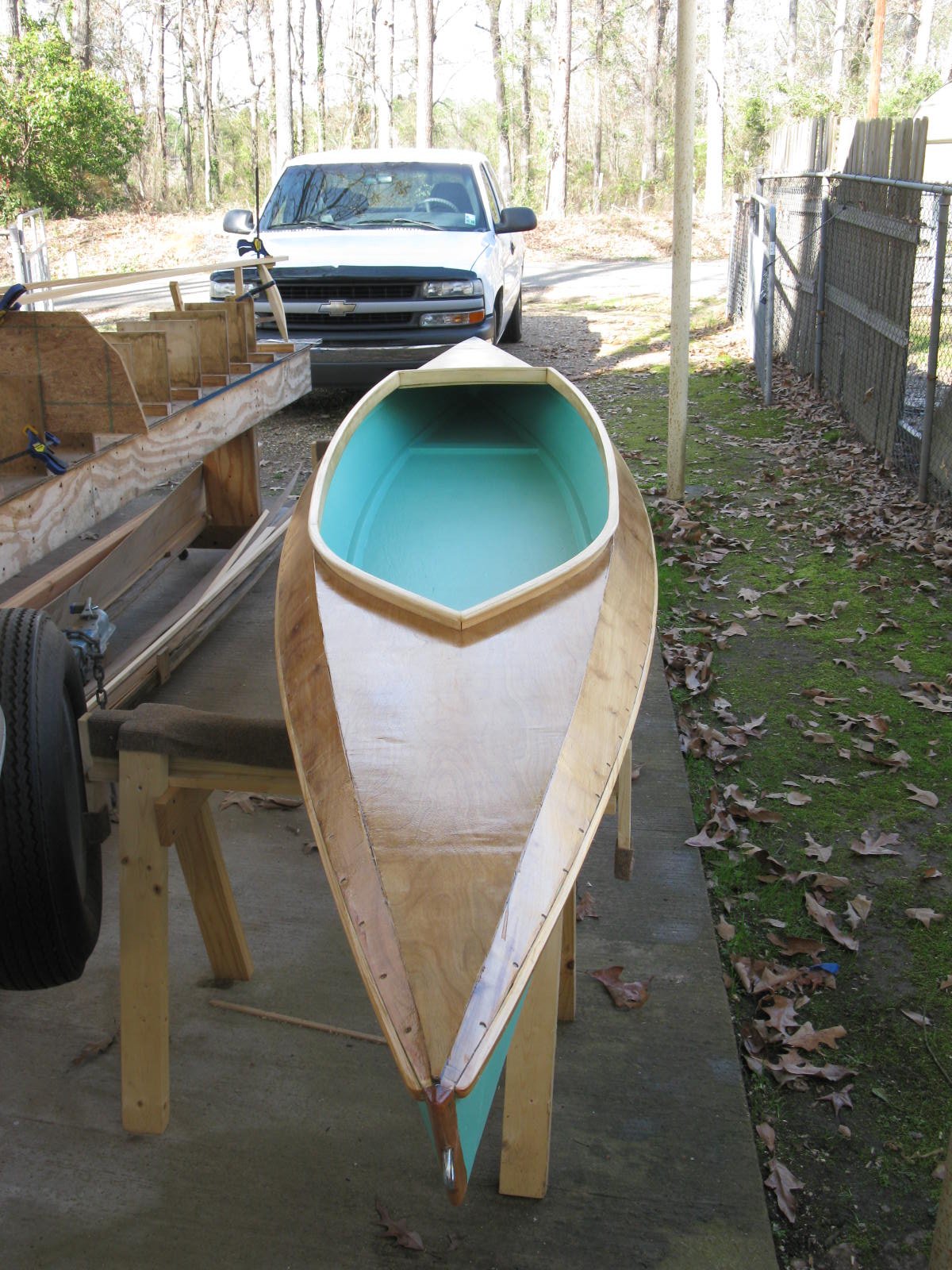

If I do another pirogue, I'm leaning towards an Uncle John-type design using epoxy and maybe just taped seams. I'll change the basic design to a more curved kayak-style bow and a more upright stern. I guess it would be considered an undecked kayak.

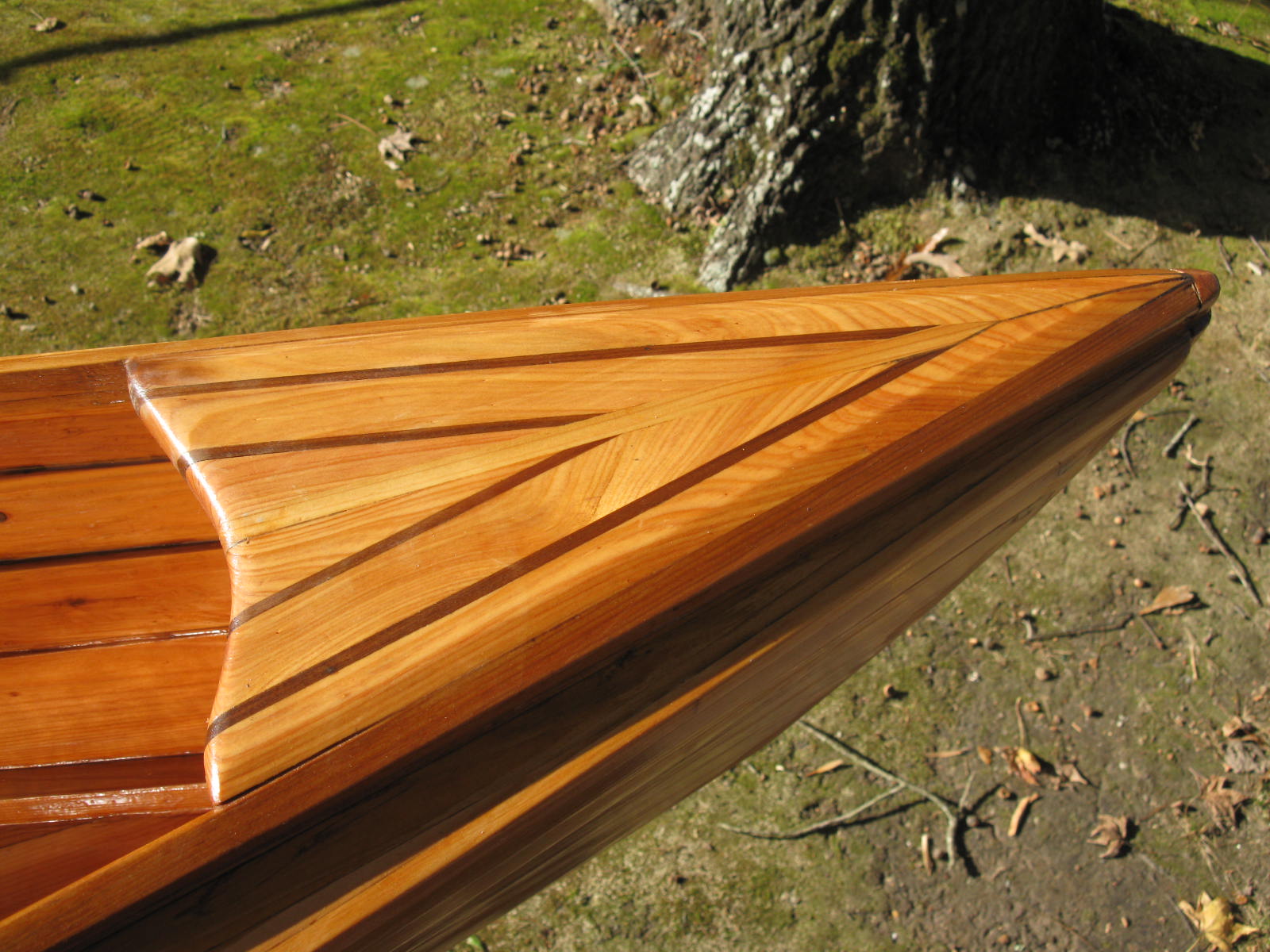

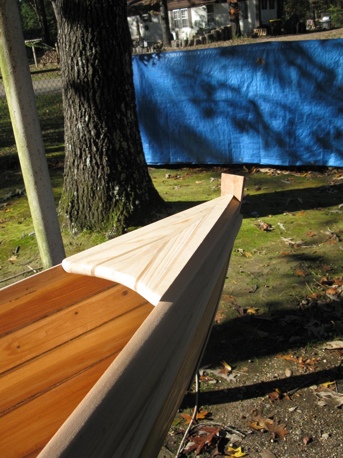

Not related to the rocker issue but Joey and I talked about the build and discussed tumblehome sides and how they laid flat (almost) at the stems. If the sides were vertical at the stems and if the tumblehome panel was at a 90 deg. angle to the sides it would be flat at the stems. The sides are not completely vertical where it meets the stems and the tumblehome panels can be attached at an angle more than 90 deg. When the bresthook or decking is installed they follow the sheer line and are flat across.
If you choose to install the deck or breasthook and stop the tumblehome panel short of or at the breasthook/deck
they will have an upturned look and will not present a fair sheer line unless the sides are "bobed" off level at the stems.

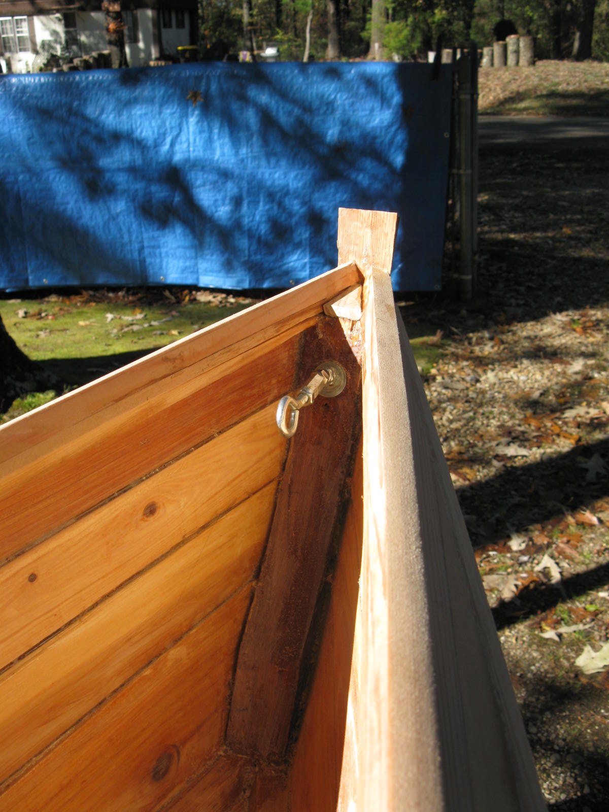

The eye bolt is for attaching my bow rope while fishing. I don't like it hanging outside the boat and possibly hanging on a limb or something. Worse would to loose a fish because of a tangle. I tie my tackle bag to the rope in case of a spill. It is also handy for pulling oneself up from the seat if needed.
