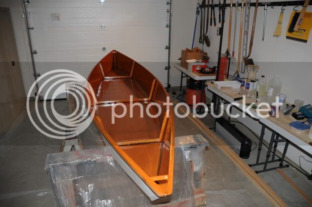

I saturated the inside yesterday, didn't turn out too bad:
Notice shop is getting to be more of a mess.
