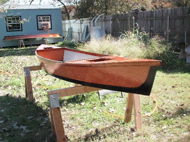

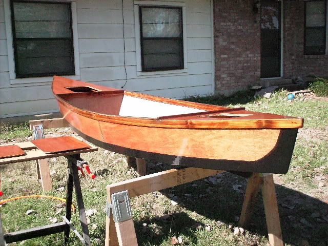

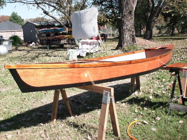

Re: New Boat For My Brother-10/24 WOOD WORK IS DONE

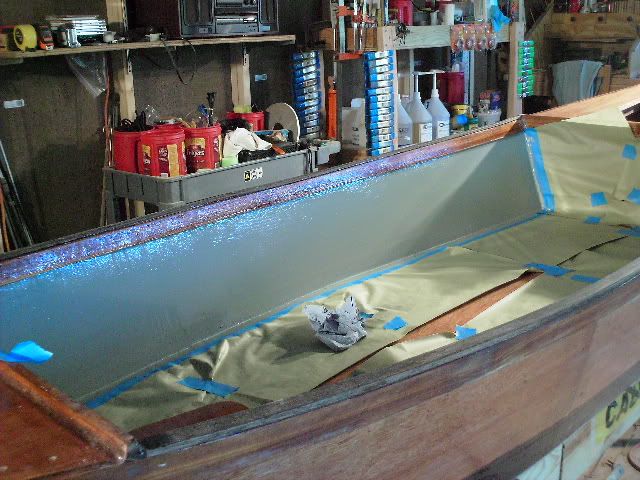

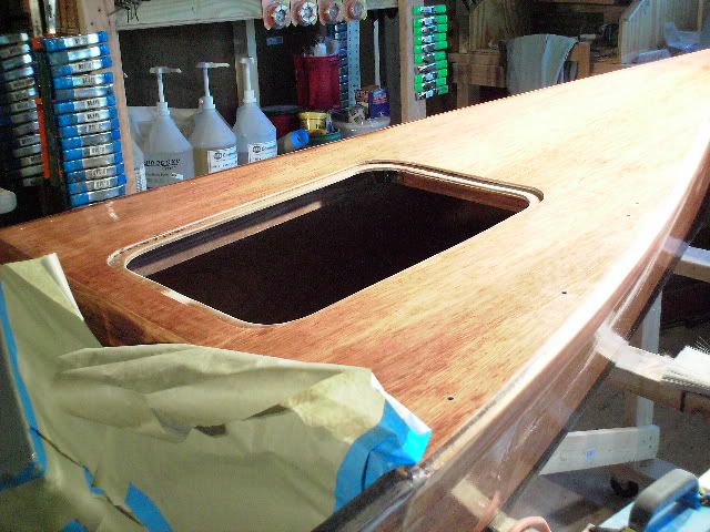

My problem with the resin not curing must have been another "fogger" incident. The stuff just wouldn't harden after a week of waiting. So a little elbow grease, vinegar, and acetone and off with the old and on with the new. Now I'm back on track and the fiberglass is set and sanded with #1 steel wool and ready for varnish. Waiting now for the gray inside walls to dry for a second coat.

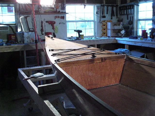

The Red Oak for the top of the gunnels is in place and I also decided to stain the top rail even darker to match the fillets. That stuff is hard as iron and really difficult to bend.
All the rigging has been pre-fitted and holes drilled so I don't have to take a chance with a fresh varnish finish.

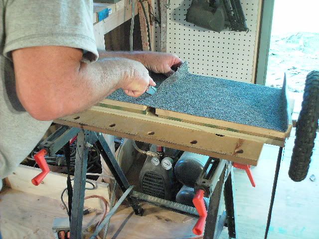

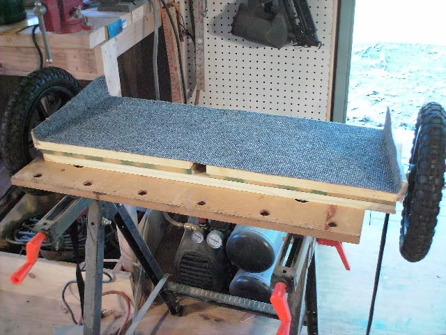

The Trolley is complete and ready to go, the seat is complete and only waiting for me to float this thing and get the center so I can place the seat. I even got TCF a pretty black crate to go behind his seat and a new (homemade of course) black mesh fish basket to hold all those Crappies (did I spell that right????).

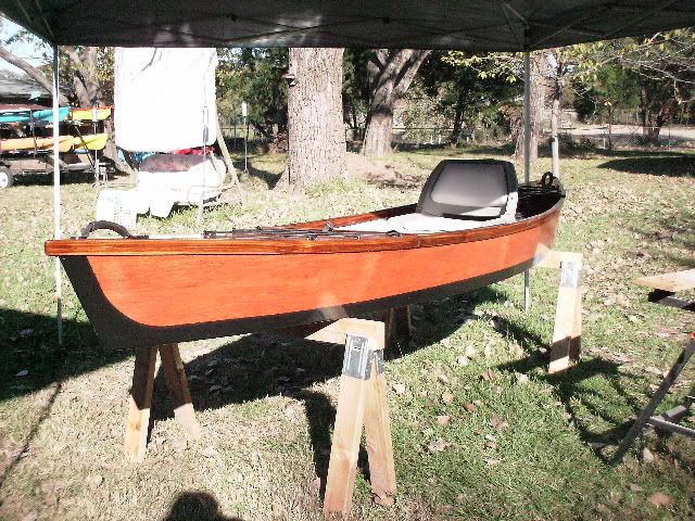

Re: New Boat For My Brother-TIME FOR VARNISH

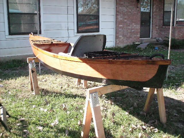

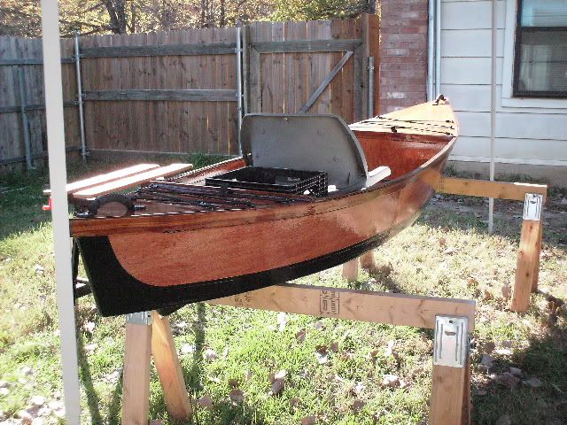

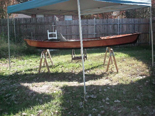

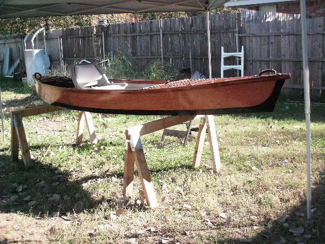

Well, that's about it. Got the last coat on and the rigging on. Found 2 puddled spots that I will have to repair after she cures real good. New spray gun got ahead of me if you know what I mean. If the Lord is willing I will float her Monday or Tuesday and mount the seat and install the foot braces. After that she is a fishin machine. I was just noticing the Bumble Bee Yesterday and the B is kinda beat up . . . and I felt a little proud. She has slaughtered a lot of fish over the past year.
I really like the pic below . . . it shows her rocker and shape.

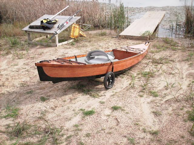

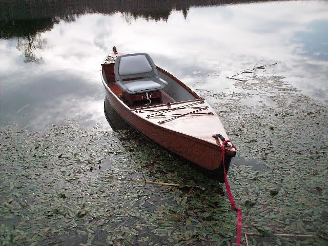

Re: New Boat For My Brother-TIME FOR FLOATIN

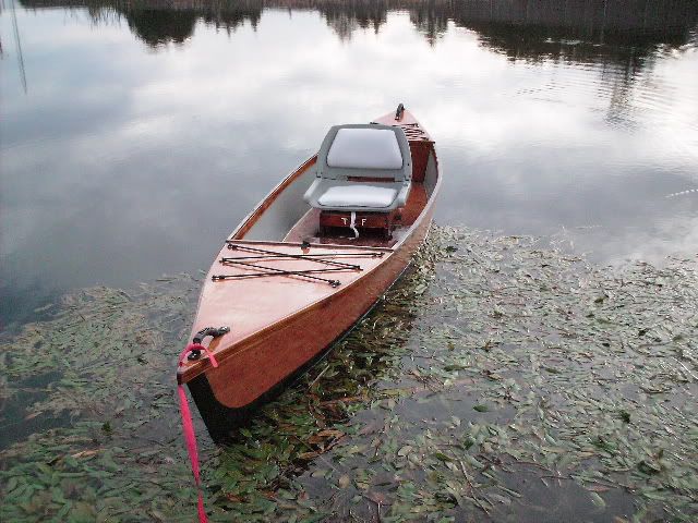

Good looking craft but I sure noticed a marina in the background of the #2 picture and another in picture # 3. Heck what can I say a person never has to many boats for there fun.
Let us know how this new addition to the congregation works for you. :D
PS. Noah would be envious....... :wink: :wink:

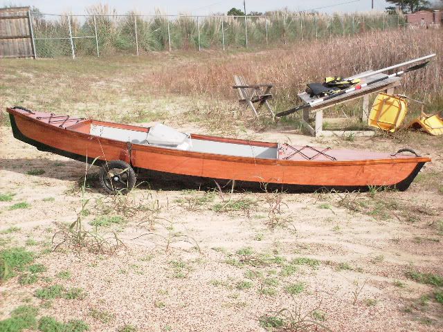

Couldn't wait, just had to paddle this baby. First thing right after Church ran home, changed my clothes loaded the Honey Bee and drove to the pond at my office. Turned around and drove right back home and got the paddle. :mrgreen: When I got back to the pond I trollied her down to the water and jumped in. I had a blast for about 45 minutes. She handles like a dream even with the high seat. She's fast, faster than the Bumble Bee, turns around in a heart beat, and I tested her glide . . . more than 200 feet without turning and inch, and she drafts about 2 1/2 inches with my 255 pounds sitting in the seat. Yes, I tested to see if I could stand up and "NO PROBLEM!"
I took a rod out with me and slung a lure for about 30 minutes and she did great. I made sure I tested the extreme casts (as far as I could cast) and she still was solid as a rock. I did my lean outs and she did good there also although I believe I could have caused her to take on water if I tried hard enough.
Verdict . . . I will be building another one of these babies . . . for me :wink: :roll:
Yes, I did keep better records and have all my measurements and drawings.
Any problems? yes, I managed to apply too much varnish on the last coat with my new spray gun and caused some wrinkles on the front and rear decks. But, I'm going to let Bubba paddle her for a while and when the weather gets bad I will take her into the shop and redo the deck varnish.
