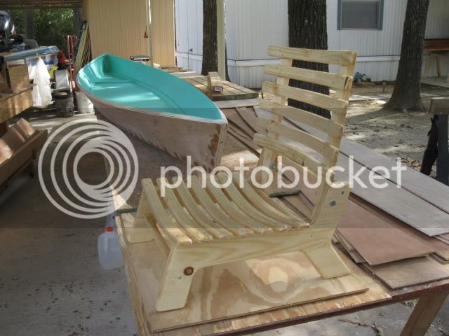

Can't seem to get a proper amount of fish slime on this boat. Beesboy and I went to the bayou but only caught a few small ones. It did give us a chance to compare boats and get in some seat time. His pirogue was faster (easier to paddle) but we cruised at about the same speed. The wind affected both boats about the same. My boat is more stable, allowing a higher seat.

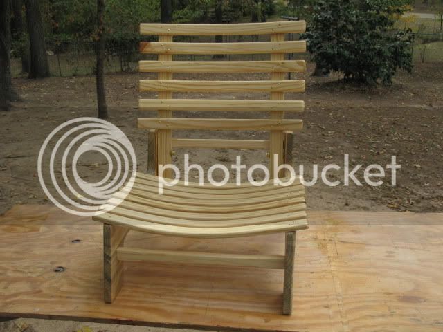

I made a new seat for this boat and it worked really well. It is very comfortable sitting high or low. I only put a 1/2" rise in the bottom at the front. This allowed me to comfortably stretch my legs straight, lowering the knees and reducing pressure on the back of the legs.
Also made another one, a smaller size. It has the same rise in the bottom.
JD, Are you bending those slats around a form? Very uniform bend there? Steaming or soaking?
Jack, sorry for the slow response to your question. After the funnies started :D I thought, I would see what they would come up with next.
I do bend them around a form. No steaming or soaking. They are laminated. I make two thin strips for each slat then glue them together and clamp around the form to dry. I try to do two slats (4 strips) on the form at the same time. After all the slats are cut to length and sanded, I match each next to the one most similar in shape. Small differences between individual slats are not noticed. It takes longer to build a curved chair, but "What's time to a chair?".
