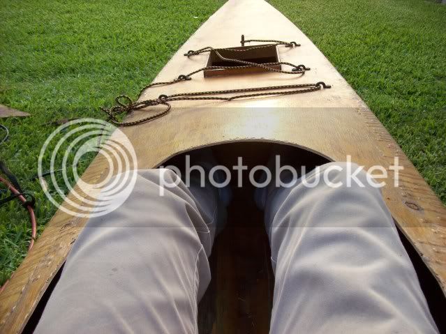

Well, couldn't stand the claustraphobia any longer. I took the jig saw to Old Blue and cut a bigger cockpit.
MUCH better. I can just pull my knees up for a little change in position and to help getting in and out. Cockpit is 33" front to rear. I might go another inch longer and maybe widen it a bit in the front. With my feet supported on the front bulkhead I can stll wedge my knees under the deck for balance.
I considered using the front coaming I cut off and just moving it forward and filling in, but the arc of the deck in that area is not the same. I'll probably just glue on some marine ply strips to beef up the edges.
I also played around with some left over camping pad for a back rest. That's part of paddling a kayak- fitting the cockpit to you.
