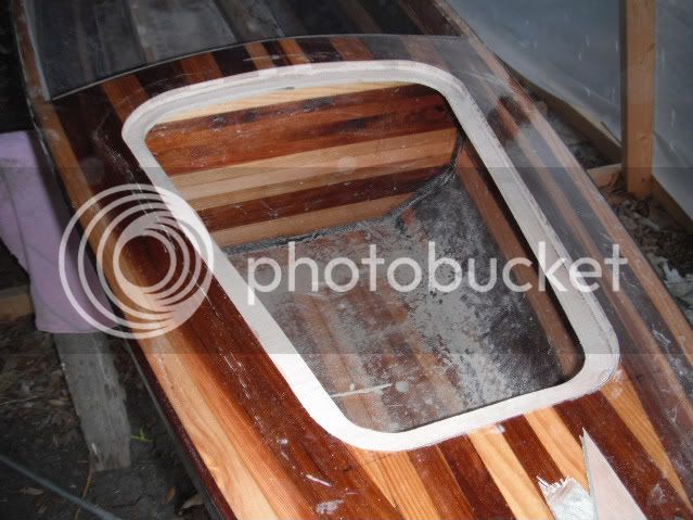

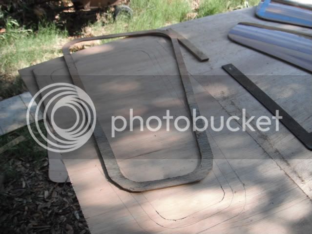

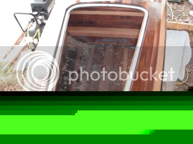

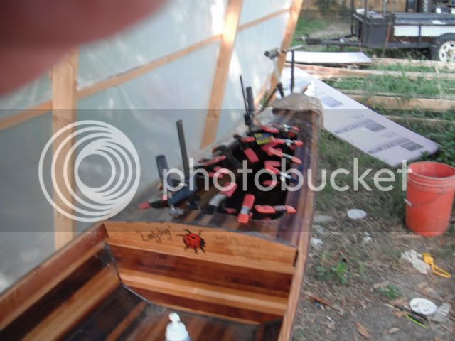

Flipped the bug over and started working on the hatches,
cut out the spacers and the lips
glued in the spacer ,you never have enough clamps
sanded it flush with the inside of the opening
then glued in the lip for the seal
hatches just need a gasket and bunjis now

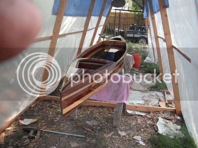

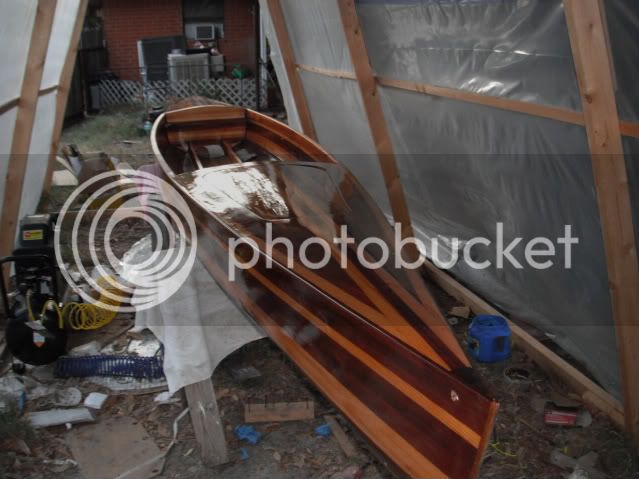

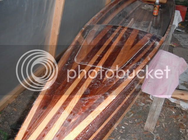

Final coats of epoxy on decks and cockpit

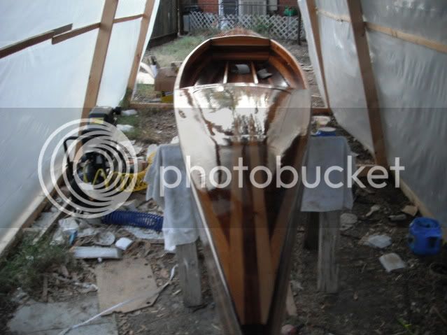

We will let her cure for a few days the a light sanding and the spar varnish will be applied
I figured she was cured enough and sparayed the first coat of spar varnish on today ,few more days and she will be ready to pick up.

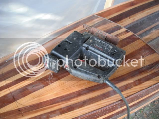

Any volunteers to make the cuts in the decks
Always a certain amount of pucker factor doing this.
How do you start the blade into the wood? Do you drill a hole for the blade to fit into?

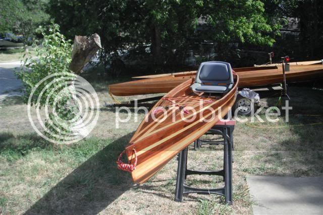

Wrapping the Lady bug up .
Gasket applied on hatch openings.

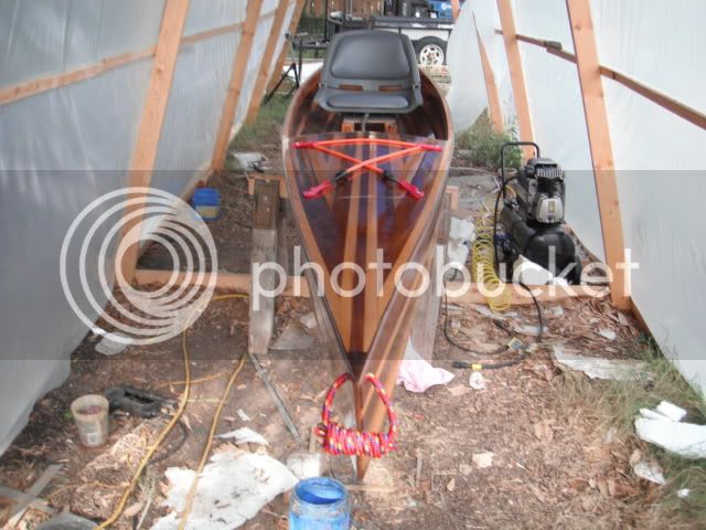

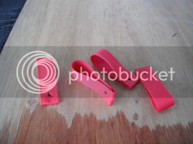

This Lady likes red so I made the soft pad eyes from red straps
Mounted them and put on the bunji cords

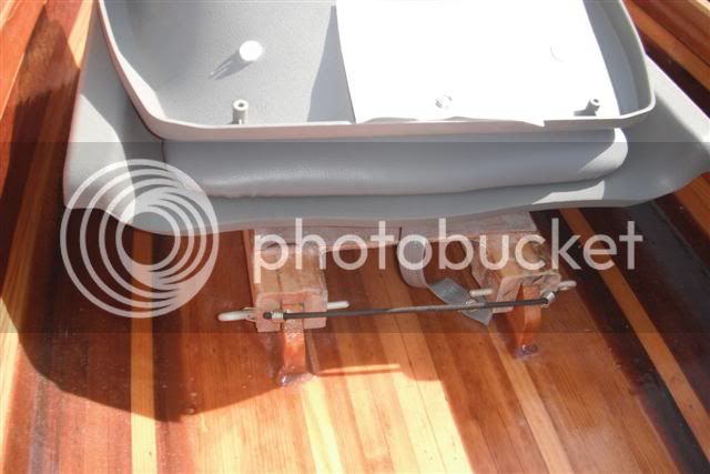

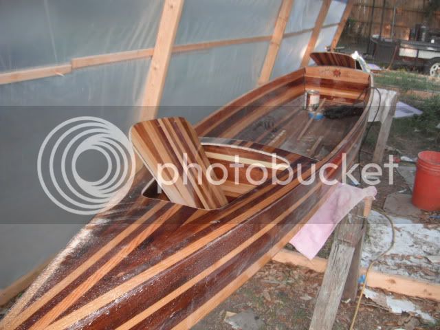

Mounted the seat . all I have left to do is clean her up now ,oh and red rope for the carry handles.
Horaaaaaaaaaaaaaaaaaaaaaaaaaaaaaaaaaaaaaaaaaaaaa
I am finished ,she is ready to pick up.

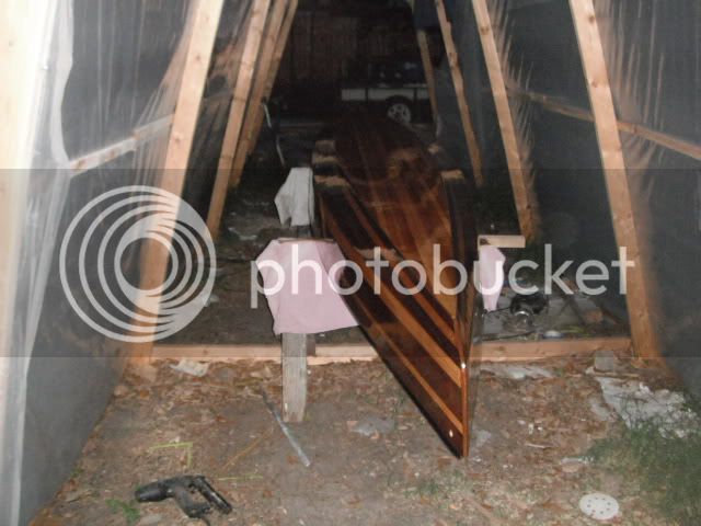

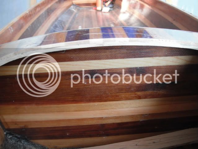

I had the boat tacked up and rough sanded and before I put a coat of epoxy filler on it I wet it down so I could get a good ideal for the colors of my fillets.
She is looking pretty good and slick. After she dried I was going to move her inside my tunnel. Thats when the trouble started. I picked her up ,now I have a thumb that was blown off a few years ago ,they reattached it but my grip isnt as good in my left hand,Well gingerly I picked up the bug and as I started to go to the tunnel the dang wind jumped up high, took that hull right out of my hand, when it hit the ground it split every seam I had tacked , the only thing holding it together was the ends. It looked like a banana peel
That was a heart breaking sight, I just turned around and walked off. After a hour or so I went back and started looking at the wreck the next morning went back to work on her and here she is finished.
Not one piece of wood broke ,just the tacked seams.

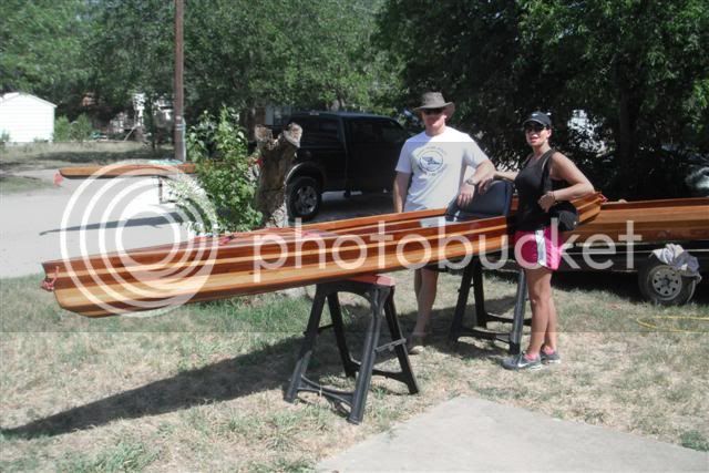

This is wrap up day . got the Lady bug out and wiped her of they are going to take her to her new home today
New owner Stacie and Ricky
They seemed tickled with the rig.
