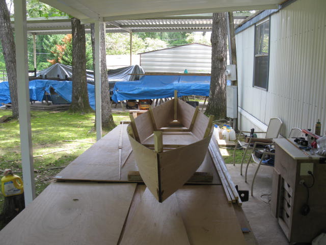

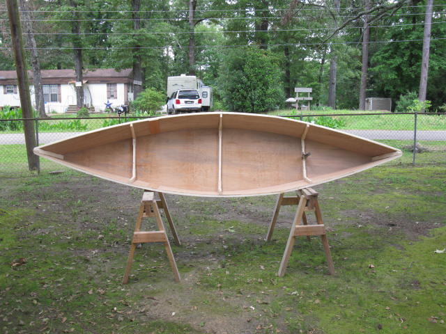

I decided to build this boat to answer that question and some other thoughts I've had. I can answer most of this question now and have not finished building . Gusseted ribs, exterior wood glue. and plywood butt joints work just fine without any epoxy exposure for a UJ "style" pirogue.
The 5mm luan is rated for exterior use. I think it will require some extra steps/support for use in the floor.
Should have made better picture of ribs. Simply put side piece on top of floor rib and used two pieces of 5mm ply attached (glued and fasteners} on each side. I trimmed them flush with router but hand saw or belt sander would have worked. My attempt to make the arrow head shaped stem pieces failed so I went with how I usually do them. This would be easier for young builders if they are doing the cutting.

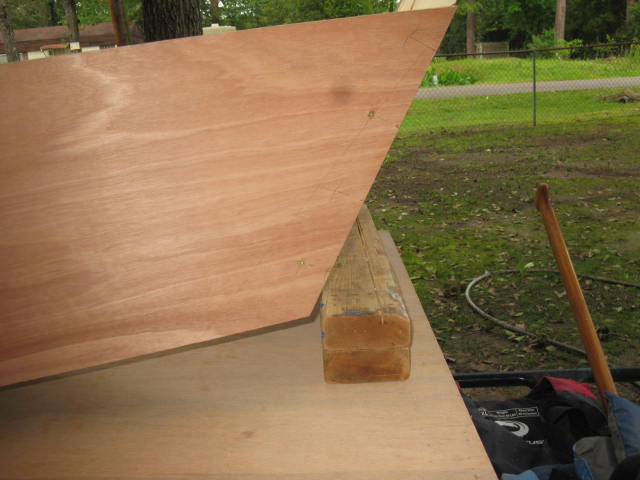

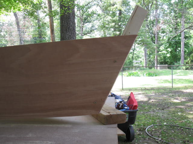

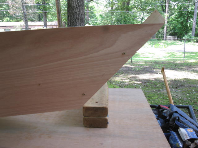

Lets talk rocker, flare (angle of the sides), cutting an arch in the sides and stem angles.
I first assembled the boat 11" tall sides, sides angled (flared) 15 deg. (per plans), and the stems angled forward at 30 deg. Plans call for 45 but I don't like that look and you loose some bottom length. A not too precise measurement indicated about 3" of rocker.
Thinking the 45 deg. angle might reduce it I cut stems to 45 and cut the sides to fit. It did reduce the rocker but only about 1/4". It also reduced the floor length 3" to 4".
Changed back to the 30 deg. stems. I then cut the bottom edge /chine line of the sides with an arch. It is 1.75" high at mid ship. This reduced the rocker to aprox. 1.5" to 1.75". Side width was reduced to 9.25" mid ship. They are 11" at the stems.
This started as a 12' boat, For a 14' I would do 12" sides and start with at least 2" cut out for the arch.

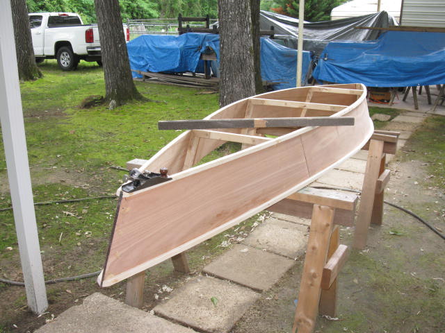

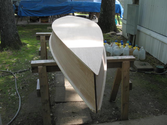

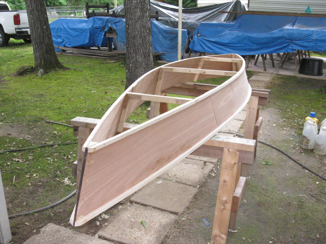

After installing the gunnels I turned the boat bottom side up and installed the chine logs. They will eliminate the need for epoxy/fiberglass. One might considering using 3M5200 marine glue if building for other folks kids. It is rated for use below the waterline. Gluing/nailing the floor to the ribs and chine log will make the joint strong enough.
The logs can be as simple as a batten strip with 90 deg, shoulders. I chose to make these by cutting a 1/2" X 1.5" strip off a 2" X 4'. I then ripped it down the middle with a 15 deg. (same angle as the ribs) cut. This gave me 2 logs 1/2" X 5/8".
The widest side faces the sides of the boat with the pointed edge up. All this does is reduces the sanding/planning needed to level them with the bottom. If you chose to use the 90 deg. batten there would be even more material to remove. The log's edges will be level/flat at midship but will change as the sides become more vertical at the stems.

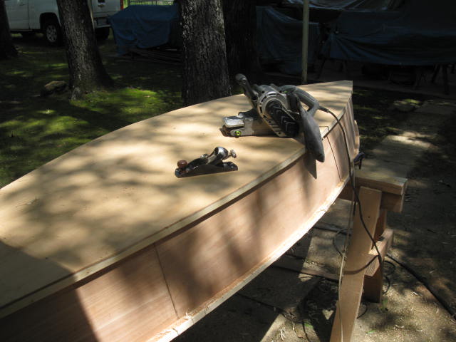

I start by leveling the chine logs with the hand plane. 40 grit sandpaper attached to a board longer than the width of the floor the used to dress them to a precise fit. A belt sander will work but I can't get as tight of joint with it because it tends to round over the edges and no relationship to the other side.

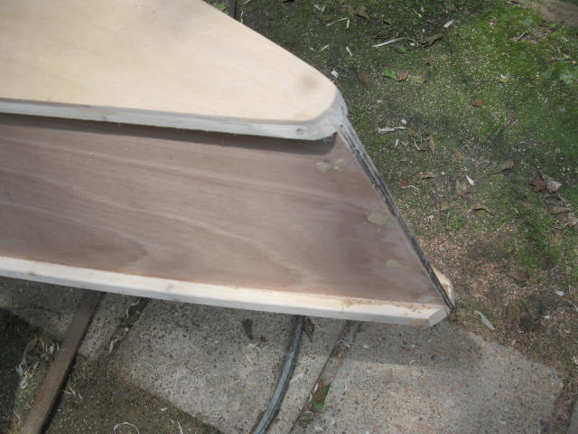

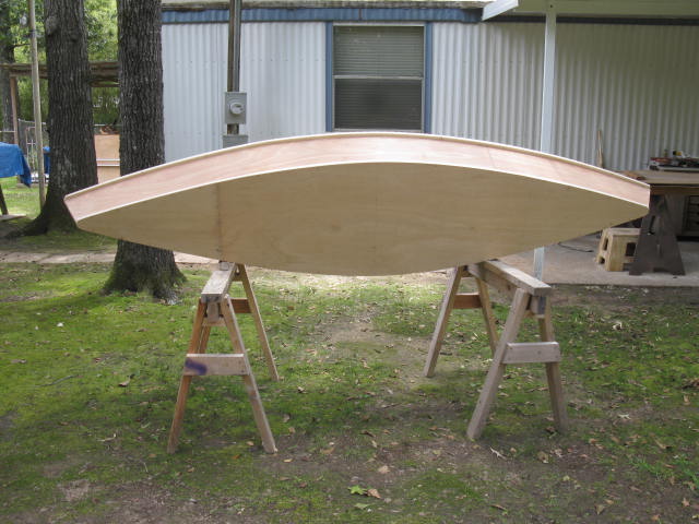

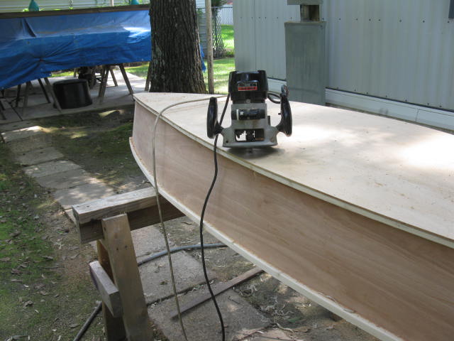

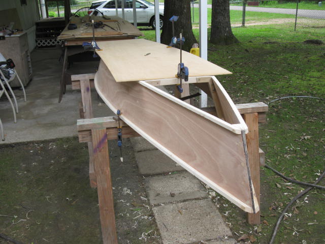

Clamped the plywood for the floor in position and traced around the chine logs. Cut out the bottom with 1/4" overhang and then glued it in place.
The router with trim bit was used to cut the excess over hang.
Finished fitting the bottom flush with a hand plane and belt sander, also rounded the floor and chine logs at the stems.

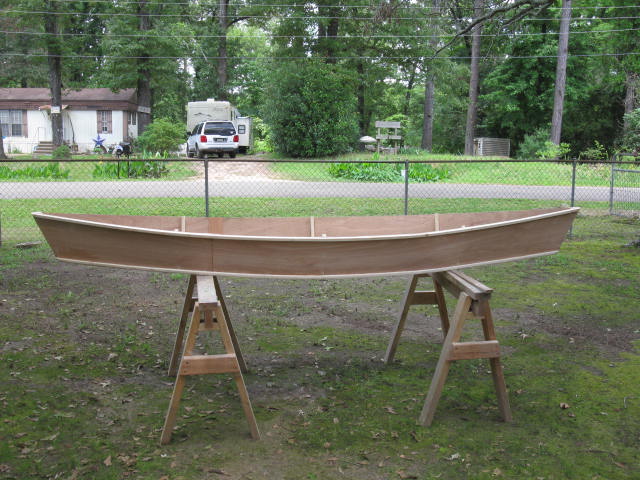

The boat does need some finishing work to elevate it above the "raw" condition it is in. That will have to wait until some more construction work can make it into a more practical boat.
The 5mm floor is too thin and flexible to be serviceable. Normally the solution would to cover it with fiberglass and epoxy. That is not an option because oldbuffpilot did not want to expose children to the epoxy. The simplest solution for someone starting a similar boat would be to use thicker wood for the bottom. That is what I would have done but the question was "will 5mm luan without fiberglass be strong enough for a UJ pirogue style design?"
Right now it is not strong enough for anything but very delicate usage. Can it be made strong enough for practical use? These are some possible solutions and thoughts. Please add any other ideas or comments you might have.
