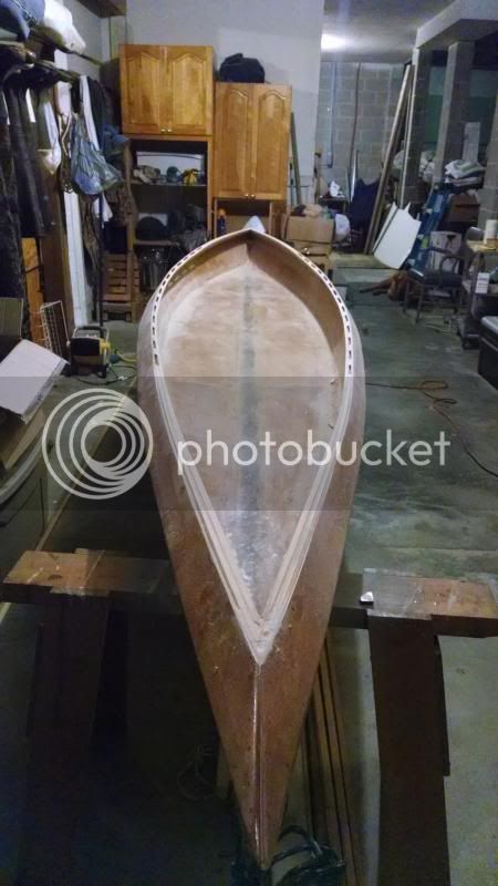

now I need to fit bulkhead in stern and undersupport for forward deck then put deck peices on and then outer rails and ... sand and paint. am I missing something? ....... Oh, how could I forget, sand, sand, and sand :D

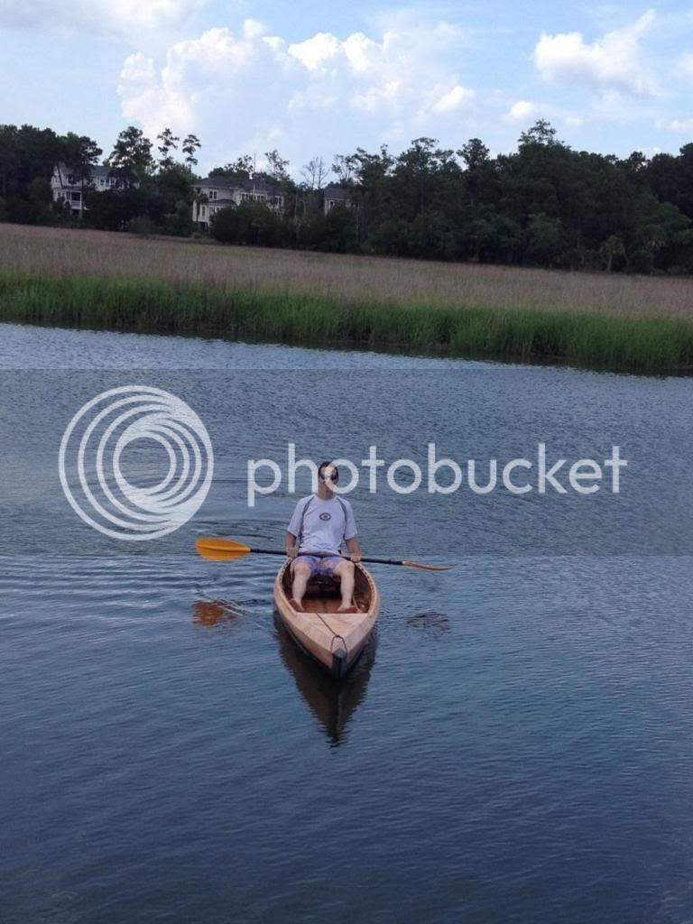

Well paint still not here but I splashed boat this weekend and I am happy. :D Tracks staight, turns easy and is stable. Love it! Thanks to all on site for help and interest.
Side view with me sitting too far back because my daughter got out of bow to take pic

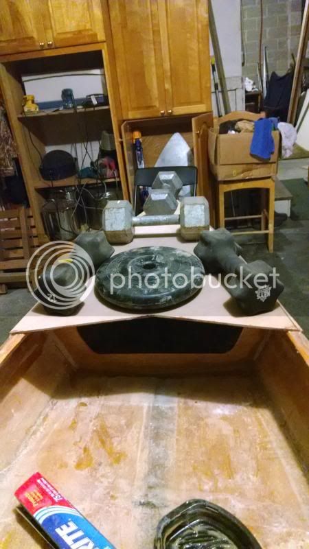

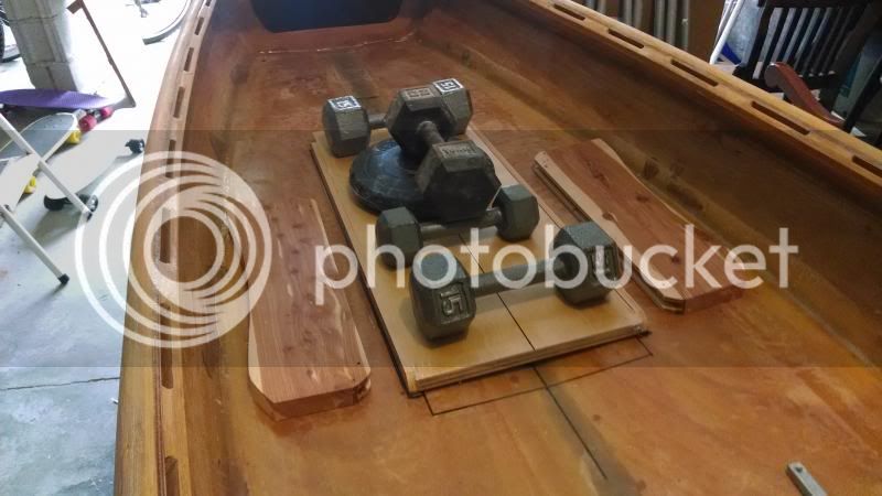

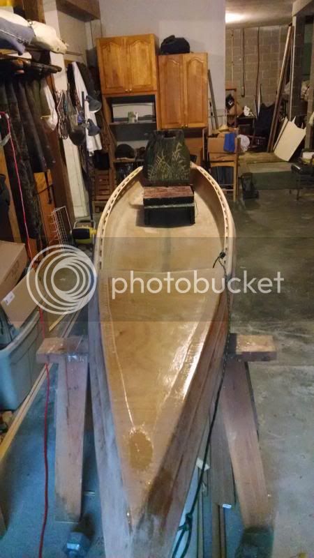

gluing down runners for seat, those pieces of cedar are the sides of the seat from a cedar tree I cut down when I was 17 in our backyard - I'm 51 now - Ouch! - that tree has built a lot of things and has been moved to alot of states over the years.

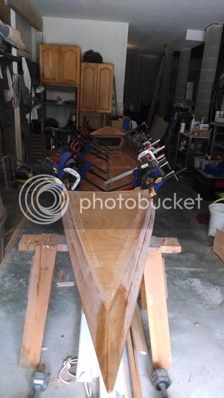

Actually I think I'm on the last plank now.

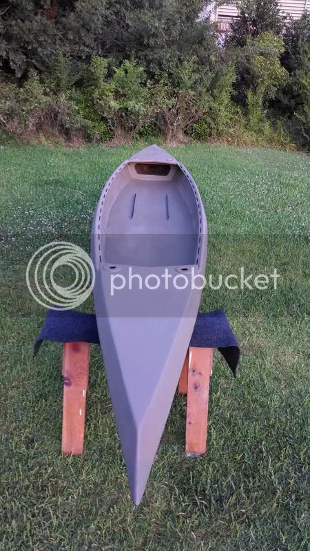

To Chuck and others, please be advised that some of the following content may be visually disturbing to you. :shock:

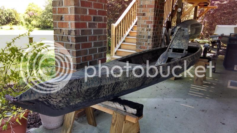

"EZ prime" white primer mixed with duck boat brown for desert storm look - dull dead grass to follow then stencils and spray paint. Painful to watch? :D
I will admit that I did pause for a split second before painting the rails.

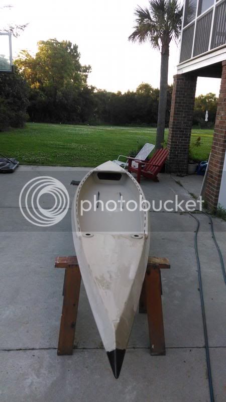

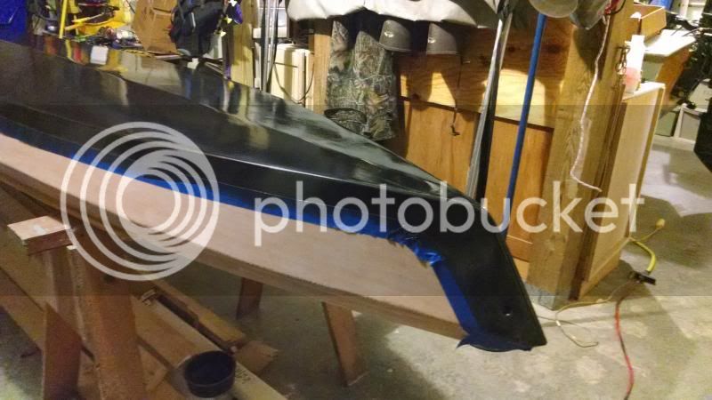

base coat was dull dead grass

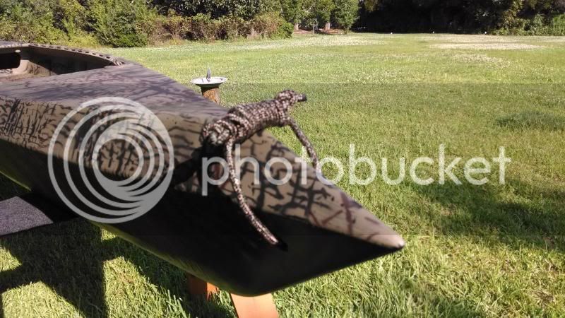

then scary part was starting with the spray paint and stencils from BlackJack Camo
I want to give big Thanks to Ron for his how-to on the rope handles

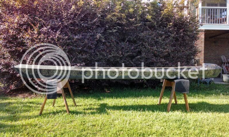

profile view
post note: Am I the only one that feels happy with the completion and the launch but a little empty feeling with the lack of an ongoing boat building project? Sign of an addiction I know...
