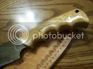

Dang Joey,
That iz some fine work. The blade iz special, but that scabbard aint bad at all. I used ta tool leather 'n made a heap a stuff (mostly belts, sandals 'n guitar straps), but never tried a scabbard. What keeps the blade frum cuttin' the waxed thread? That handle iz special too. I aim ta go see the fella who haz my Solingen blanks Monday. If he dont belly up ta the bar, I may take 'em all back.

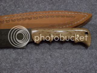

Br'r Bear, Joey did a nice job of a custom handle, didn't he. I asked that it be larger on the ends as viewed from the side, and larger in the middle as viewed from above. This fits my grimy little hand well, and doesn't slip when wet or gooey.
Birdseye maple is a treasured wood. Craftsmen of Pennsylvania used it sometimes for marked effect in the stocks of their squirrel guns.

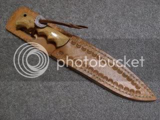

Jack, just use good old fashioned Johnson paste wax. I wouldn't store the knife in the sheath for months on end. As for the knife, treat it like a good duck gun--use it hard, clean and dry it and apply a little oil when you put it away for a while.
Jack here: Thanks, Joey. I have Johnson's paste wax already. Will use it hard, clean and oil it, and put it away.

Bear, there is a welt surrounding the blade, so the blade edge is actually touching the exact center of that one thickness of leather. If you look at the second picture and imagine a narrow strip of leather the width of the portion of the sheath showing outside the blade- that is the shape of the welt.
Jack, that handle becomes virtually locked into your hand as soon as you pick it up. I don't think it would slip outa your hand even if it was smeared with Viennie juice. :) :wink:

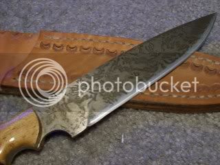

Great looking knife , the blade is a harmonious looking blend of Etched and Damascus steel while being a solid blade.
Definitely a working piece of art that is pleasing to the eye and practical for it's intended use as a camping tool.
Thanks, Chuck. I like this effect because high carbon steel WILL stain. So if it's gonna stain, I just as soon have a stain that looks good.

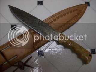

IT'S HERE! The knife arrived today about 15:40 hours. (For any civilians, that's twenty minutes to four. If any Marines are reading this, Mickey's right hand was on the 8, and his left hand was near the 4.)
One helluva knife. It will reach to the bottom of a 5 pound jar of peanut butter, split a chunk of kindling with ease, skin a critter for supper, clean a fish. slice bacon or potatoes readily, and lash onto a pole if I need a spear. I expect that it would clean and dress a turtle too, if I was thinking of doing such a thing. Dressing a deer or rabbit would be good work for it. (Cutting a fillet Mignon would too.)
The heat-treat etching on both sides of the blade add individual character that I've never seen on any blade before. Very unique, in fact completely unique.
I look forward to some camp work with it. (No, Ron, the knife doesn't do dishes or empty slop jars.) I'm practicing carving Z's into stuff. Piano, walls, doors, furniture.....

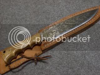

This is a very good general camp knife, and probably good for a lot of other outdoor tasks that this geezer just hasn't tried it out on yet. As per a suggestion form Ron Smith, I had Joey design this sheath to be carried sideways on my belt, just to the left of my belt buckle.
Several advantages here, and I thank Ron for his suggestion. First off, it is safer. The knife won't puncture through a leather sheath in a fall and poke your thigh (femoral artery, muscle, pain, etc.), it doesn't catch on my boat seat (a folding, stadium seat) and make me look ridiculous in a picture taken by a FORMER friend :wink:), it is in a handy position to grab quickly, and do to overhang of a tummy it is protected from many rain storms.
It did take me a few adjustments on the keeper strap to get a positive hold. The knife fell out a few times, and - luckily - was found every time. It is now a secure fit. The "etching" on the blade is very interesting, kinda like a Rorschach ink blot test from a Cajun. Thanks, Joey, for a great knife. Worth every dollar.
