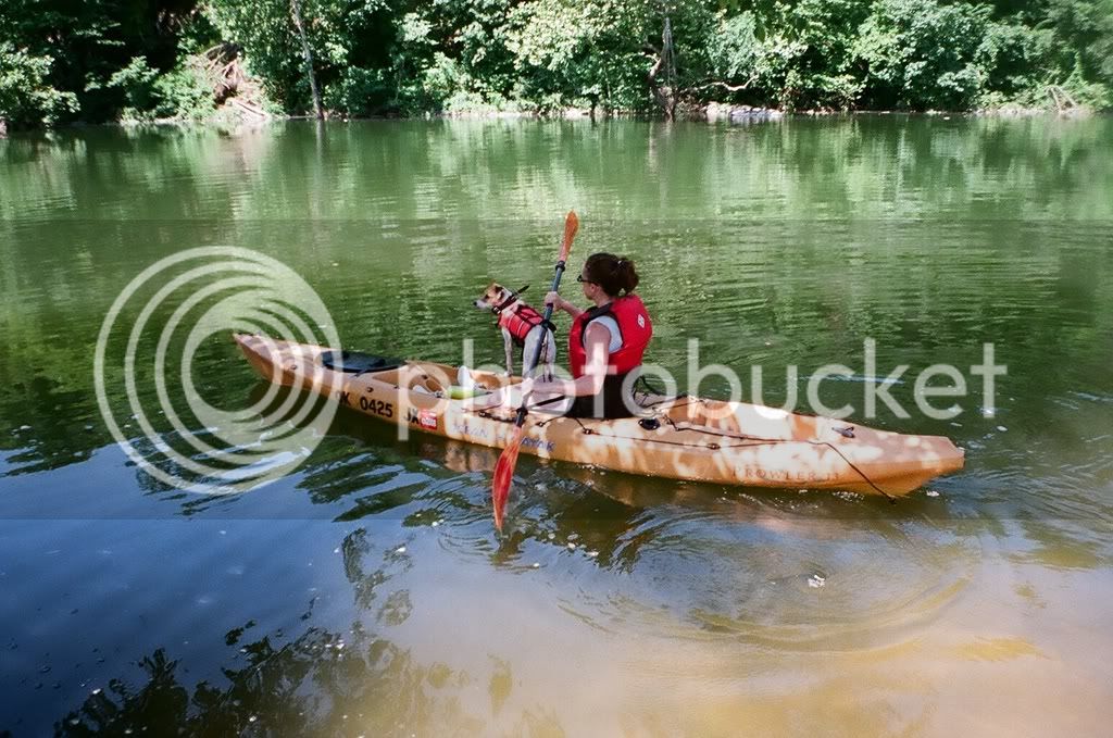

Unfortunately, my wife has paddled a friend's 15 foot boat (in plastic) and I can't seem to talk her into anything shorter. :roll: Oh, well. I am lucky that she likes to paddle with me, so I will get for her, or build for her, what she wants (very well trained husband....Momma ain't happy, ain't nobody happy!!).
Giving that she is using my 54 pound Prowler, I think anything lighter would suit her. Haven't asked her, but I am sure if I asked her if she'd want speed or lightness, she'd say speed. The dog is a Jack russell terrier and they have been geting along on the Prowler together, but she wants a "designated dog area" for him.
I was thinking laker 15, until I saw the nice looking Okwata. I would like to build one for myself, too, but like I said earlier, at 275 it may not have the capacity for me.

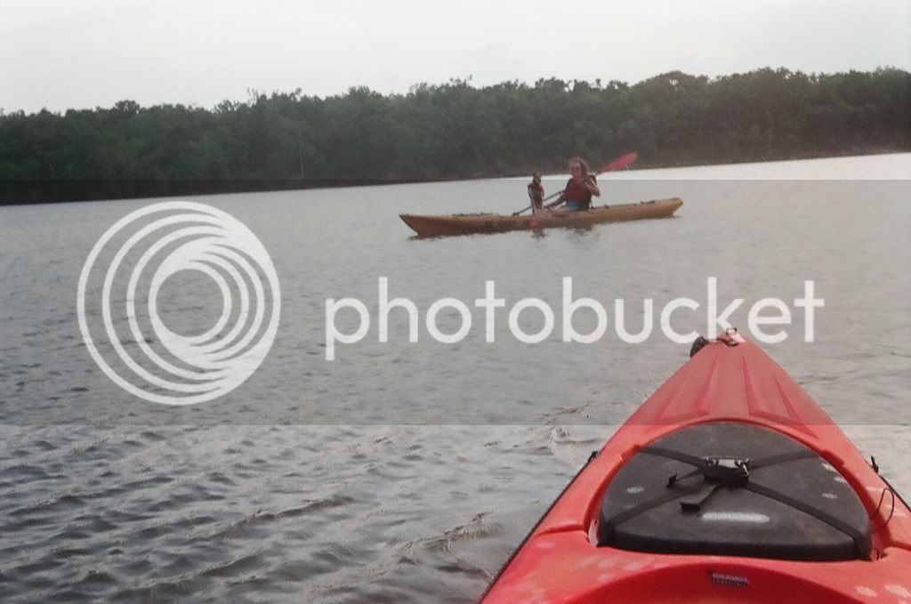

Here is the wife with said annoying canine.
For speed on flat water, it'll be tough to beat a Laker. But I don't know if I'd recommend a Laker with a dog. But if a 28" wide SOT is too wide, that could present a challenge.
I have a kids kayak I'm tinkering with that could be stretched a bit. It's meant to be narrow but stable for smaller paddlers. Not the best looking boat but it's function should be pretty nice.
When you say the Prowler is too wide, is she banging her knuckles or can she just not get her arms out enough?

A little of both, I think. IN the Prowler, she has to use a longer and heavier paddle that she doesn't like. Otherwise, she bangs her knuckles. Like I said, she paddled a friends boat, that was a lot narrower, and now she wants a narrower boat. I was worried about the stability and the dog, but I don't think it'll be a problem.
She got along fine with the dog on the narrower boat. I think it was 26" wide, but you sat on the floor, rather than being raised like on a SOT. I think that the lower seating position may have made it as stable, even though it was not as wide. She did lean right over and pull the dog aboard out of the water after he jumped in giving chase to a bird. We ride horses a whole lot (lots of times at full speed), so even when things change rather unexpectedly she has pretty good balance.
The other thing, too, is that we've only paddled plastic. A wider home made wood boat with no flex in the hull may be adequately fast enough to suit her. With a good tumblehome, it could be the way to go.
