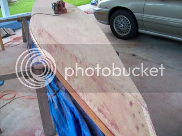

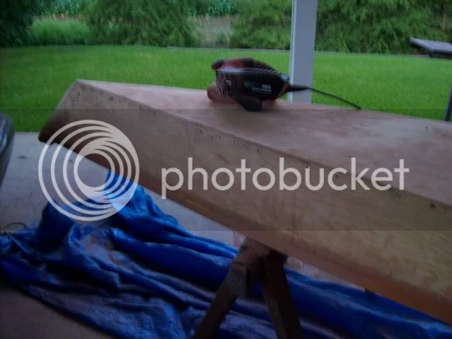

I know this might sound strange, but , unlike many of you, I like sanding. :shock: That's IF I have a tool that does the job well. It's strangely rewarding to see a ragged, blotchy surface change into a smooth plane showing all the natural wood grain. Almost as rewarding as seeing the grain pop out when you cover that pretty wood with varnish.
Yes, I am one dusty man. Sanded off 99% of the paint from the bottom and sides. I just have to go back over the boat one more time to get all the stubborn places.
I'm liking the woodgrain on the sides. I just might clean the sides up a bit more and finish it bright. After the graphite, there will only be about 7 inches showing.
