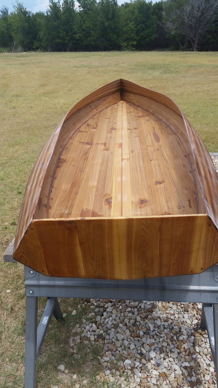

Guess I might as well pass on my experience and give you something to read. Sometime ago I glued a stripped deck and glassed on side to get ahead of the game. A few weeks later pulled it out of the shed to find it had warped so bad it wasn,t useable. About a month ago I had a good start on a pirogue. Glassed the outside, and had to quit because of some medical issues. Pulled it out today to start the inside, the tops of the sides are warped, and it is no longer perfectly square. All recoverable but will be added work. My thoughts are if you glass one side, don't wait too long to do the other side. It's more warped then the picture shows.View attachment 978

Sorry for the delay. Been real busy with life. Thanks for all the replies, hope I don't leave some answers out. The deck panel glassed on one side ",shrunk" on the unglassed side. It was flat tn a shed loft but no weights. I think the unepoxied wood dried quicker than the glassed side ,It actually curled up!
I think next time I'll at least saturation coat the other side. Bee, as for glued strip panels stored with out any glass, I've not had a problem.However we made our trip to the Great State of Texas in the end of January, and haven't been back to Kansas yet. I left a pi.rogue with panels glued, not cut out. I'm a little anxious about that. no bead and cove,. air dried, side strips are 3/4 and floor 11/2 wide. We hope to go home soon, we live very rural in Kansas and medical access is much easier here in the Austin area.

In general terms, seems the problem was the wood continued to dry, but the glass restricted it's even movement. Thanks for the info.
