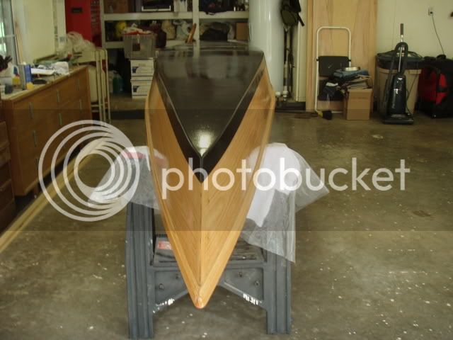

Oh yes!
I mentioned before that I liked the looks of the sanded graphite bottom, sort of a gun-metal gray and not so flashy.
Well, if you think a high-gloss paint job can make every little surface flaw stick out like a sore thumb, wait until you sand an epoxy-graphite hull! :shock:
I just did a little bit of sanding, to knock down a minor run in the finish. What I discovered was that surface that I thought was nice and flat and smooth, actually has some high and low spots, all beautifully high-lighted in gun-metal gray and gloss black.
When the last coat of epoxy/graphite goes on, it will stay nice and shiny! :lol:

Got the info I needed on painting. (Thanks, guys!)
The sides have been painted, and I now have a quart can of Z-Spar Varnish for the "brightwork." Rigging up a spot light so I could get a good look at the paint job in the garage revealed one "unhappy reality," I'm not quite done with the epoxy/graphite goo.
Just on one side, there's a foot-long patch that is translucent. You can just make out the wood grain, so I'll have to give that area another coat. This must have been where I was working when I finally figured out that I'd been making my mixture a little graphite-rich. Oh well.
That will be easy to take care of, latter today.
As soon as it's dry enough, I'll turn the boat over and get the insides done. I'm no longer worried that I'll run out of time, this week. Lots of time left! :)
