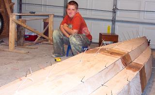

its been a spell , but i was sidetracked for a few days when my motorcycle died and i had to track down an electrical problem . nothing more aggravating than the spaghetti that passes for wiring on a 34 yr old jap bike. except trying to locate the correct parts when you do finally figure out whats wrong :?
well i got the panels all butt blocked together. i used heavy lay up cloth for the inside blocks and some super light 2 oz for the exterior seams of the panels. i backed everything with wax paper so i didnt stick it to the shop floor. i laid another peice of wax paper over top , put a wooden block on there and set a 5 lb barbell plate on top of that to hold everything tight.
turned out real nice. a very clean and nice looking seam when i peeled that wax paper out of the way. 8)
ive heard noises about poly being hard to stick to wood , thats bull! get some good quality lay up resin . should have a consistency about that of sorhgum , and you can thin it even more with acetone. mix em about 85% resin , and 15% acetone and you have some super thin stuff that really soaks in good. then mix it to fire off slow with about 2/3 the amount of hardner you would normaly use with your resin and plan on letting it sit over night to fully cure - it sets into the wood real nice making a good bond.
i built my jig frame and stitched the transom into the first couple panels , starting to look like ( gasp!) a boat!
the more i work on this thing , the more respect i have for you fellas that can finish off a wooden boat to look so purty. at this point im very thankful that this is only a plug for making a mold and that i will be able to take great liberties with applying bodyfiller ( bondo!) and sanding and fairing to get the fine hull shape i been day dreaming about. ~allen

nuh , my backs okie dokie . saw horses might make it a lil too tall for my boy to help out. its plenty high enough i aint crawling around on the floor so im happy
i fabricated us some custom made work stools just for this task. can see my brown work stool sitting next to his at the end of that thing kinda looks like a boat :D
~allen
