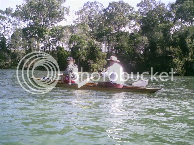

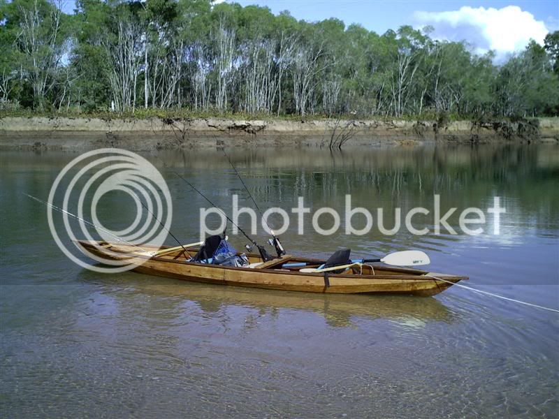

That boat is a 16 foot swampgirl with 2 inches taken off the top panel.
She looks a little low on freeboard with two in her but I haven't taken any water over the side or bow yet.
From reading your posts, it seems you may be paddling in similar conditions to me and have very similar needs. A lowered swampgirl fits my needs for this very well.
She is my Mud & Blood boat that I use to chase serious estuary fish like barramundi and I also crab from her. She is immensly stable with an acceptable turn of speed and minimal wind signature.
