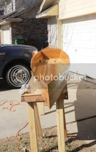

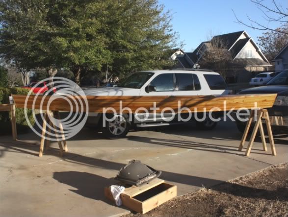

It has been a while since I worked on my Cedar Strip Panel boat. I kind of got burned out for a while and just let it sit. Lighthouse Keepers Kid has been after me to finish so we could go fishing and I have been busy the last few days when I wasn’t waiting for glue or epoxy to dry. I just need to put on the outside and inside gunnels, trim the bulkheads, glass the outside of the decks, completely sand the boat down, put on three coats of spar varnish and build the seat platform. I should be finished by the end of white bass season for sure! ET :shock:

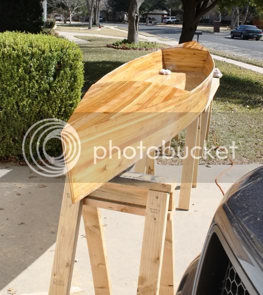

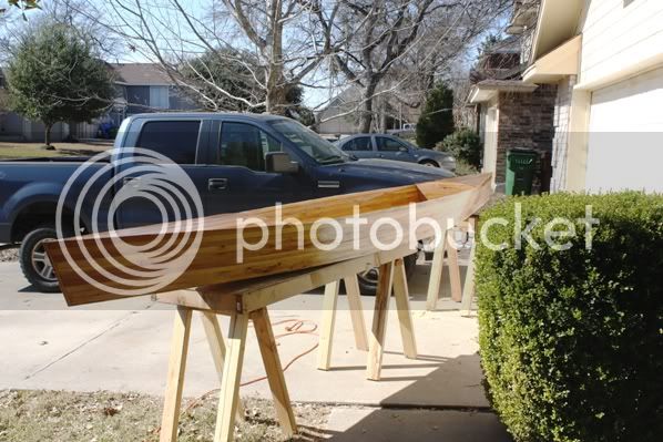

This is only my second boat and I am real leary about cutting the decks and trying to make wood ones so I am thinking about just puting 8 inch round plastic screw ports in the bulkheads. I really have not got far enough to make a decision yet. I want to make sure it floats first. ET :wink:

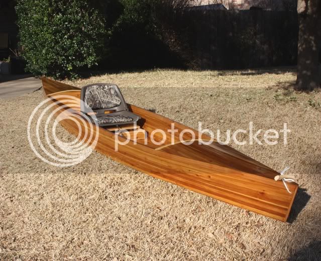

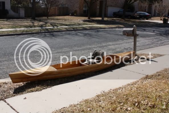

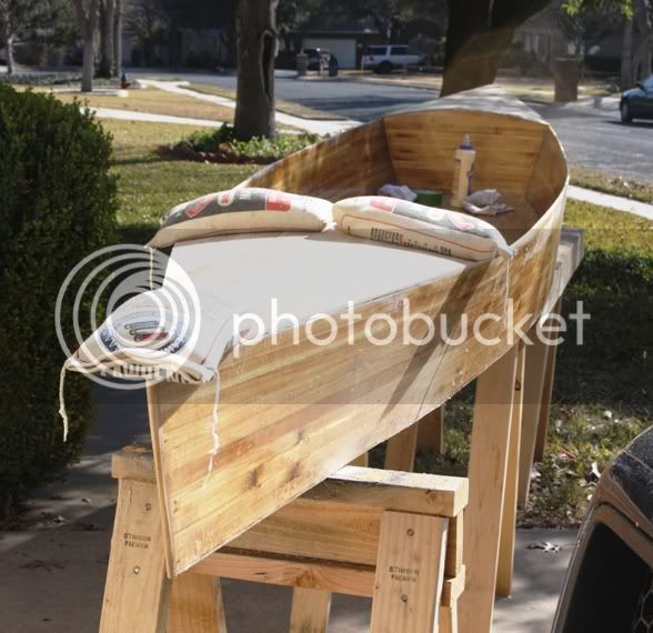

These are approximate
17 foot long
26 inches bottom widest point
29.5 at the gunnel widest point.
seat platform is 6.5 inches
seat itself is just under 9 inches high.
