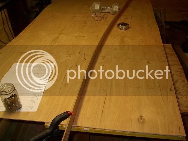

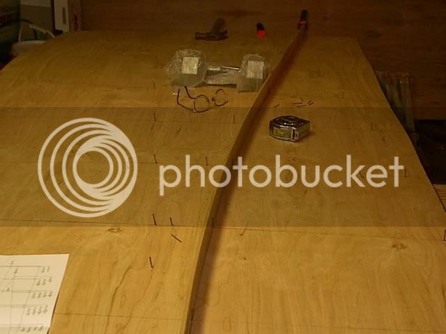

Pic of starting to lay out the parts
another pic

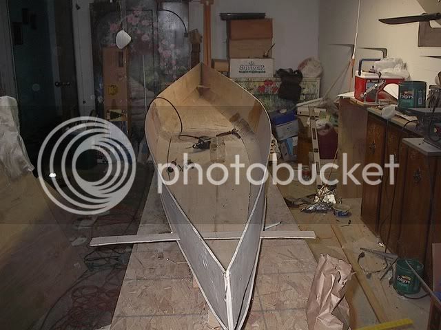

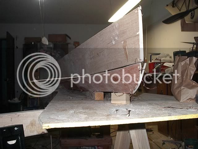

after cutting and joining section stiching hull together
well enough for one night

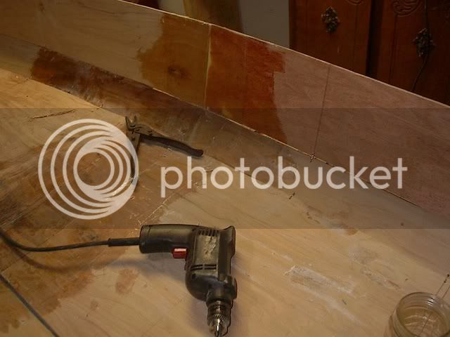

Splices fiberglass on both sides

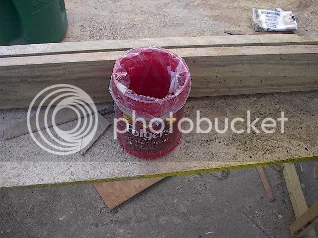

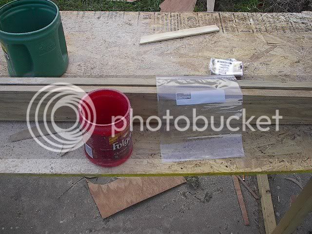

This may be old hat to ya'll but it works very well for the fillet material.
Take coffee can and a zip lock baggy insert it in coffee container fold it around edges go ahead mix your resin take it out snip the end nice neat no mess.
baggy inserted
