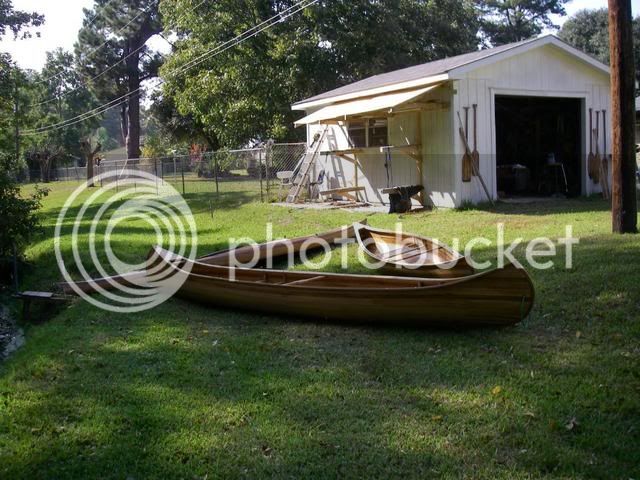

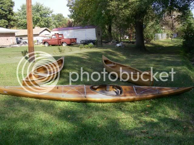

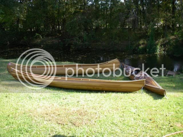

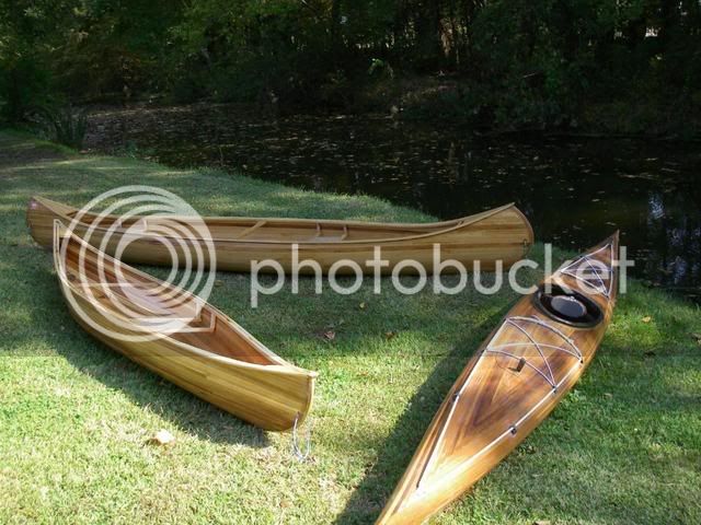

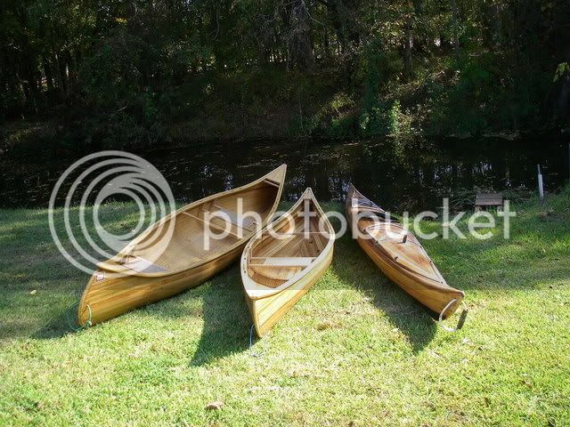

Well the final installment...............................[maby]
The fleet assembled
I did notice that there is not a flat bottomed boat there. Now I have heard, unverified of course, that there is a man who sells plans for just such a boat. Maby I can do an extensive search and with luck find this elusive person. So there is the possibility that the fleet is not actually complete. Time will tell.

Your fleet is grand, I'm just a little bit curious to your mini pier or dock or that place you step as not to get your feet wet.
Heya baldy,
Beautiful boats mate.
I really like the lines of the little solo canoe. Could you please provide som information on it?
Oh yeah, I just love the old red pickup too. Man, that is MY type of car!!! :D

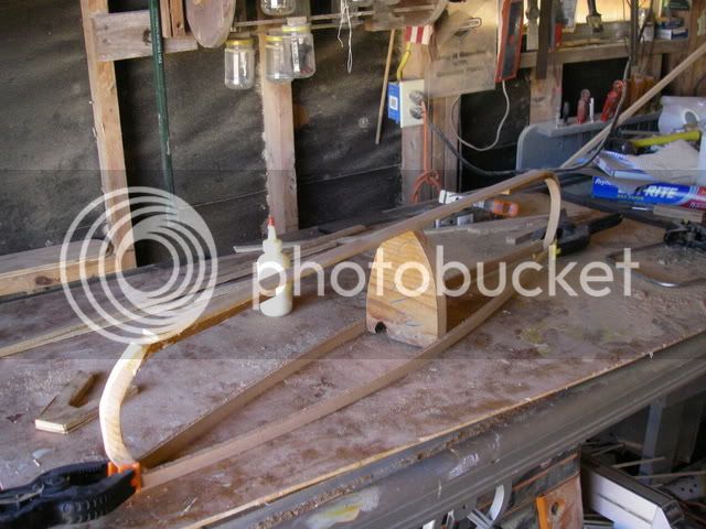

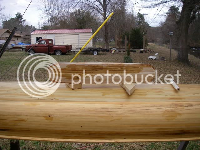

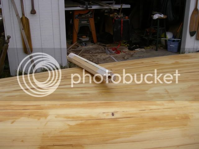

O K the mast construction has been started.

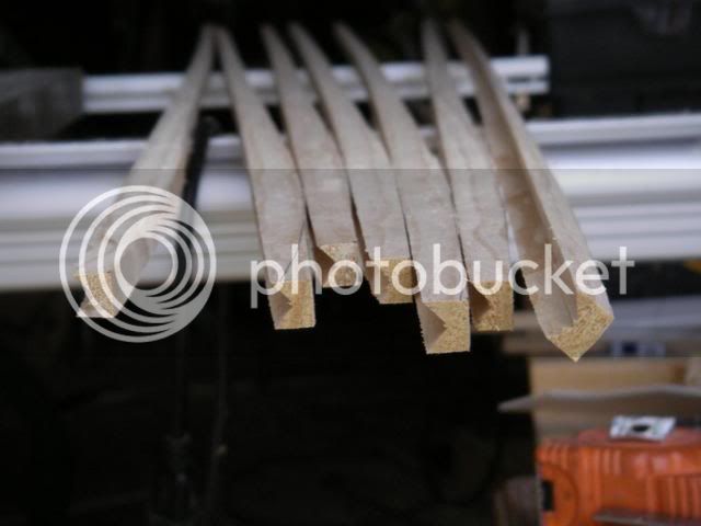

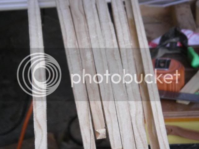

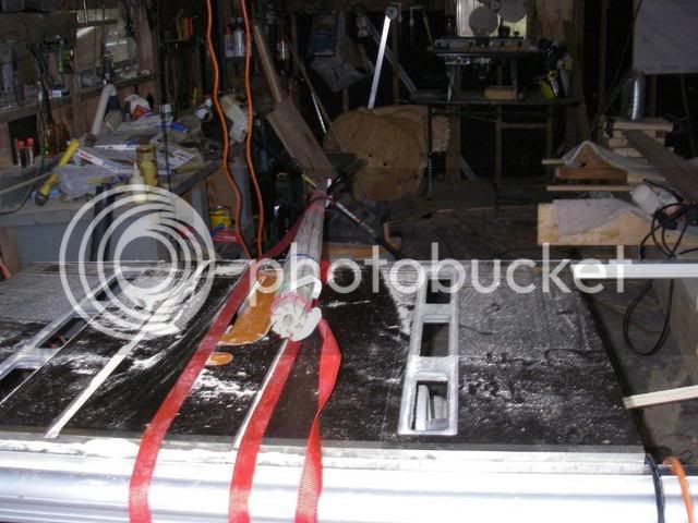

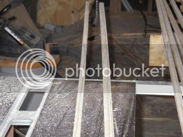

Here you can see the before and after strip. Left side is freshly cut from the board and right side has been tapered for the lower 10 inches to make a 1 1/2 inch dia. end, then a 6 inch section of 2 " dia. then a taper to the tp which is 1 1/2 ".
Another view

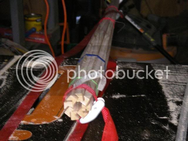

Dry fit to see how it will come out.
It will have to be wraped real tight after the epoxy has ben put on. I think I will have to find some old tube to cut strips from to wrap it tight enough.
Then a LOT of sanding. [ what do we do on boats that dosen't require SANDING.?]
All cuts were made on the table saw. The notch with the blade at 45 deg. The angles I just marked and free handed. The thickest portion to be removed was 1/4 inch so I had no problem forcing the wood a bit if itstrayed off the line.

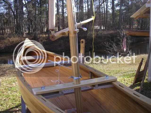

As usual with me a lot of time has past. I have been piddlin around a bit tho.
I have just about got the sail rig complete. a couple of minor fixes and it will be ready to get me wet, as soon as the water warms up.

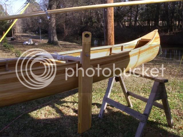

Set the rig up dry to see how it would fit.
The leeboard set in the approximate position.
A view of the boom and gaff jaw
An overall view. Gaff at the top of the mast.
Looks as if it will work. Still need to add some shims under the crossmembers since the inner gunnel tilts downward a bit. Don't want to put to much pressure on them.
Add another pulley on the boom for the sheet and a thingy to tie off the haylard which will go on the leeboard thwart.
I have a seat made and will put permenant runners foward of the rear seat. That will give me a movable and re- movable seat to help with control and will get My fat butt down to about three inches from the hull for a bit more stability.
I made the seat so it will just set over the wicker seats. Tha way if I want to have a backrest I can just set in on the wicker seat.
The sail will be 44 sq ft . I built the rig to the ACA specs. I intend to buy a poly tarp and some 2 sided carpet tape and make about a 1/2 size sail to start off with. That SHOULD be enough to get me going and gain some VALUABLE experience without scareing the you know what out of me.
The total amount of sailing I have done was about 15, count em,15 min. in some type of skiff over 30 years ago. It will be "new and exciting"

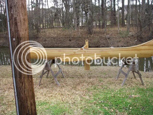

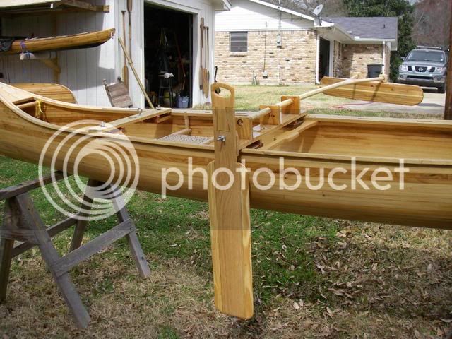

I have however removed my large rear-end from the chair long enough to do a bit of work on an outrigger .
Hopefully, it will be enough to give me a bit of stability when needed. Thus preventing an excess of swimming.
The outrigger it'self is 3' long X 5"[high] X 41/2"wide
And I am going to attach [removable of course] , it to the canoe with an 8' pole. hollow like the mast and boom but, this will be a faux birdsmouth
it is made up of 8 sections glued together but, just angle cut on each side rather than the " birdsmouth style.
The "arm" is 1 1/8 " diameter and will be 8' long. About a foot and a half will slide into a fiberglass tunnel I will put on the leeboard thwart.
I will have a "key"slot that should keep the arm fron sliding out. [I hope]
I am going to "try" to split it on the end so it will be attached to the outrigger fore and aft, rather than just one attachment point in the center.
If it works , then I'll post a pic. If it don't, I'll just say I changed my mind.

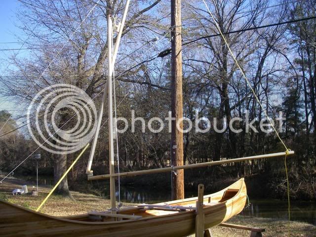

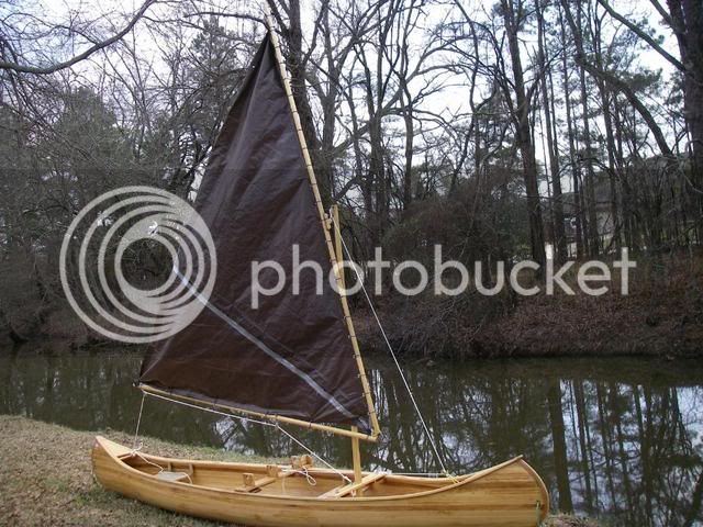

Here we see the outrigger in place
And the leeboard
Don't laugh at my sail, I made it out of two small polytarps I had.
Now to wait for warm water to test it .

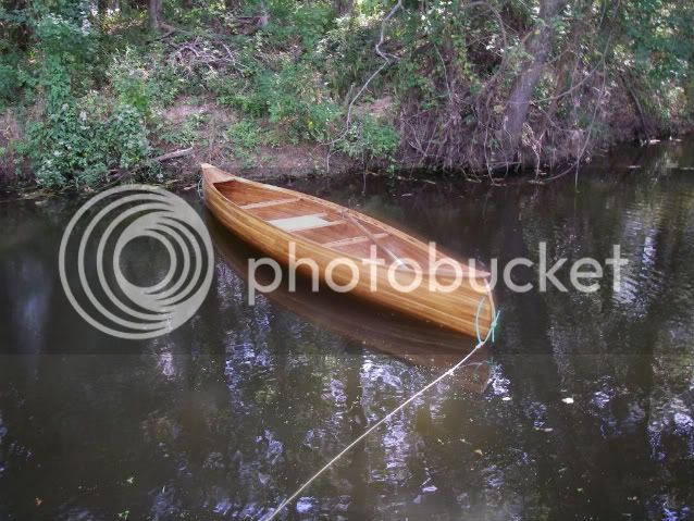

Boat 4
I think this will do it for a while.
A short story: I started to build a Sas 14-30 from JEM. For some reason, I could not get the pannels to come out right [I haven't given up on that yet] SO.
In desperation and needing a boat fix I decided to make it as a stripper.
I don't think it is as nice as [you know whos] but it works for me.
I had a bit of trouble with my other solo being too easy to turn. On this boat, I left the hull nearly flat. THe bow and stern set in the water real nice and it tracks like it was on rails.
It also paddles and moves nicely. One stroke and can glide for 50 yards [with a slight tail wind] It takes very little correction.
