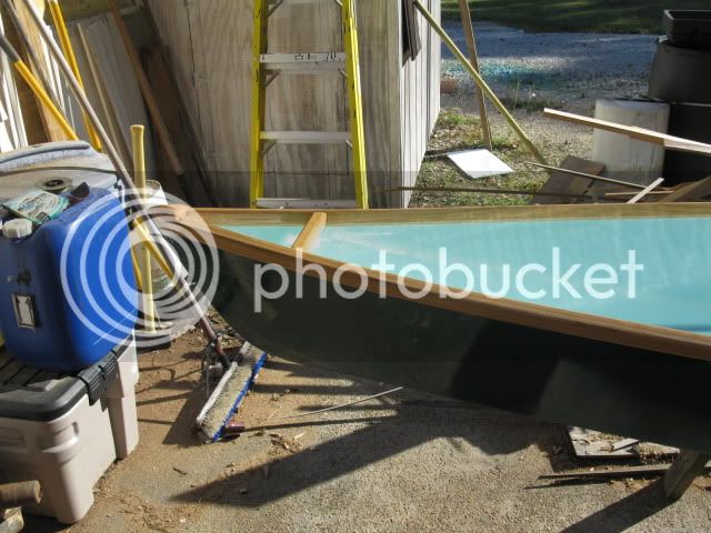

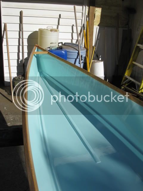

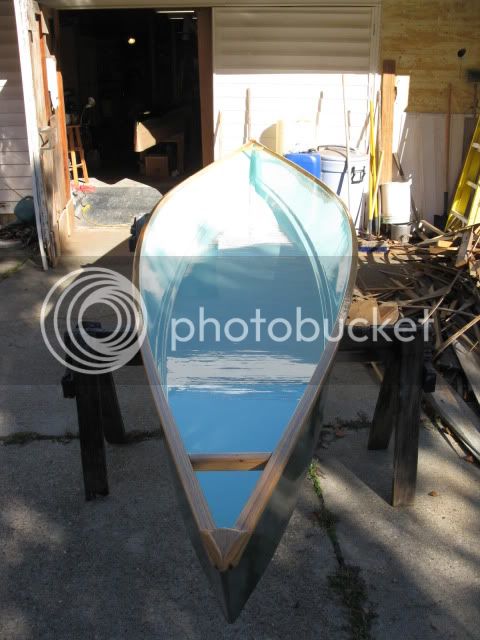

The build is over and I am thinking I might keep her.
Weighs in at 58 lbs. Just needs some paint and the white oak gunales varnished.
Time to finish the kayak will the epoxy cures on this boat.
Thanks everyone for the comments.
came out real nice
what's that little stick across the gunnels gonna do for you?
keep it spread until you put in deck or breasthook?
or just a carrying handle?

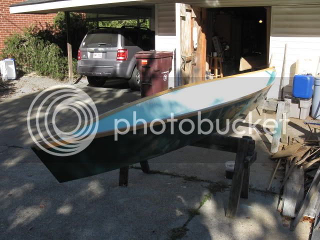

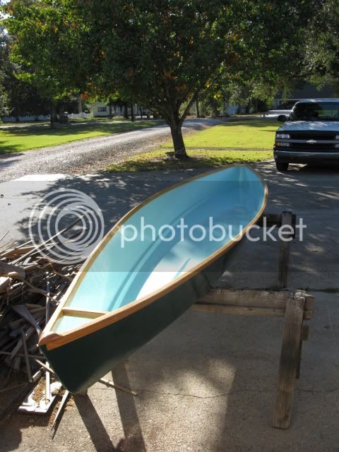

The piroque is finished:
16'-4" length
25 1/2" bottom width
37 1/2" beam

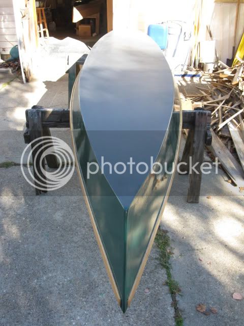

6' long semi-vee
Glassed outer (Painted w/ interlux Sea Green)
Saturated inside & faired (Painted w/ interlux Light Green)
White Oak gunales & End Caps (varnished)
Graphite bottom
Thanks everyone for the help, (esp. Beekeeper, Seedtick & Keith)

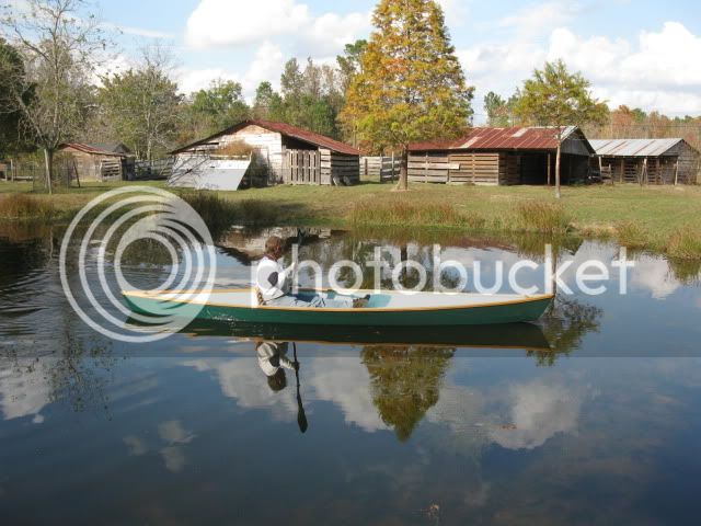

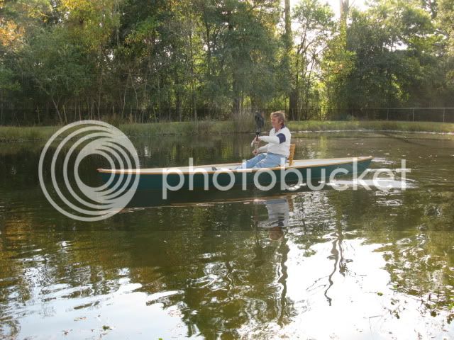

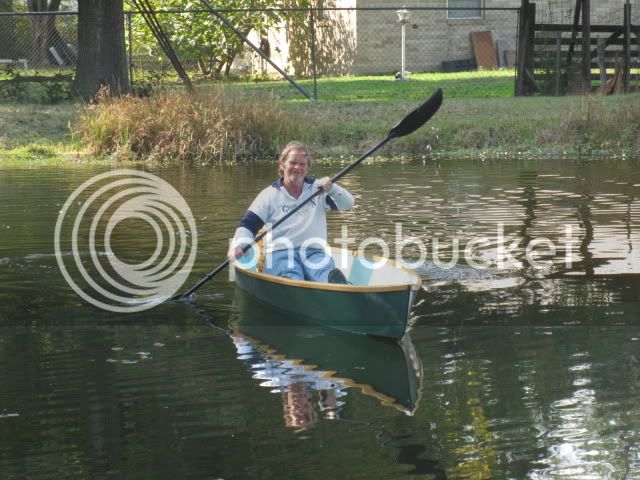

I forgot to mention, it passed the beekeeper capacity test. It floated me! :wink:
The boat paddles very easy and tracts well. The extra length and flaired sides provide much capacity and freeboard.
I like it. :D
