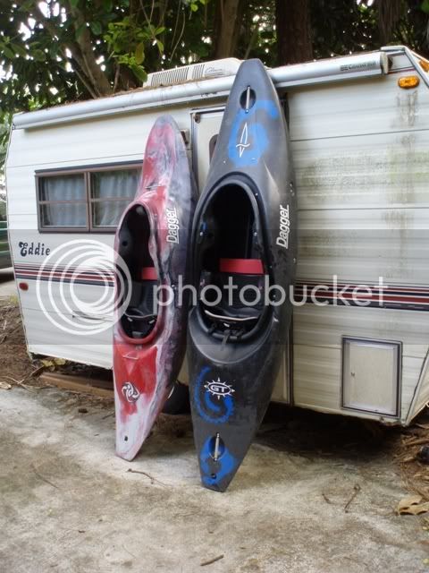

These plastic boats have run into rocks, stopped by rocks, slid over rocks, landed on rocks, hung up on rocks and bounced off of rocks, PLENTY since I have owned them PLENTY more before I have owned them. FAR from worn out, not a single split or crack in the hulls yet, Plenty of scrapes & gouges, but that is expected, thats what they are built for. Their material thickness is not any thicker than my 14' & 16' roto molded touring boats.

I never had a plastic boat crack 'er split 'n I have hit some mitey big rocks over the years. Worse, I hit the car port back in 2005. It crushed the bottom of the canoe. Left some white paint marks on the outside 'n some wrinkles in the plastic on the inside. After I backed out, it popped back out 'n aint caused me no truble since.
ps I seen a 40 year ole Blue Hole OCA that had some cracks in the bottom. That canoe spent its life hittin' rocks 'n bein' left out in the sun. It needed a little duct tape over the cracks ta keep it frum leakin' last time I looked, but I figger it iz still runnin' rapids fer a few more generations....somewhere up in Taxsylvania.
