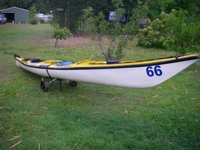

G'day guys, not a build this time, but Robin and I are doing a run up out Mary River with the local canoe and kayak club tomorrow.
The run is 24 miles and for a change, I brought our old tandem sea kayak out of retirement. :D We haven't used this boat in a couple of years and because we are both not as paddle-fit as we would like to be, we thought this one was the best option.
The boat in question is a Dusky Bay double, in kevlar, made in New Zealand and is the most popular tandem sea kayak in Aust and NZ.
20 feet long, very fast and manouverable and very seaworthy. we both got excited, just lifting her off the racks today. :D

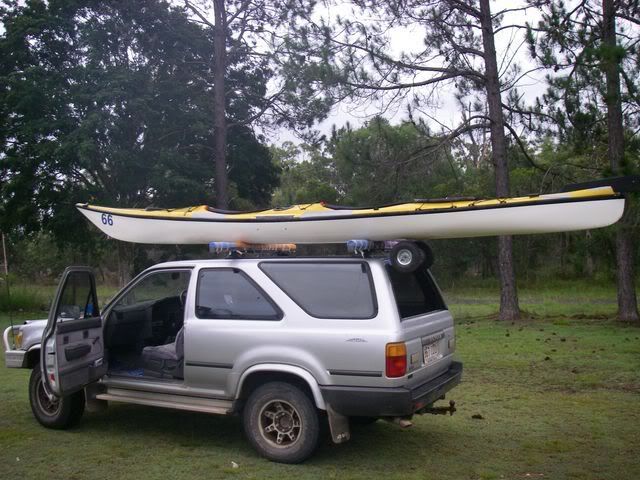

I like the addition of your rollers at the rear of your rack. When you get around to it, could you maybe post a pic of your setup?
G'day BL & Ozzie, No problem mates, Will post some detail further down. :D
G'day Chuck,
It looks like a Roller Loader to me.
www.RollerLoader.com
Similar, but not quiet the same. I made this one before I discovered the delights of the internet :D

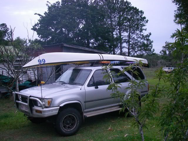

I was wondering why Mick inverted the kayak when it has travel covers over the cockpits and could be transported upright.
Petrol has just reached Aud $1.29 per litre here. (not sure how much that converts into US gallons) I inverted it because I think it is more aerodynamic that way :D

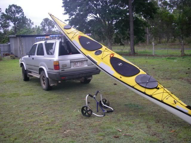

Some detail on my loader,
I bought a cheap furniture trolly from a cheap chinese imports mob for $20.00.
I only wanted the wheels and pneumatic tyres and the axle.
I welded up a steel holding frame to mount to the roof of my SUV and added a boat trailer roller onto the axle between the wheels. This allows the kayak to roll up and onto the wheels.
Welded a couple of lugs onto the kayak carry bar
That is in turn, bolted to the BS roof rack that came with the car.
Added a piece of pool noodle across where the loader sits against the paintwork of the car.
And the rack just slips into some holes in the lugs and holds it there while I load. :D
