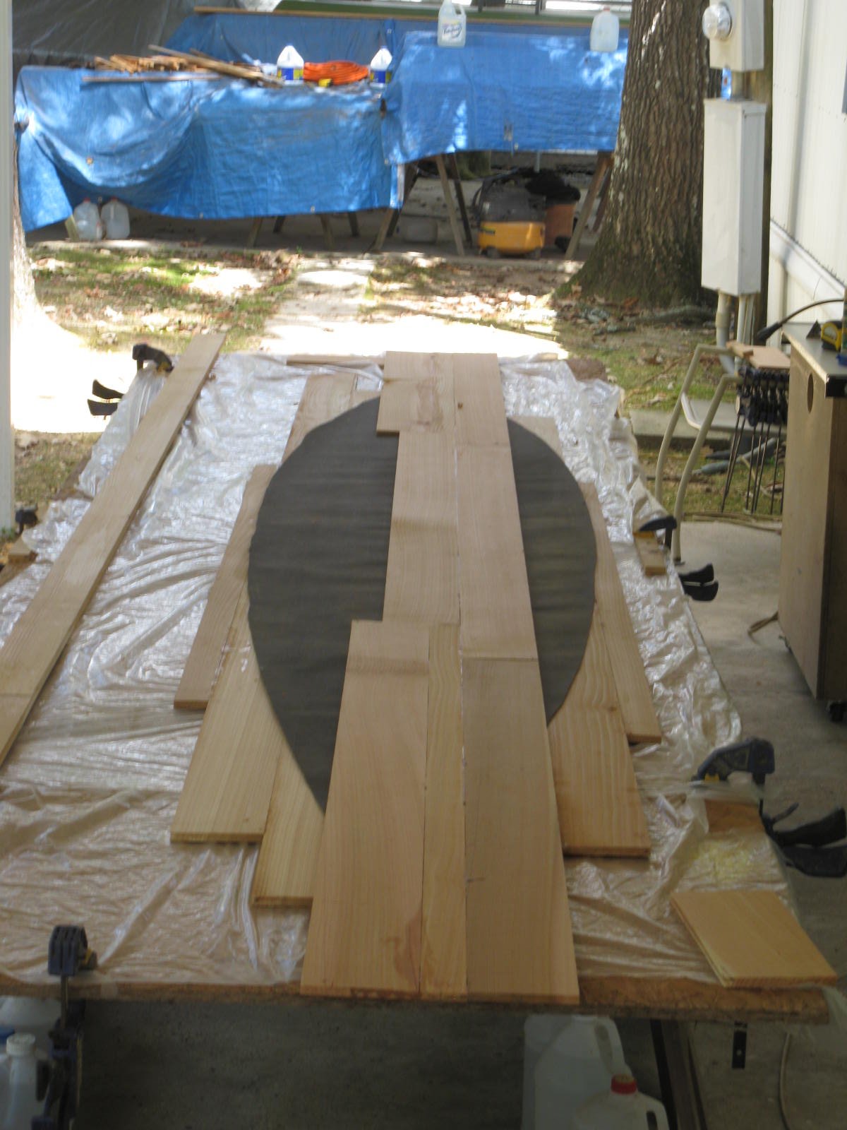

The "Plank " part may not be technically correct. More like "solid wood panel". I did not have any suitable planks so I am making/using shorter boards jointed and glued into panels. For sometime I have been buying any "clear/solid" cedar fence boards I ran across. There is some waste and more work and time involved to build this way.
Sized the boards to 1/2"thickness. Straightened the edges and cut them to the same width. I bought a tongue and groove router bit that will work on 3/8" to 5/8" thick boards. Helpful hint, it is easier to mill the groove and tongue joint into the 1/2" boards and then plane down to 3/8" than to mill 3/8" boards.
Boards glued into floor panel.
Pattern placed for the floor.

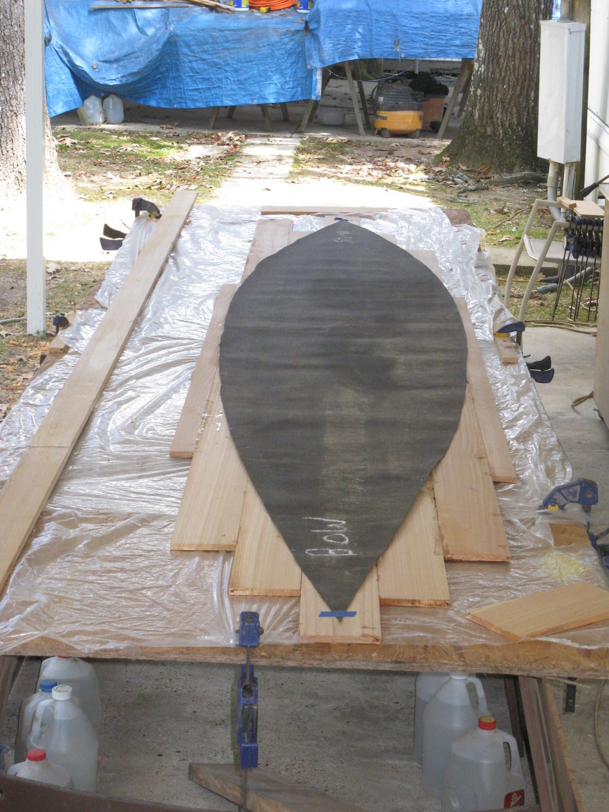

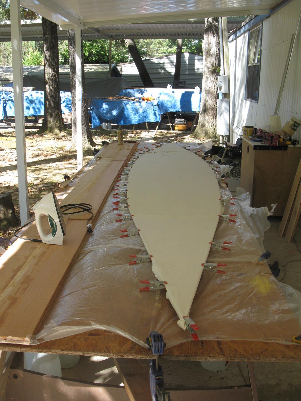

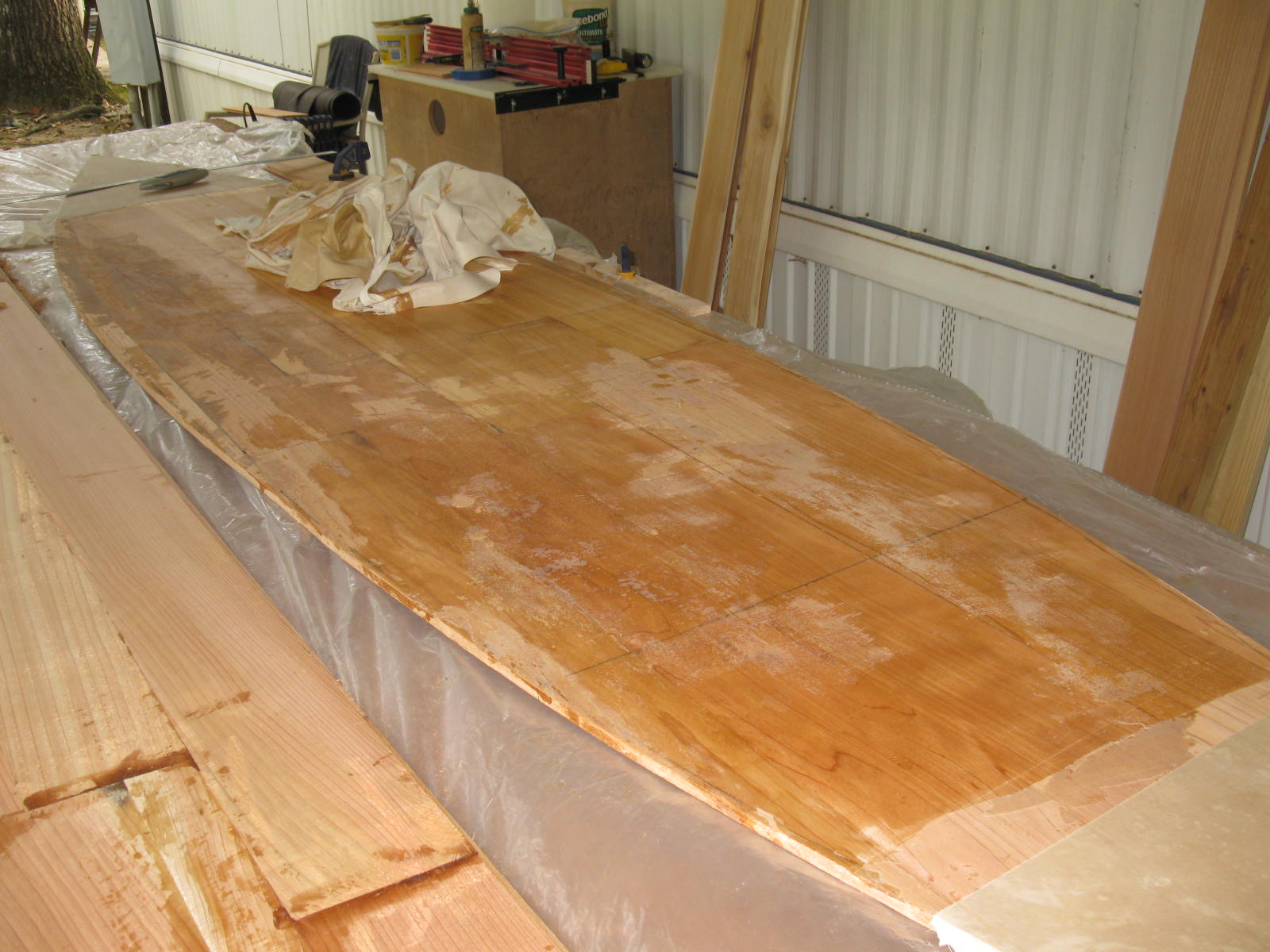

My photography is worse than my woodworking. The picture angle makes the floor look much wider than it is. Floor is 13' long X 26" wide(8" behind center). Marked the panel and cut it out, then stretched cotton fabric(bed sheet) over the floor. This will be the inside of the bottom.

Jack the boat bottom will be max. 26" wide with a side beam width of about 34". Wider than most kayaks but not as wide as most canoes. Probably about average for a full grown pirogue. When I posted the pictures I realized how wide the bottom appeared. Right now the floor is wider than it will finish out. After the chine logs are attached the wood will be planed flushed to the logs. The clamps also add to the illusion.

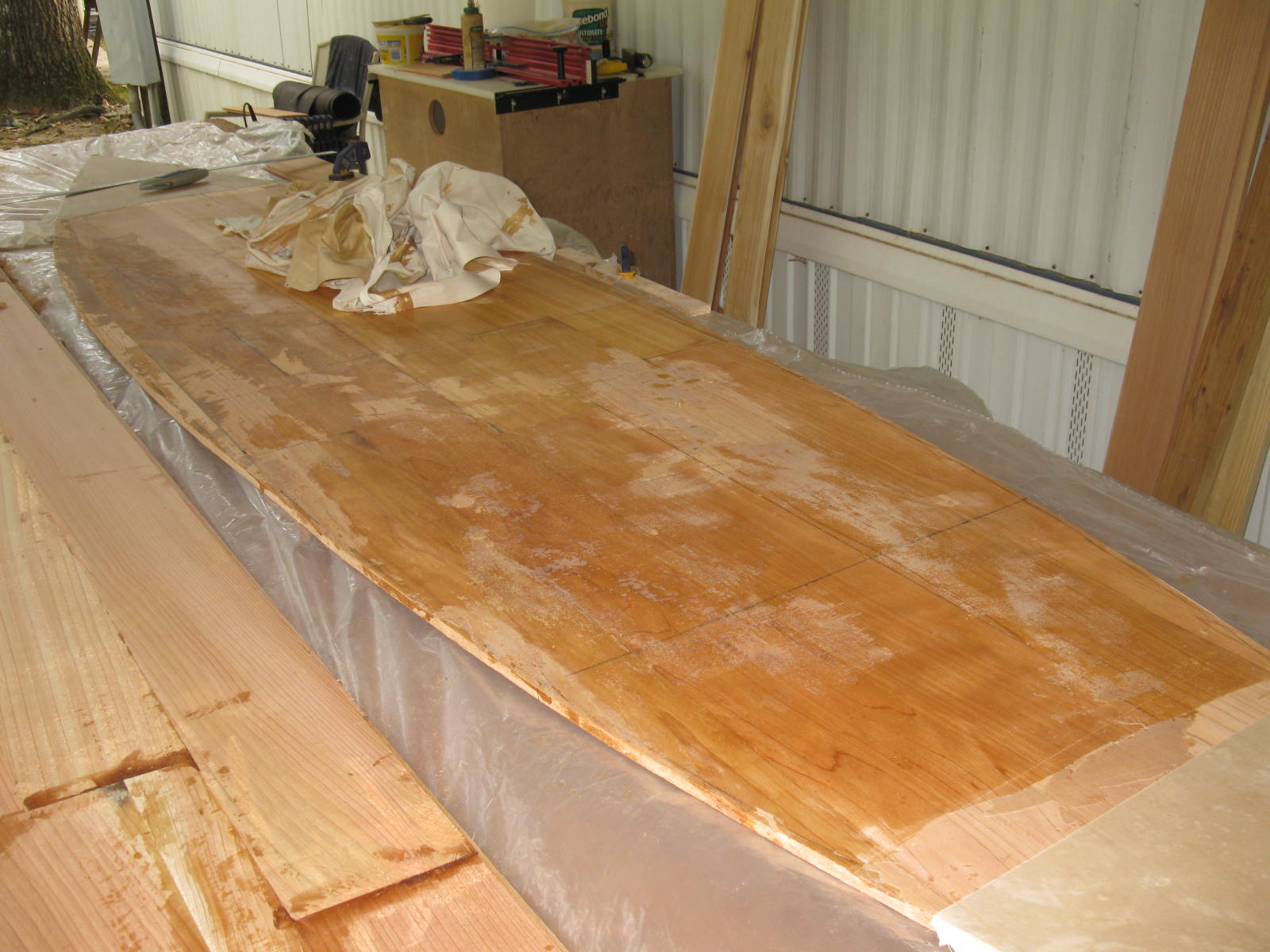

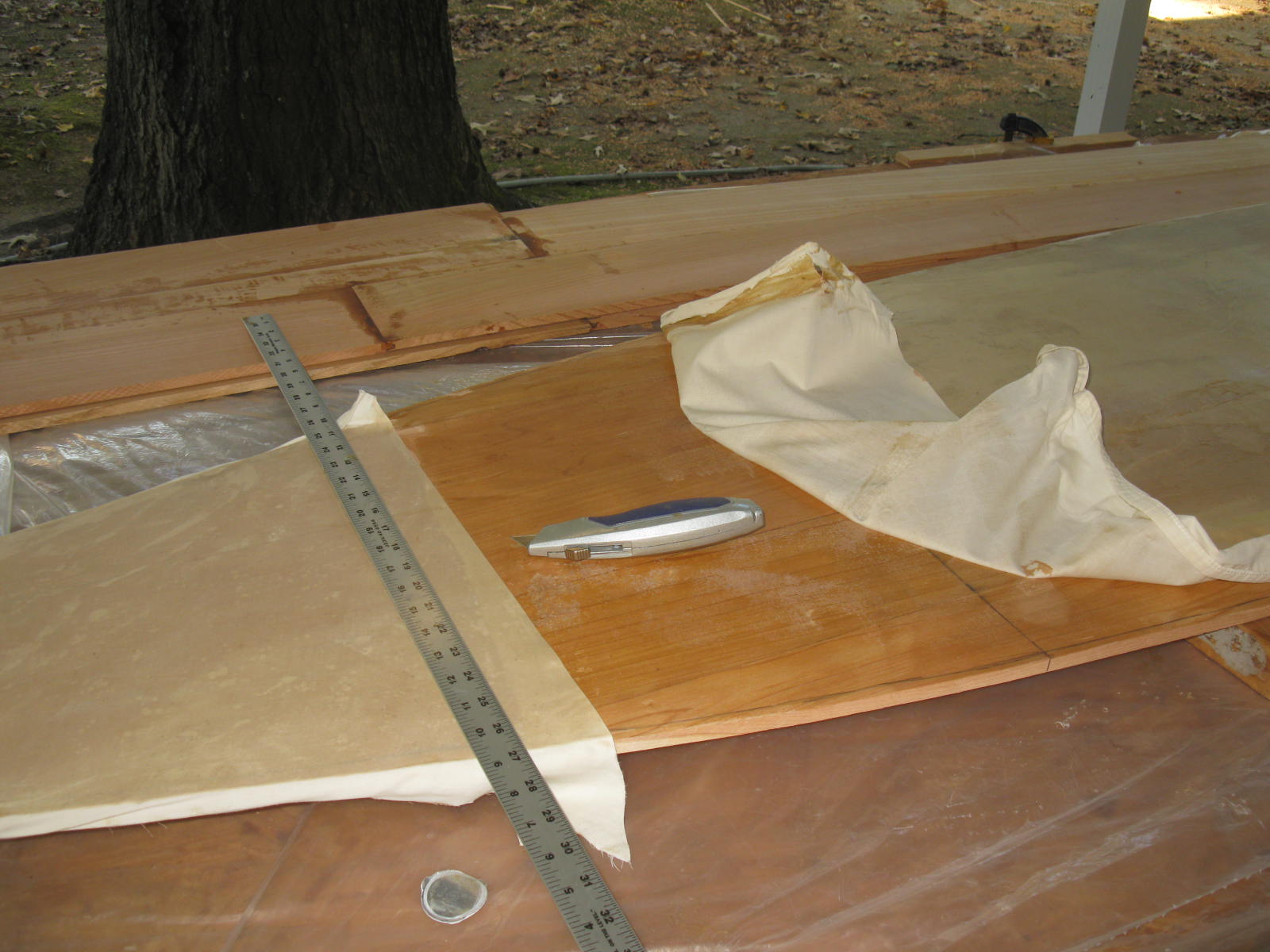

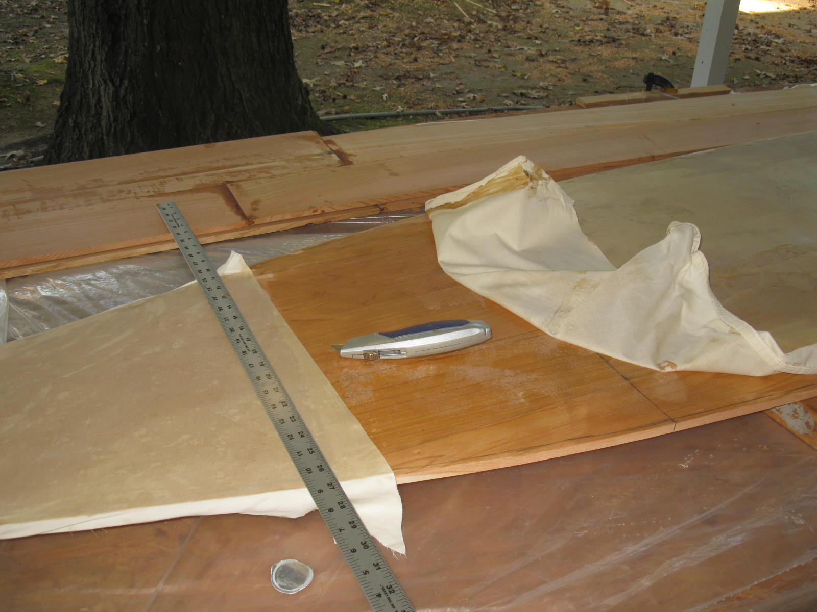

Poor man fiber glassing is different than epoxy fiber glassing. First learned(hard way) truth is Titebond 3 dries much quicker than epoxy. That is good and bad.
I removed the cloth and rolled on the glue and then repositioned the cloth. It did not hold. The roller did not apply enough glue, and it had began to dry before all the cloth could be laid down.:mad:
Had to cut out the unglued part and redo.

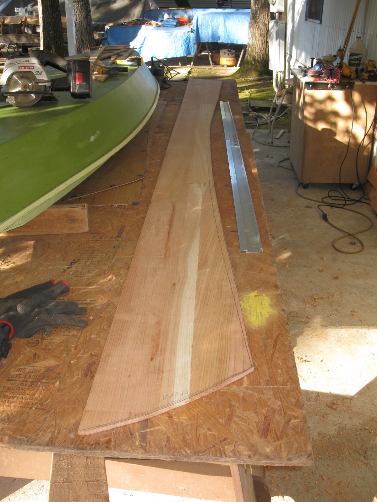

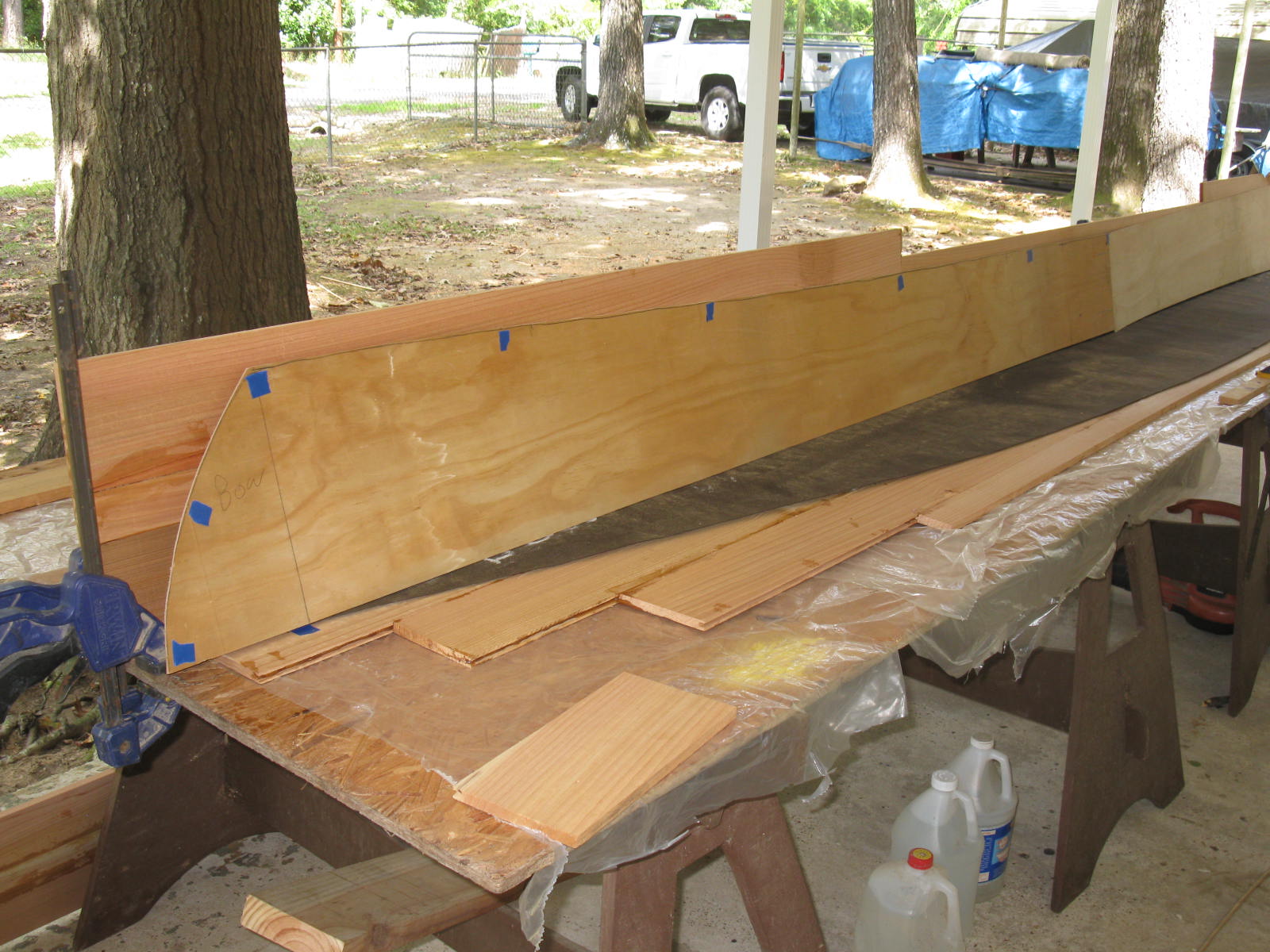

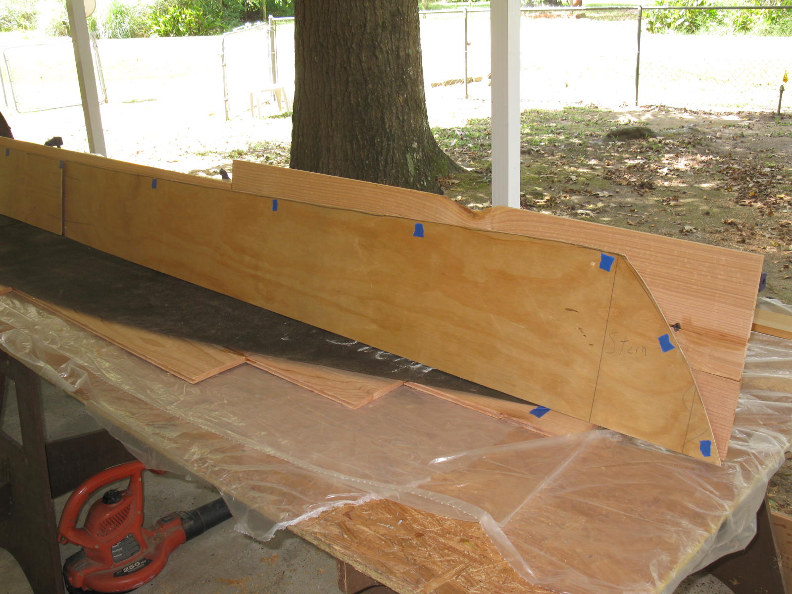

Tongue and groove 3/8" boards formed into side panels. Placed the side pattern onto them and traced outline of the sides. This is as far as I have progressed.

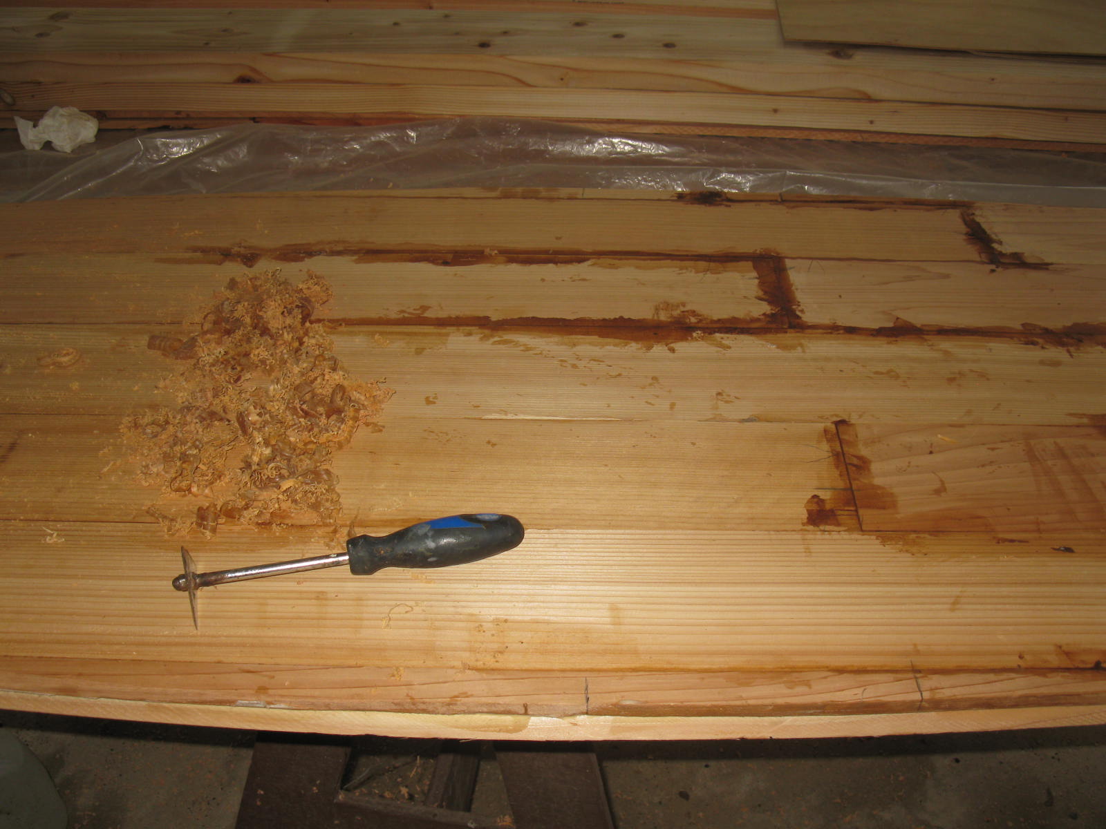

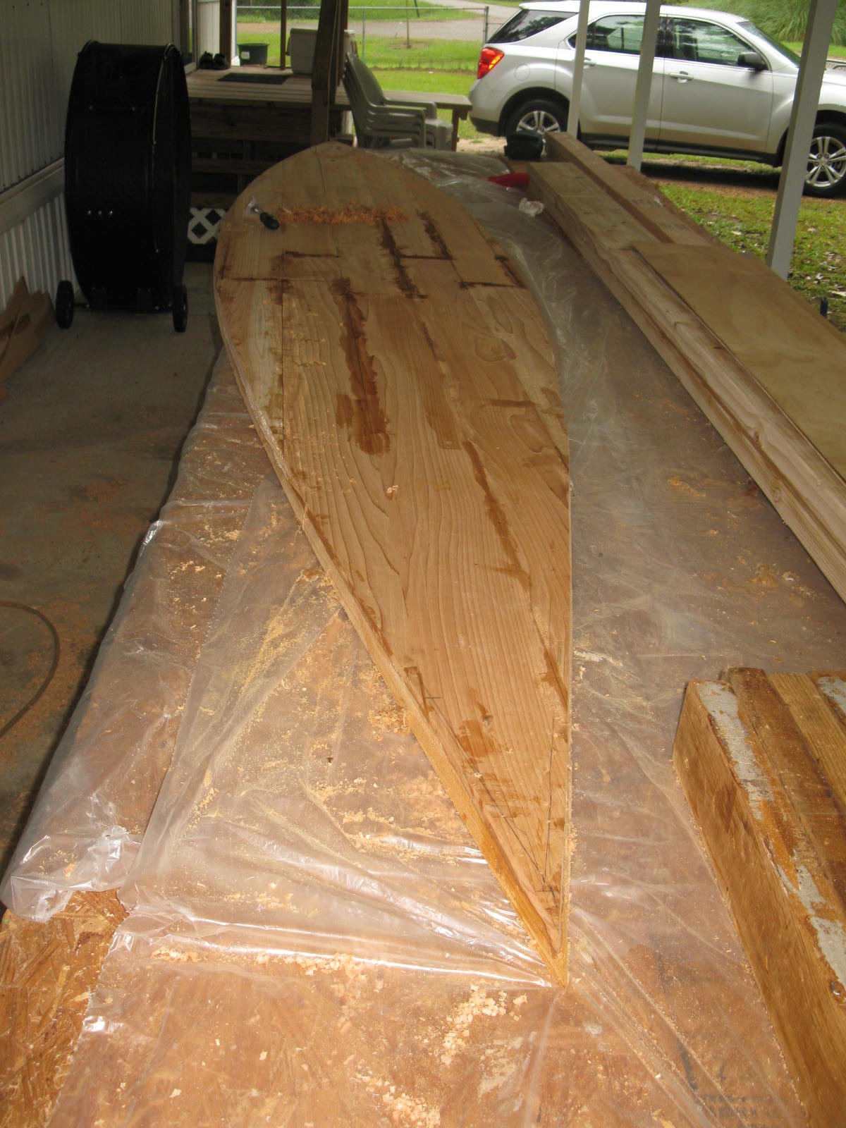

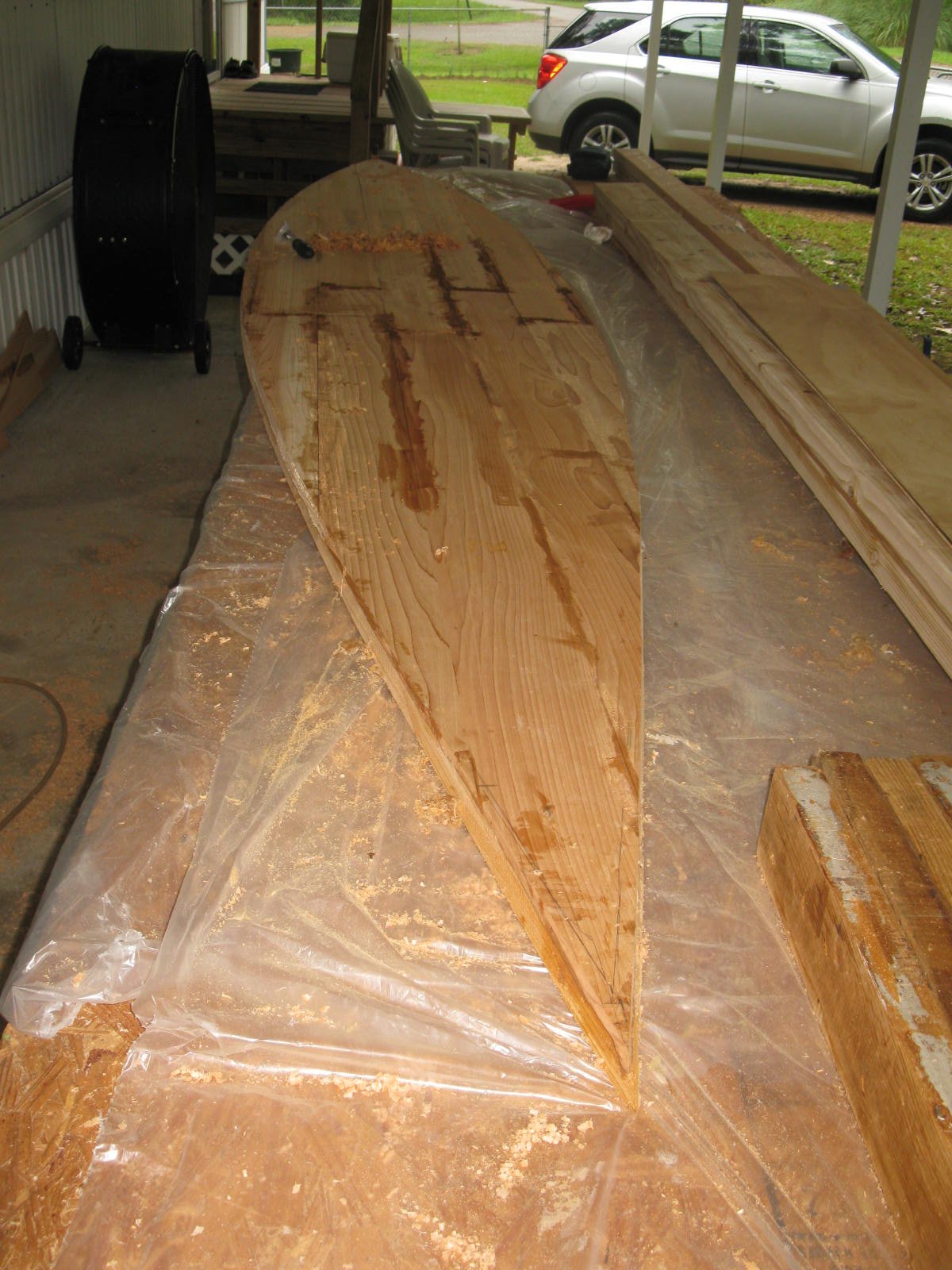

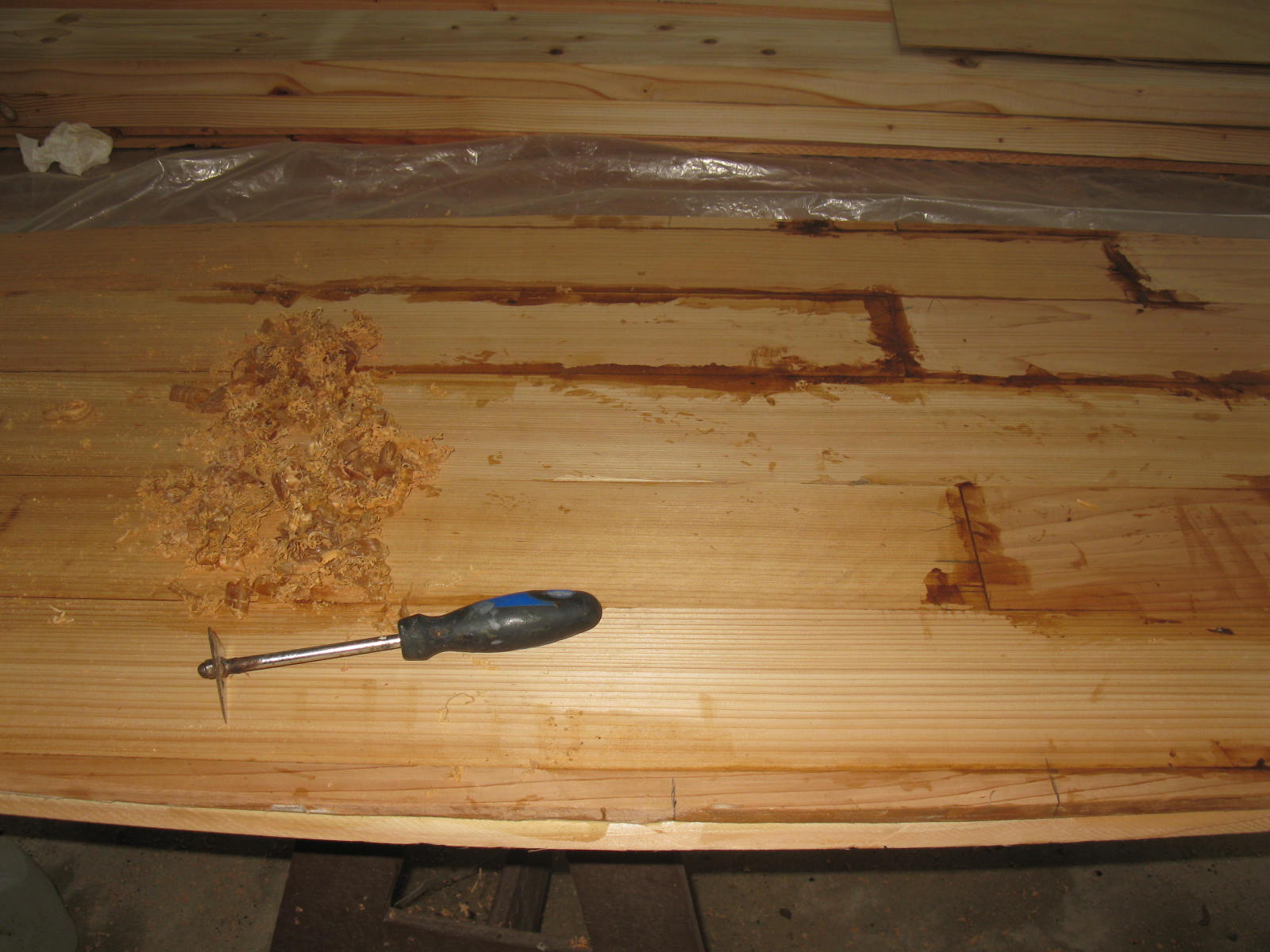

Had some interruptions but made some progress. Turned the bottom over and scraped the excess glue. The scraper works well for this. Faster than the sander but more "elbow grease".

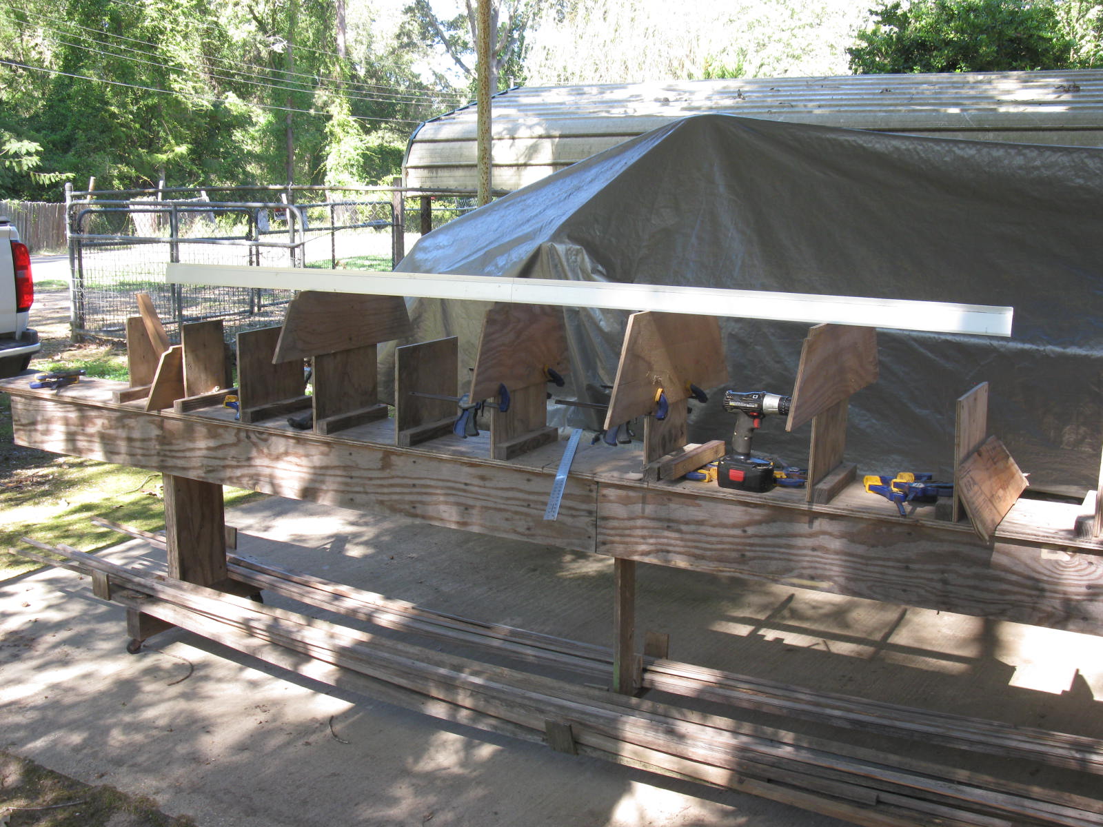

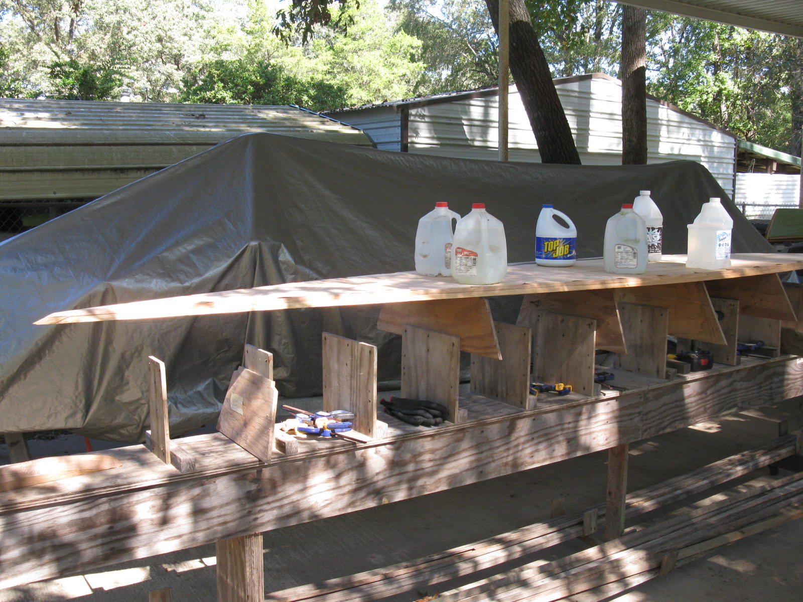

Set the support stations on the strongback.
Weighted the floor and set the rocker.
Cut the sides out and attached(no pictures) them to the floor and stems.

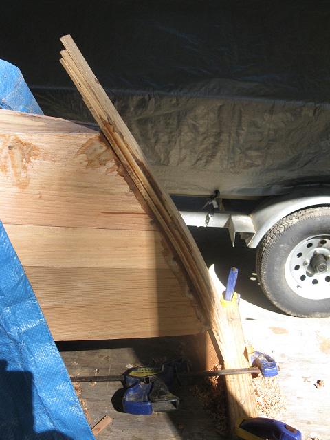

Laminated strips to make the curved batter boards. This is as far as I have progressed.
View attachment 1203View attachment 1204
