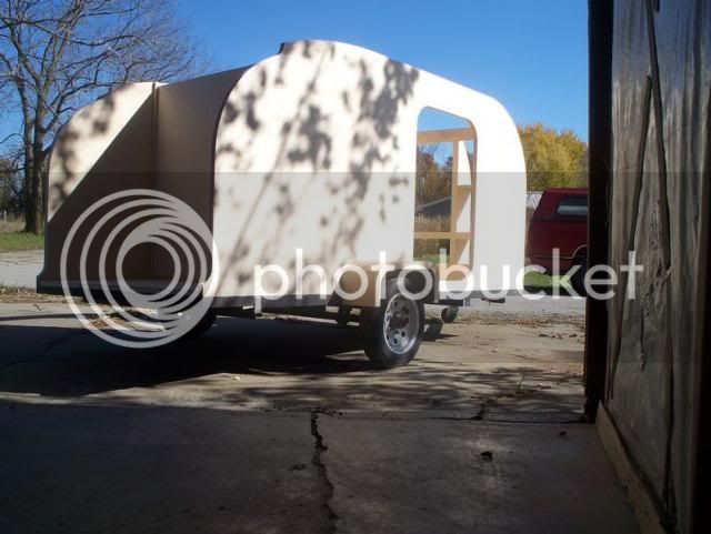

Well got the skin on the roof and back to the garage cause I've got to get back to building cabinets for new homes...This will be the 3rd house since I started this project....
Photo time...
The shop in the background....
Back in the garage..The frige. fits..
