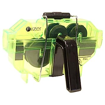

I use a Chain Scrubber like this one on the bikes...... It gets the top , bottom , in between and the sides of the chain.

That scrubber really cleans a chain when you run it threw there. The scrubber comes apart in the middle and you run the chain between the rollers which have bristles on them. Fill it with water and some Simple Green to the fill line. Close it up with the chain sandwiched in there between the rollers and using the crank run the chain threw it , I do several revolutions of the chain and if it is really dirty then a couple fill ups of the Simple Green and water mix. Then hose the chain off and let it dry , now use the dry lube and you are set. The dry lube is in a liquid which gets it down inside everything and then the liquid evaporates.

I like the chain cleaner, but will not knowingly let any soapy water near a roller chain. I'm going to buy one of the cleaners, but will use a hydrocarbon solvent (gasoline) to clean the chain. Even gasoline will take an hour oe two to completely evaporate out, but is not a problem if it doesn't.
If you put soapy water on a roller chain, it will penetrate into the roller-pin assembly. That won't dry in 15-20 minutes. Soap of any kind is a wetting agent, and lowers surface tension of the water. Most soaps are corrosive; probably the gallon of stuff he used isn't.
Thanks for the idea of the chain cleaner. That's a brand new idea for me. I'm ordering one.

No matter which cleaner you use you will like that Chain Scrubber , it is easy to use and does a great job of cleaning the chain.
It is an on going age old debate about chain cleaners for bicycles on the bike forums. The argument's cover everything from Simple Green ( appears to be the most popular cleaner ) to commercial Chain cleaners with Citrus based solvents , then the harsher chemical cleaners = , Gas , Kerosene , Brake cleaners , WD 40 , Transmission fluid ,Alcohol and on and on.
I like to finish the cleaning process with a liberal application of the Gold Link Lube. Here is one of the reasons as they say... " Does not build up or become tacky; sheds dirt, mud, and abrasives. Also repels moisture and prevents corrosion. "
I run the chain threw a couple application of it per side ( The inside ( left ) side of the chain and then the out side ( right ) by slowly back turning the peddles. :D
