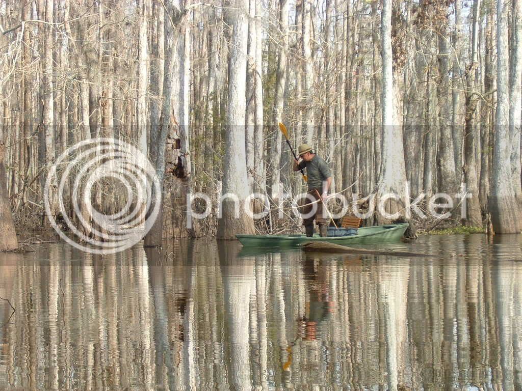

Lean on the carefully acquired knowledge of guys like Keith, Seedtick and Beekeeper, and Swampwood......and Chuck and Texas River Rat and Hairymick.....in fact about 100 of the guys here. As for me, i've built three UJs and had great luck with them. Here's a pic of my son standing in his UJ.

Islandpiper, I noticed the boat in the picture ,inwhich you are standing, is painted.Could let know what you used and how is holding up?
