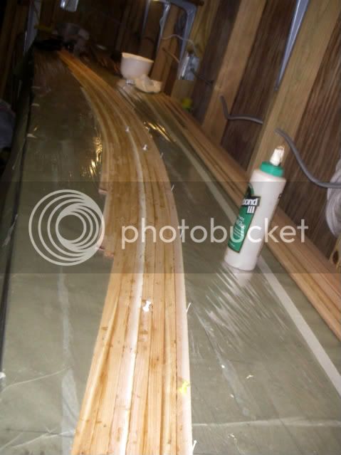

Prepareing to glass side. [ur
l][/url]
Wetted out [[img]http://i469.photobucket.com/a... go faster stripe to hide this, not sure yet.

Bentley will weigh when done and report. any way here's some delayed progress, back to the build after forced break. taped all inside seams then glassed exterior.
