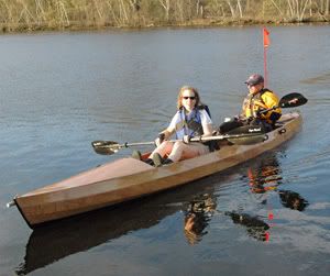

Matt designed a SOT ( Sit On Top ) for two people ........ It is 17feet x 33 inches.
If you are interested here is the link to the conception and the building of it , three pages all with good information and lots of pictures. Not sure about the camping part of it ( the amount of gear you take ) with the SOT but for fishing it is a good choice.

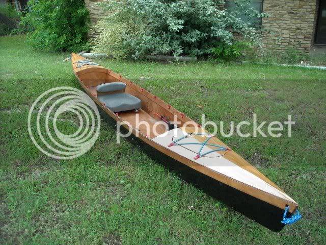

I wonder why a pirogue isnt "bay worthy"? is it the the flat bottom? im planning on building mine with water tight compartments (no hatches up top) just like the one in the pic, my buddy (not the pic) has totally flooded his and it still floated good. his had water tight comparments, and he always carrys a pump for it just in-case.
4+4
That looks like a boat from Gerald.
The flat bottom is rougher in waves than a multipanel,
I think most folks think of a perow as a open boat with no decks,the boat in the pic is a hybrid part canoe part kayak and part perow.

Its actually seashells boat, i fell in love with it and really like it, i know it will be rougher ride, just like a PB,
i guess at the beginning i should of posted a pic, i even hear pirogue, i think of a open boat.
