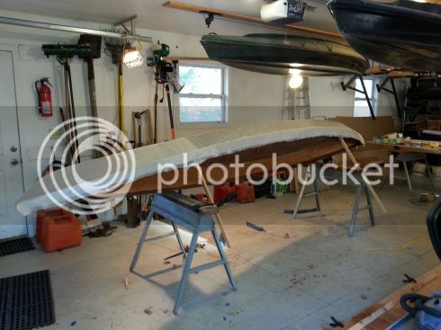

On the advice of several of you I glassed the outside in two sections, which worked great. I’ve always used 3.25 oz cloth before and like it well for light weight UJ’s. Again from reading post I decided to use 6 oz and discovered it’s easier to work with, uses a lot of resin, but appears much stronger.

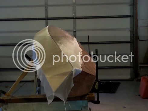

9 degrees outside so the ends pour with the tumble homes installed presented a challenge. I decided the rope handle could go in CPVC. I did a test in scrap of plywood, the wood stated to crack with a lot of pressure but the joint held good

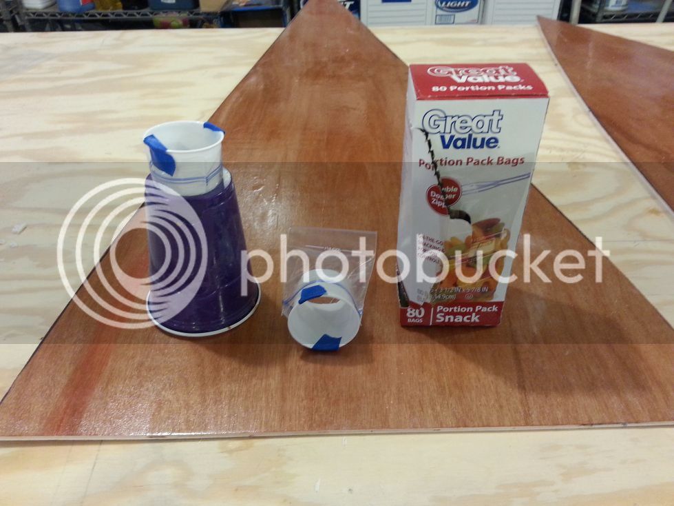

I thought I‘d share my method for fillets and glue joints, it works well for me. Small portion bags and small cups for a funnel all from Wal-Mart. I fill the bag by supporting in a hole in a solo cup. I also cut Popsicle sticks on the band saw and bevel the cut edge on the small belt sander and use them for smoothing fillets and cleaning up edges.

BUFF, end pours can easily be done with the boat horizontal. Use the thin cardboard from the back of a Big Chief tablet, and cut it in half crossways. Fold that in half, cut and fit it into the stem end. Form a Vee shaped cup with it, and tape it into place to hold thickened epoxy into the stem end.
After having regular epoxy leak out, I learned to use thickened epoxy first, to seal off the edge joints. Once those are sealed, you can then dump in odds an ends of remaining epoxy from work sessions.
