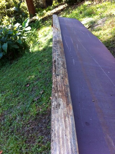

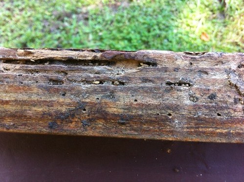

This is the offending rail. It looks like termite damage in various spots for about 19 inches or so. The pirogue is 14'6"

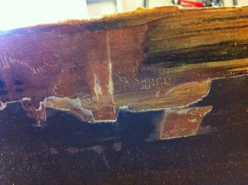

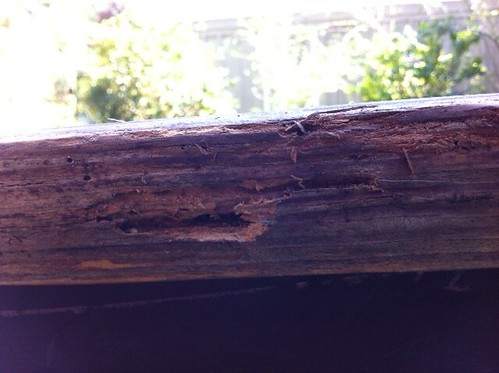

Some more damage
Some MORE damage...

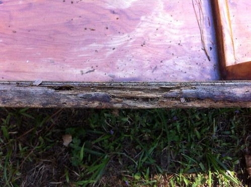

And HERE they are!

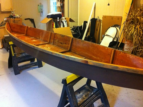

Ok, here goes nothing! We have started the transformation! Everyone wanted to help out.
On the operating table

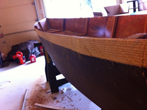

Most of the rail is removed. The rest I think I will remove with a planer.
Doesn't look like the termites made it past the rail into the plywood. I will check more on Monday.
