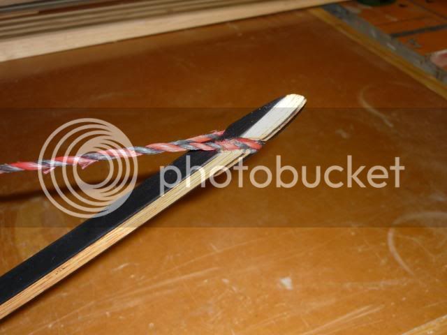

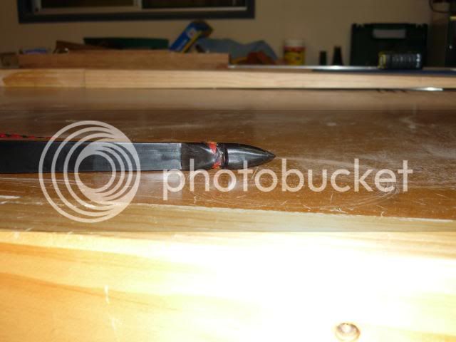

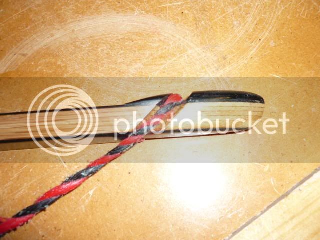

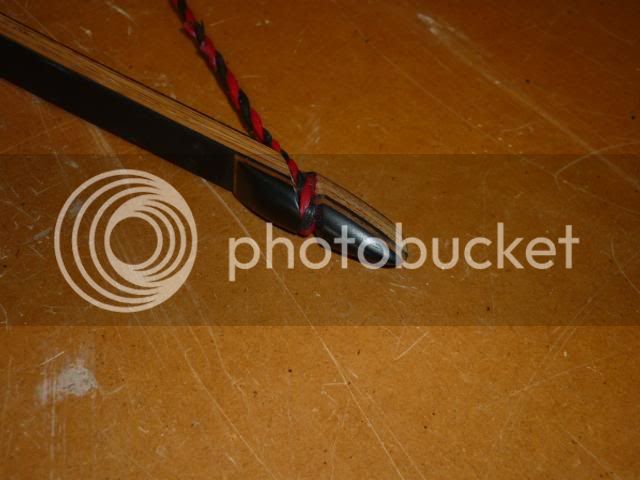

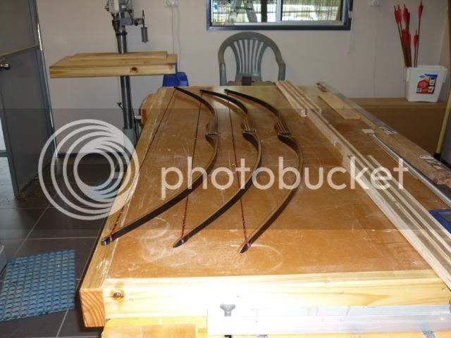

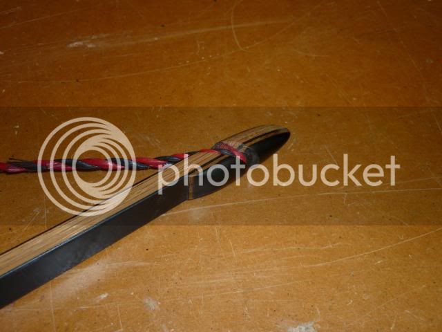

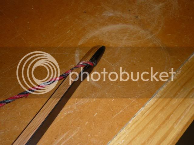

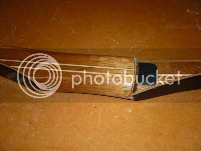

I've been a bit slack lately because I've been making bows and haven't taken the time to post them on the site , I meant to but I tend to spend most of my time in the workshop with one project or another when I'm home so posting to the site some times takes a back seat , but it's raining today and too wet for the work I had planed so here are some pics
All bows have Kwila risers and the laminations are coffee bamboo flooring , the tip overlays are Buffalo horn , one is a 32LB bow for my wife another is a 40lb bow and the third is a 45lb bow with all parallel laminations
The 45# bow come out best , I had a problem with my air hose dropping it's guts under the heat with the first two , had it fixed by the third , one of those things where the hose would hold pressure all night but loose it all with in half a hour under the heat , after the second bow the leak become worse and I could find and fix it
