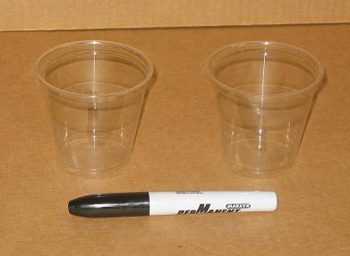

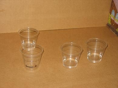

You'll need some clear plastic cups and a permanent marker.

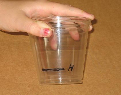

Place one cup inside another.
Decide how much total epoxy you want to mix at one time. In this example, we selected about 1/2 of the plastic cup.

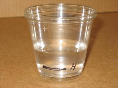

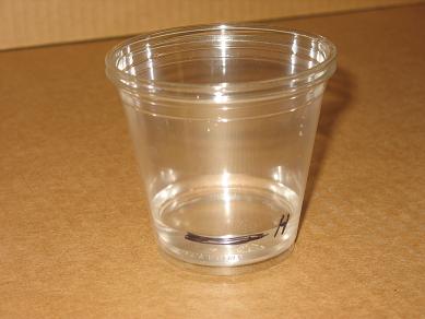

With the marker, draw a line on the outer cup. Label it "H" for Hardener.
For a 2:1 ratio, you have 3 total parts: 1 part Hardener and 2 parts Resin. So we marked our line about 1/3 up toward half the cup. If your epoxy is 3:1, then you'll have 4 total parts. Mark about 1/4 the way up.
In this next part, we use water. Much cheaper and easier to clean up if you make a mistake.
With an empty cup still inside the marked cup, fill to the marked line.

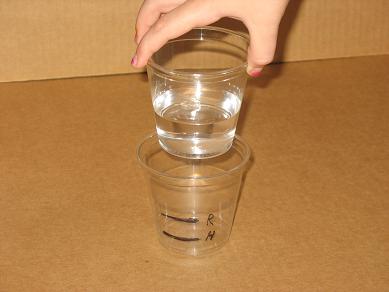

Remove the inner cup and set aside. Measure 2 more parts so you have a total of 3 equal parts.
Place a cup back inside the marked cup, and pour the 3 equal parts into the cup.

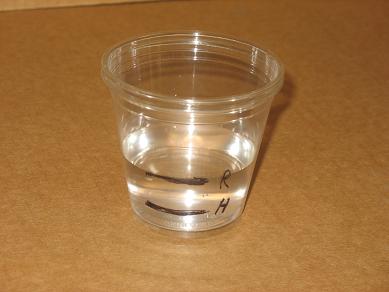

Mark another line on the cup and label it "R" for Resin.
So when your ready to mix, first fill the inner cup with Hardener up to line H, then fill with Resin to line R. Remove the inner cup and mix. Save the marked cup for the next batch.
