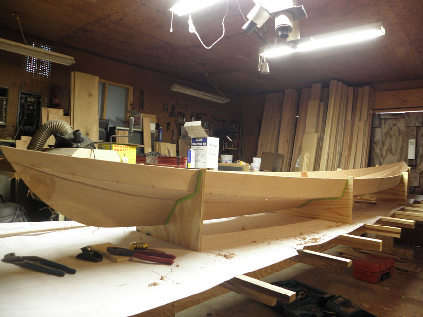

Finally finished cutting everything out.
Spliced the panels together and stiched the bottom halve together.
Ready to start gluing them together and fiberglassing before I start the top halve.

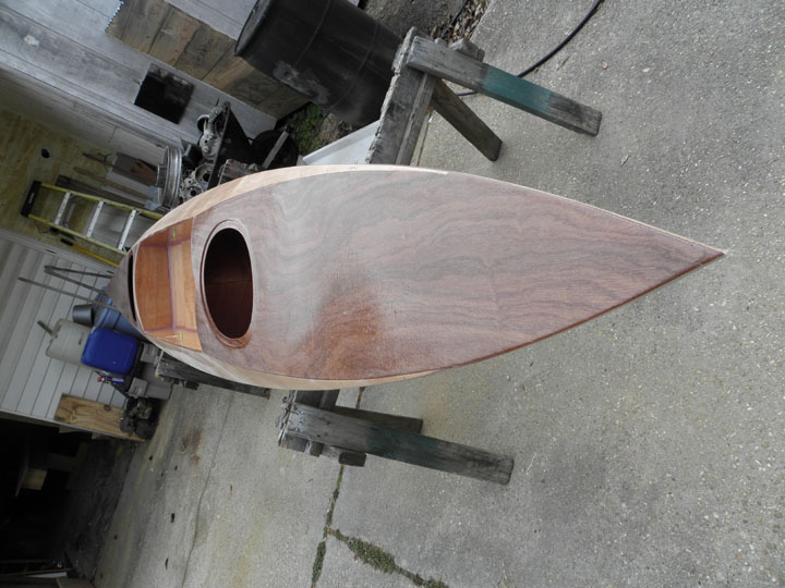

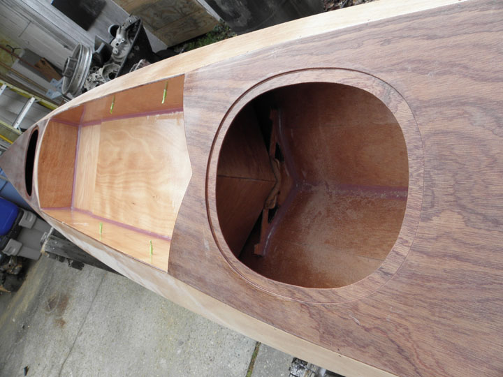

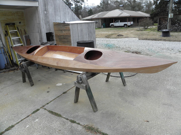

Updated pics

a Bald Cypress said:
You are going to need a "bow thruster" to turn that.
But, it sure looks fast and purtttty.
These kayaks are mainly used in the marshes and inland saltwater bays, where no other boats can get too the reds. They will take rougher water (waves).
