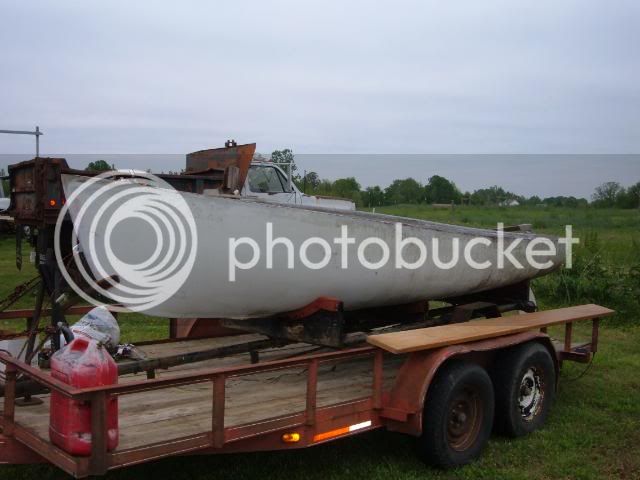

Here she is:

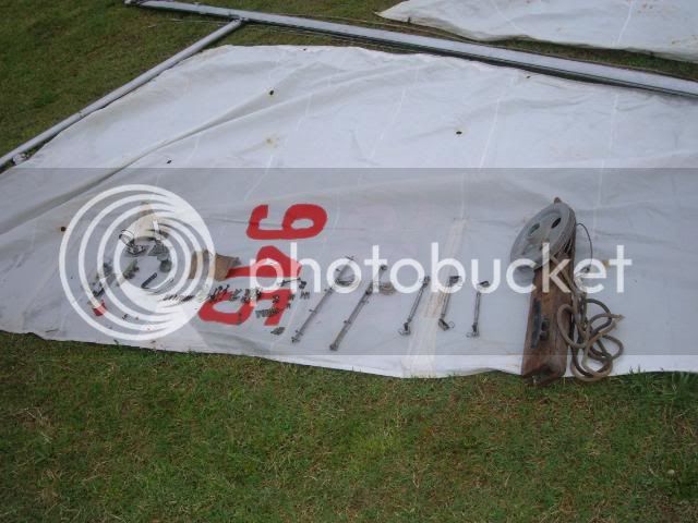

When Tommy said he had all the hardware, he wasn't kidding!

We got the first good inside wash down done, and got it winched down off the big trailer (too tired & too dark for pics right now). Inventoried parts & hardware, boxed & packed what we won't be meesing with real soon, and started planning how to get the boat up on some horses and overturned in the shop. (Thinking about building me some kind of jack-legged rotisserie :roll: )

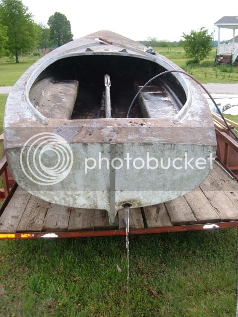

As Tommy showed me, someone tried to repair a delam in the port seat/floatation box by injecting some foam, but used expanding foam :!:
Tommy told me about his plans for repairing that, and I'm in total agreement: a "surgical" removal of the inner seat section, cut out the foam, then repair correctly while relaying the seat.
That one section is the ONLY thing other than cosmetic blemishes I can find - and Tommy went over the boat "stem-to-stern & gun'l'-to-gun'l'" with me before we ever loaded her up.

Don’t forget the idea of running a piece of about 2 or 3 inch glass tape all the way around to reinforce the deck to the sides, or run a fillet of long strand reinforced fiber glass resin from the inside under the deck where it meets the side. Making sure not to 'spooge' the locations where the hardware is to be mounted.
You don’t want to pop the deck loose when you roll her over for basting.
Check that seam line out. I think it is the only weak points. It may be fine and strong as is, but remember, when under sail, this is where all the stress will be applied from the mast. The other point of stress is on the center board trunk, and that is fine.
Keep us up to date, and get Karl a face shield and resporator mask for sanding on that fiber glass, don’t trust one of those paper ones.
Keep us up to date, and get Karl a face shield and respirator mask for sanding on that fiber glass, don’t trust one of those paper ones.
Yes, I haven't forgotten that. Thinking about doing both, actually - that is, if I can get inside well in all the crannies with 'her bottom-upwards. Karl was surprised at how well the inside cleaned up.

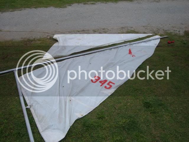

Sails are in the garage drying out.
