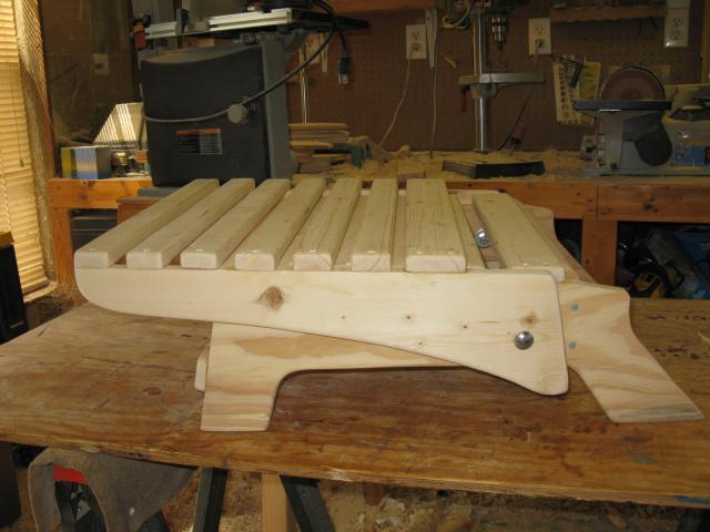

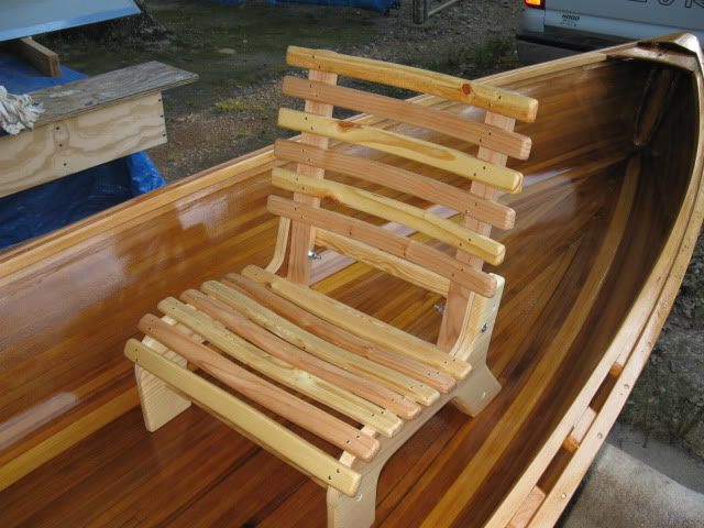

Forgive the crude work/looks. I put this together to build something different. If it works and I like it, it can be refined and spruced up.

That looks nice. I bought Chuck's plans from UJ, but can see blending yours and Chucks together in a hybrid. I haven't built Chuck's yet, but like the idea of his curved seat. Looks like yours might be a tad more comfy in the folded over position, with the runners below.
Did you screw the back slats on to prevent pushing the boards out when leaning back?
Thanks guys.

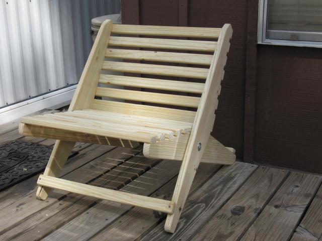

Chuck's pirogue is a great seat and I have built and modified several. This proto seat's functions and form were derived from a patio folding chair, and adapted to fit my use.
This seat is 8" high, 1.5" deeper, slopes only 1/2" to the rear, and not curved front to rear(future chairs will have curved slats). I like to sit higher, and the straighter seat places less pressure on the back of the legs. The curved seat works better in a normal sitting chair where the legs hang down. The back hinges to the seat base(no need for plywood backing) and it makes for a good strong fit of the back stacked onto the base if you wanted to sit on it in that configuration.
All slats were screwed and glued.

Actually it is not as wide as the original design. It is wider than Chuck's UJ seat.

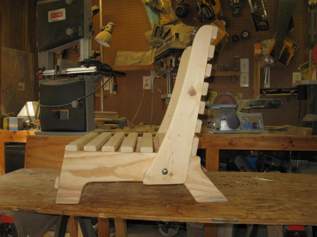

Most bought seats recline too much for me. I like to sit up straight so I make mine to fit me. I may have to make some adjustments on the next one, because I forgot to consider the lifevest.
Overall width of the seat is the same as my last UJ one.

It looks larger because the back side pieces are on the outside and the wood is not as refined. I hope to improve the next one.

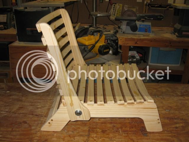

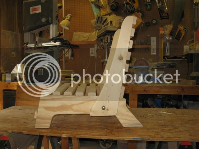

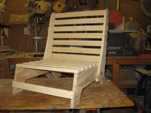

Evolution is a slow process. I finely made another seat with some minor changes from the first one. Looking at the finished seat I think I may have been to restrained in making the changes. Now I need to put in some fishing time to test it.

"Properly contoured" is what I was trying for. It fells right at the shop, but only time spent in the boat will say for sure.
For me too much contour in the sides of a low boat chair is not comfortable after a few hours. Maybe it is the height of my chairs, but only a little support under the thighs seems to work best. The seat slats are curved side to side the same as my other chairs, so I know they will be fine.

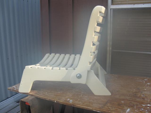

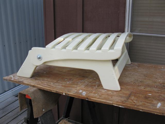

I put some contour in the sides, front to back and the seat is 1/2" lower in the back. You can see some differences in these two pictures.
Original proto chair:
Recent attempt before paint:
