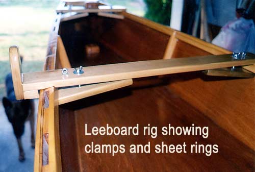

1. A 3" wide nylon band stretched from each edge, and down to an anchor point near the keel line. Maybe one anchor point, maybe two to get correct angles. These straps (experiment here) may be perpendicular to the keel line, or the top end may slope forward or aft of the low anchor point.
2. A thwart that temporarily clamps into place on the cockpit edges. (Chuck - show him how your sail rig clamps on, please?) This solid piece could then have braces affixed to it in a number of ways. I would make them adjustable for several reasons. Firstly, what may feel good sitting in the boat in the shop may get very tiresome on the water after several hours. Secondly, a change of position may relieve fatigue while under way.
Generally, I think (right now, anyway) that I would want them to be temporary and removable. I say that in the face of my policy of "no moving parts on my boats". Because, moving parts don't, and break-proof things do. But, you may want a clear boat with no obstructions for loading/ unloading a long pole or something. More likely, you may want to move your seating position.
Further, you may want to step a mast in this craft at some point. Small craft can be propelled so many ways! Single paddle, double paddle, sculling, poling, outboard, sail, .... My favorite is drifting.
Here is a picture of how I did it for a pirogue or canoe. You might be able to customise it for your use.

excellent advice, thank you. i really like the leeboard rig--just the ticket for me--that way it will be movable, for comfort and for when the wife paddles it, and it will be a start on my next project---sailing the canoe.
