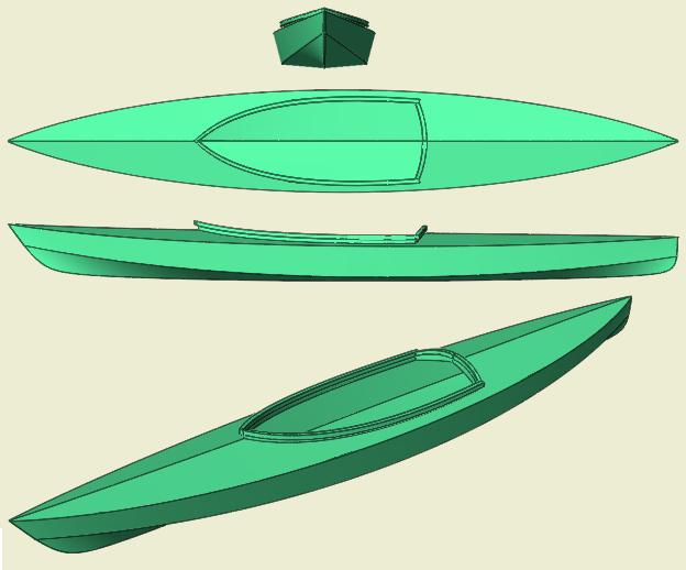

I have an idea...let me see if I can sketch something.
Here's what I've been tinkering with for some time.
14' x 26". Simple construction with 6 panels making up the hull
Slight V for tracking but will be stable and manuverable. Since the V is pretty flat, it helps with displament. This should be able to handle up to 250 pounds on board with no issue.
Cockpit is a recreation type opening. 20" x 56"
Were you thinking something like this?
new design
man, you are fast!! That's the boat, but I'd close up the cockpit, I really don't want my knees out all the time and would like some front deck to mount some hooks and rings and bungie cord, etc. Can you shorten up the hole? Otherwise looks good.

I don't mean to step in the middle of this, but I really like the lines of this boat Matt. I would like to see the cockpit closed up a little bit too. Would there be room for a watertight comparment or 2? Not a deal breaker, just curious. For ease of construction could the rear deck be made flat or the front deck be made out of a single piece of plywood and just arched over a couple of ribs? I am looking at the coaming around the cockpit and I assume it would be able to handle a spray skirt if the conditions called for it...? Please keep going on this one Matt, I really like where this yak is headed :D

Hmmm...I'll do some research. I can draw in whatever size. If you and Islandpiper could agree on a size, then we can just go with one.
I'm guessing about 28" long might be about right. Just depends on if you're looking to keep your knees covered.

I can't speak for islandpiper, but I would like to have my knees covered. I would install footrests in it and use my knees against the underside of the top deck for stability and control. The Chesapeake LT16 that I sat in made me nervous. First of all it was awfully narrow, which I thought I might end up tipping it and then as small as the opening was I thought I could easily get hung up in the tiny opening trying to get out in a hurry. I wish I would of measured the opening on that one. I looked on their website and they don't seem to publish that spec.

A little bird I know tells me the standrd CLC cockpit size is 17 x 32". So that leads me to think the 20" wide one I sketched would be about right. If I build one for me, mine would be 21". That snug kayak feeling just makes me nervous.
The shapes you see are so you can brace with your thigh and roll if needed and still be able to slide in and out.
